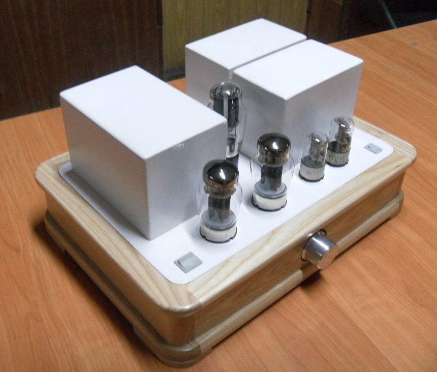

KT66 power tubes, 6SN7 or 6SL7 driver. With different drivers have different sensitivities and different sound.
At first I just wanted to see if I could get any amount of sound out of this set-up. The circuit is a simple 12au7 up front, one triode as first audio, and then the second as a phase inversion driving a 12au7 push pull. The OPT that I used has 34k p to p and 8 ohm on the secondary. All PS caps were bypassed by 1mfd pp. The PS employed was a junkbox PT 136v and then I made a voltage doubler to step things up.
Like I mentioned in the title it was built as a joke, but turned out well for it's power capability. Here it is on the bread-board... I am not sure if I will be building this in stereo yet, as there are better things to do. I did not build from a schematic, so if you would like to try this, give me a little time to draw one up.
