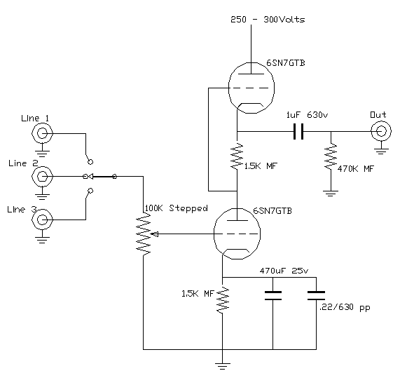

This schematic is the same design, but with a few tweaks.
Is this the driver stage to your twin EL34 SE amp in an earlier post. I like the 6SN7 and understand they were developed for radar in the 1940s. I have a few different types. I have also never used them in the totem pole config. you show here. Though I know a few well known builds who do use them this way.
Other driver tubes that I have used and work well are the 6N1P and of course the 12AX7. I chose the 6SN7 for the 300B amp I'm currently building.
1. How does a parallel SE compare with a PP-triode mode (given that a PP would require a phase splitter stage too). I would assume the Parallel SE requires a much larger OPT. 6L6, What OPT did you use. (both the PP-triode and the Parallel SE deliver about 15W/rms).
2. Does the 6SN7 driver stage provide enough gain? If one needs more gain can a 6SL7 be used instead?
