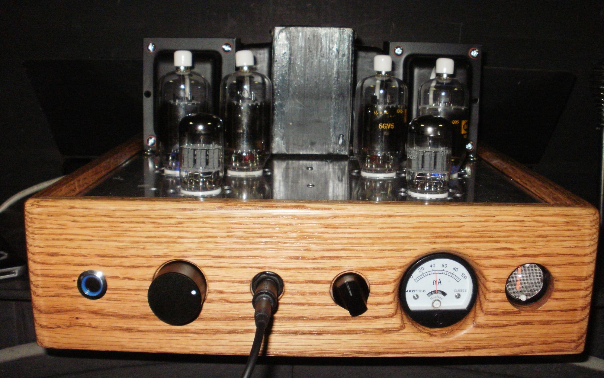

Wow thats pretty unique design ! love it !
Tubemaniac: What are you using for a power switch/button? Is it stainless & illuminated?
Buttons are vandalism proof ones. Still cheap ones but they are nice !
wow.. what are those pre tubes ? seems like they have three triodes ?! and what is that round thing in the right ? Nixie channel indicator ?
Compactron Triple Triode for input stage and LTP, Compactron Sweep Tubes hooked up as triodes, so a Complete Compact Compactron Triod Amp...... with a nixie tube displaying the tube selected for the amp meter..... select 1-4, 0 or nothing also. I was lazy and did not want to have to engrave or put a decal on for the switch position , thought it might look tacky..

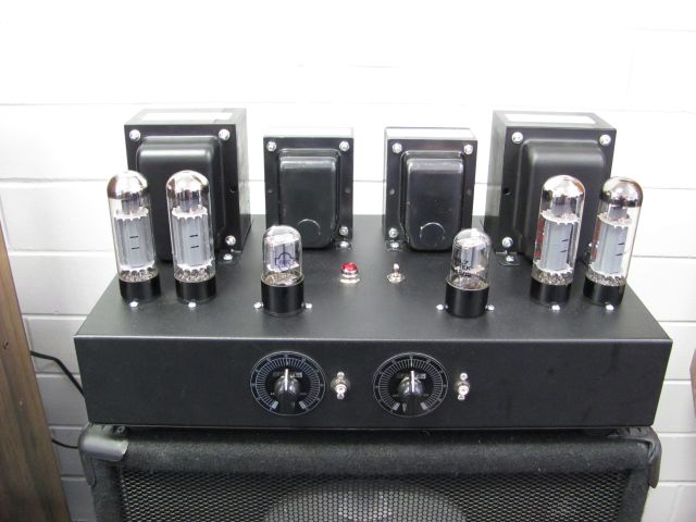

EL34 single ended parallel ultra linear 15 Watts per channel < .1 % THD at 15 Watts 1 KHz. Built from scratch at my shop. The ghoul here was to build an all tube amplifier with as good of specs as possible, using modern components but keeping to a traditional design scheme. I spent 9 months designing and building this amplifier and it was worth every bit of the time spent. This amplifier running a pair of the small Advent speakers sounds incredible. The dynamic range is like nothing else I have ever hired. But then I built the amp... so not trying to be partial. This amplifier will not win any beauty contests, but it sure is perty to me. Bernie

Can you post a finished and final schematic. I have a quad match of Mullard EL34s new issue. This amp could be the one to build.

Are those chokes and output transformers having same orientation?
I have never had an issue with shielded transformers.
The transformers are double shielded and are not causing any interaction.
It sure looks nice becuase it looks so un-cluttered. What input tube did you use?
