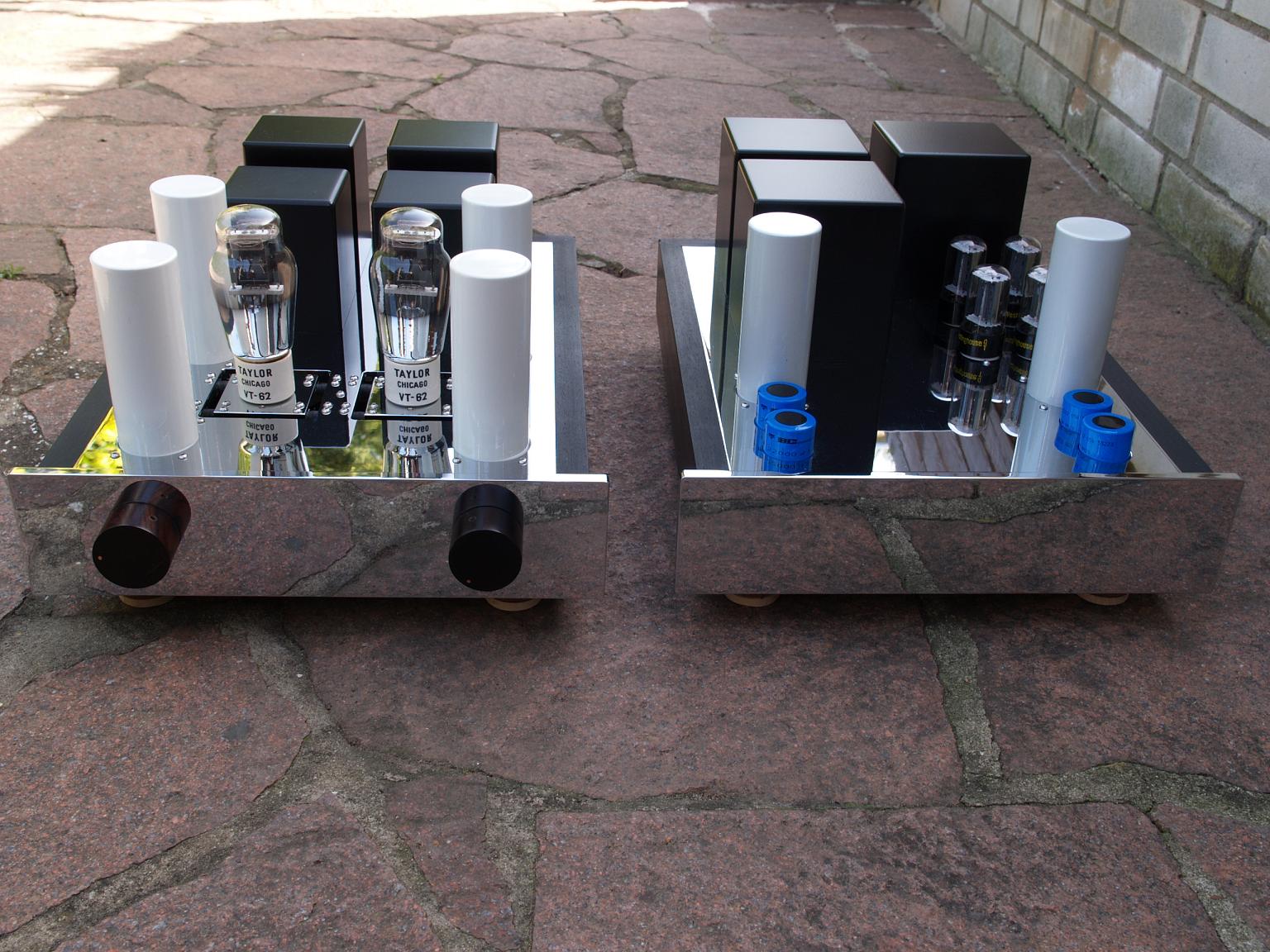

Hi all
finished an cost no object DHT linestage fro use 26 and 801/VT25 triodes.
regards Tony
Looks very nice!
Do you have more details to spare?

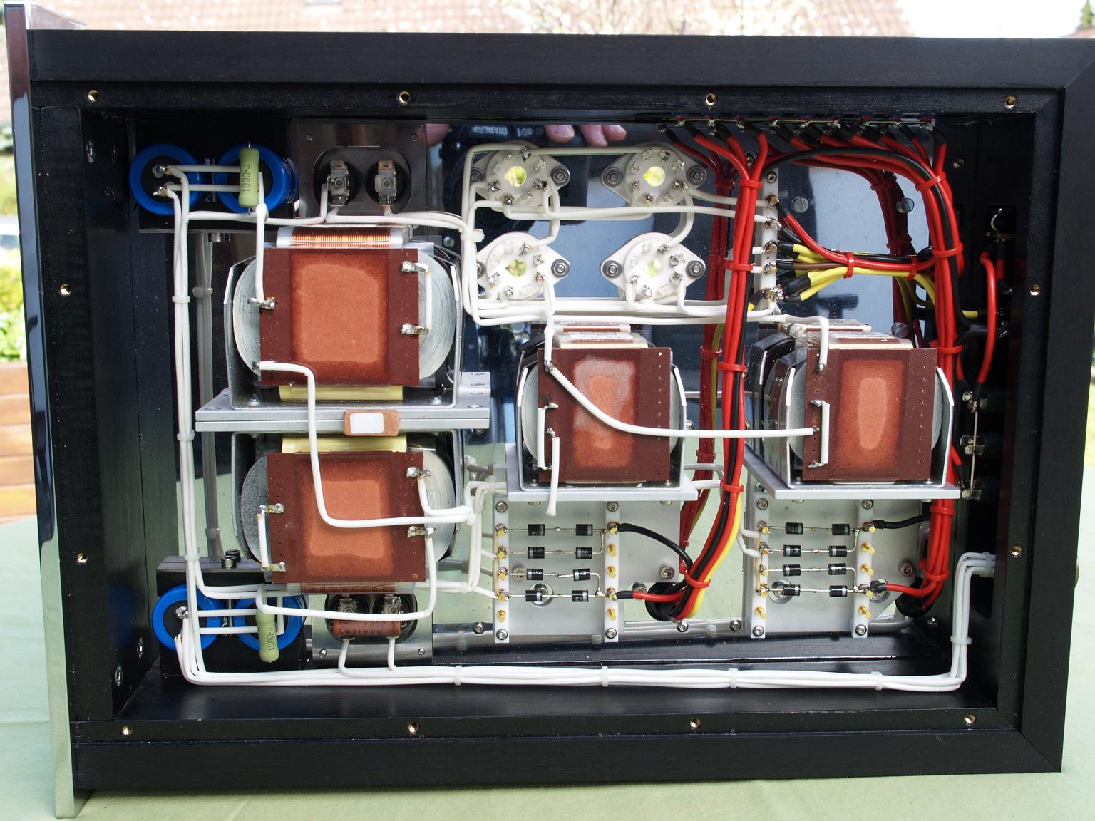

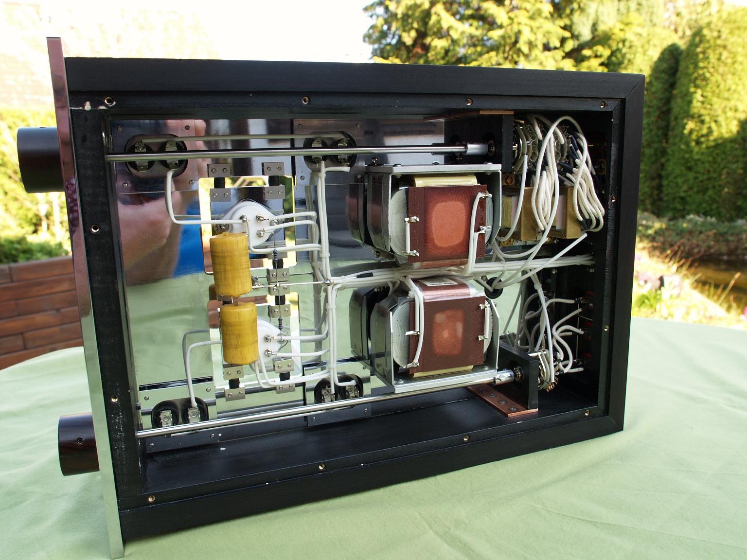

Hi Vgeorge
Supply works with 6AX4 graetz bridge, the hv are LCLCLC the filaments LCL,
1 transformer for HV and 2 for filament.Linestage works with tube in input followed by an LL1660 in 4:1 and followed by an low impedance Slagle TVC in output.B+ and filament are switchable for use of different tubes.Use of ultrapath capacitor between cathode and interstage.The circuit is an design of Thomas Mayer aka Vinylsavor.The cathode resistor is very special, an bifilar wound resistor wire on wood core and dipped in molten beeswax😀.
regards Tony

Thanks Tony!
I was trying to understand if it was a resistor or capacitor. I made someting similar for the 26 tube, but with battery bias.
What value is your cathode resistor? You use the same value for 801 and 26?
DHT Linestage
Hi Vgeorge
Value of the cathode resistor is 1,5K, 801 runs with 350V and 26 with 190V
regards Tony

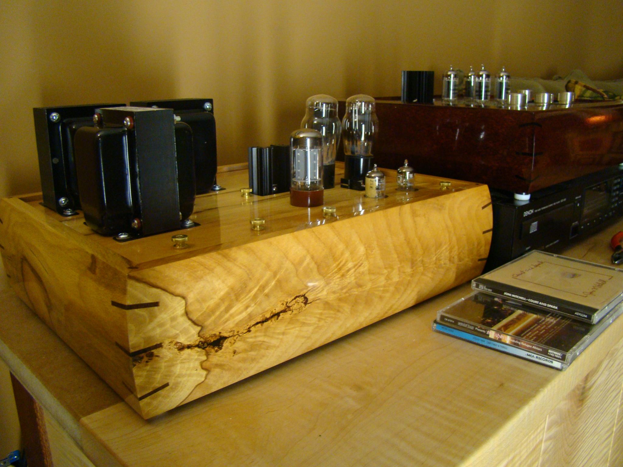

Thanks cassiel, since I do woodworking for money it's not often I get to make pretty stuff for our house, but in this case I couldn't resist.
Hi all
regards Tony
Excellent work. What are the white caps - motor start? and the yellow one under the bonnet?
Good woodwork. How does the amp sound?here is my version of a tubelab SE.
I guess that is the real question. It sounds great. The imaging and detail are all I expected and more. Also very quiet. Only drawback is it doesen't play super loud. I guess I have some ss amps if I want loud.....Evan
