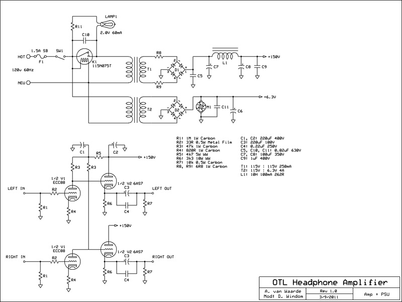

This is my take on the Van Waarde 6DJ8+6AS7 OTL headphone amplifier project. It uses my own non-regulated solid-state supply with a thermal relay to delay full B+ for a minute or so. A small lamp seen in front of the relay turns off when the amp is fully preheated -- sort of like the lamp on an oven.

Share the schematic?
Sure, here it is as I've built it. I am by no means an expert on this stuff yet, so if anything looks silly that would be why. 🙂
The amplifier itself is pretty much unchanged, other than some slight value substitutions based on what was available. The B+ supply is also similar, other than using a bridge rectifier I had on hand and a delay on the primary side.
I chose not to regulate the heater supply (and I don't even have the big filter cap on it right now, either) but it sounds fine to me; at least better than anything I've heard so far.
Of course a bit of B+ appears at the start due to current through the preheat lamp, but not all the way until the relay closes.

Two things I note here is: 6AS7(s) have extremely low plate impedance to start with and it is a cathode follower. Both of these factors mean low output impedance. I like.Sure, here it is as I've built it. I am by no means an expert on this stuff yet, so if anything looks silly that would be why. 🙂

Have you varied the orginal schematic?
I've been considering building a version for my 'phones, but with possibly ccs loading for both tubes, pentodes or mosfets possibly. How transparent would yo say the amp is?
