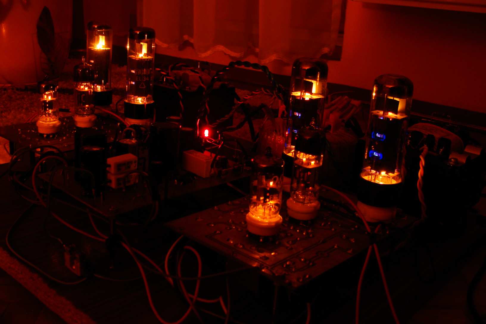

My 1st tube amp - still under construction but main electronic parts of the project already finished ~1month ago.
Already working:
1. amplifier (4x EL34, 2x ECC82, 2x 6N6P),fixed bias, voltage stabilisators for 285V, 420V, -60V and 6,3V (with slow voltage increase function). Delay for HV.
2. tone control +/- 6dB, 2 points with relay to switch off (goal for next winter to prepare tube preamplifier with tone cntrol and HI END DAC)
3. remote control for ALPS potentiometer and on/off for hole amp.
Under construction
1. VU meter based on 2xEM84 (PCBs already done)
2. chassis (AL + INOX + GLASS = modern look)
Sound? Incredible... It's pupming to Jamo S606 speakers to 25sqm room.

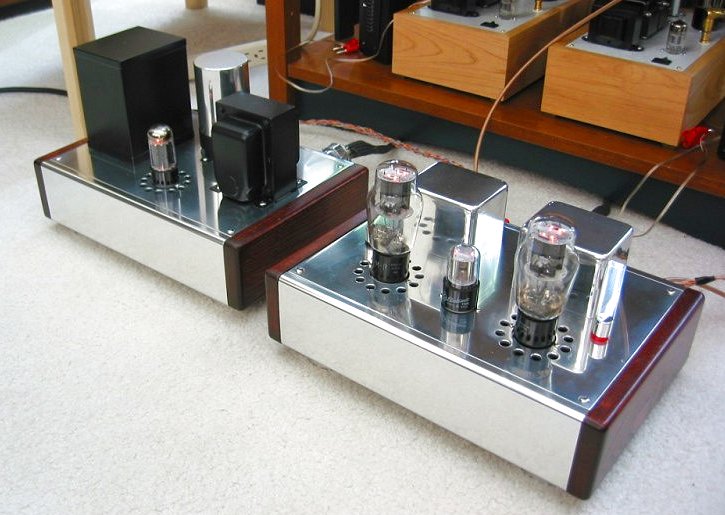

GM100 Stereo
I thought of using an OFF led in my new project
A GM100 SE STEREO amp.
You can definitely see when it's on.
At 17V 20A
Will take some time, doing the scematics.
I'll go for 40W SE or so
The RS607 looks like a little baby...

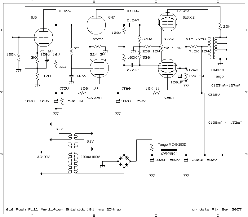

Can have a glance on the schematic please (driver ECC82/6N6P especially)?
Sure - project described on this site: Gegentakt-Verstärker in AB-Betrieb für EL34 / 6L6GC
Orginal schematic
http://www.jogis-roehrenbude.de/Leserbriefe/Roessler-Amp/Schaltung-ES.gif
Canceled VB408, I did stabilisator by use IRFP820 and Zener diodes (similar like for the EL34 Anodes).
