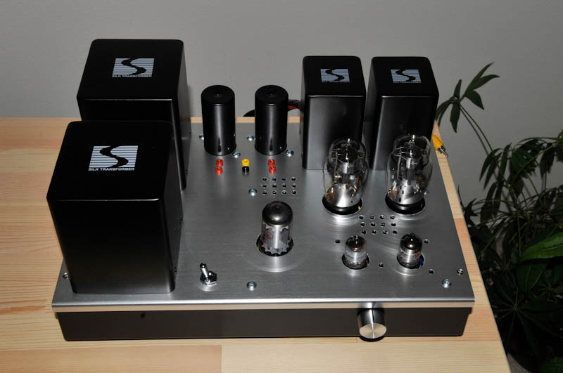

Tubelab 45

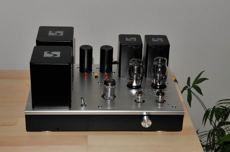

This is a TubelabSE for 45 and 2A3.
Iron is from Silk and it has the possibility to check and adjust bias without opening the chassis.

The idea is to use it with the microFonken, but up to now I only had the possibility to connect it to the Sonus Faber Grand Piano. It sound good, but not loud for sure.

Sonus Faber Grand Piano.........
...if you want to drive them very good,you need a "welding machine amp" for those.
In case you don't want biamping for your sistem you should try on your local guys to experiment on Maxonic speakers or similar or...a very good back loaded horn type enclosure (Fertin-fullrange speaker or FS speakers).

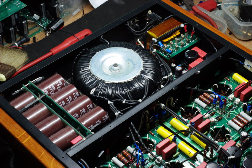

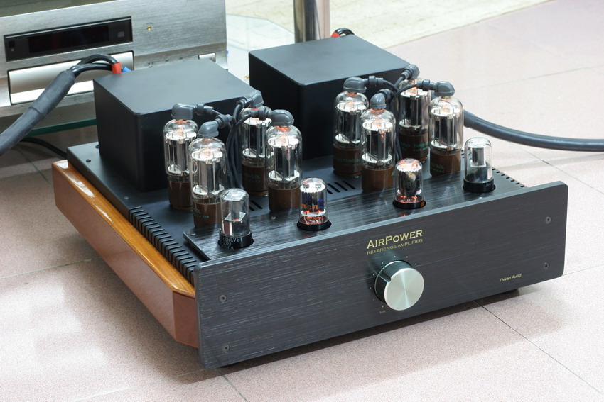

My reference Amp, It drive the JBL 4344 very easily. I'm must used 16 caps 560uF/450V in power supply for bass enought strong at full Power output.
Specifications:
- Vacuum Tube Complement:
8 x 3D21WB, 2 x 12SL7 , 2 x 6BX7
- Output Power 90 Wrms (4 Ohms)
10 Hz – 50 kHz ± 3dB (at full power)
- Class of output operation: AB1
- Input Sensitivity / Impedance: 1V / 100K Ohms
- Dimensions W x D x H: 42 x 42 x 21 cm
- Weight per unit: 36 Kg

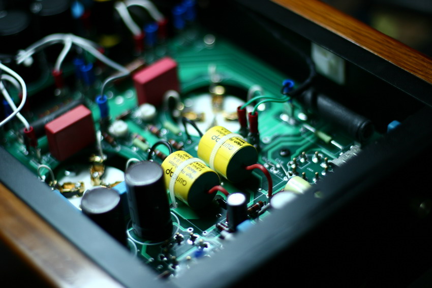

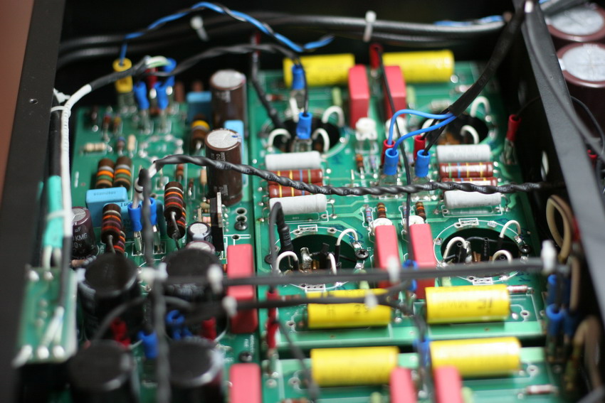

Air Power -- WOW -- very special workmanship.
I presume that you designed the board. That alone is a lot of work.
I'm with this guy. Knockout amp. Makes my SETs look like toys.Air Power -- WOW -- very special workmanship.I presume that you designed the board. That alone is a lot of work.

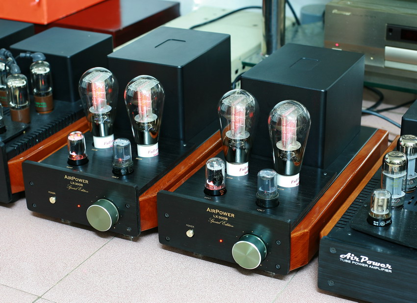

Good professional design. I like it.
The main planes of the plates of the 2 output tubes are facing each other, so their radiating heat would be baking each other.
However I don't know how much it'd be an issue practically.

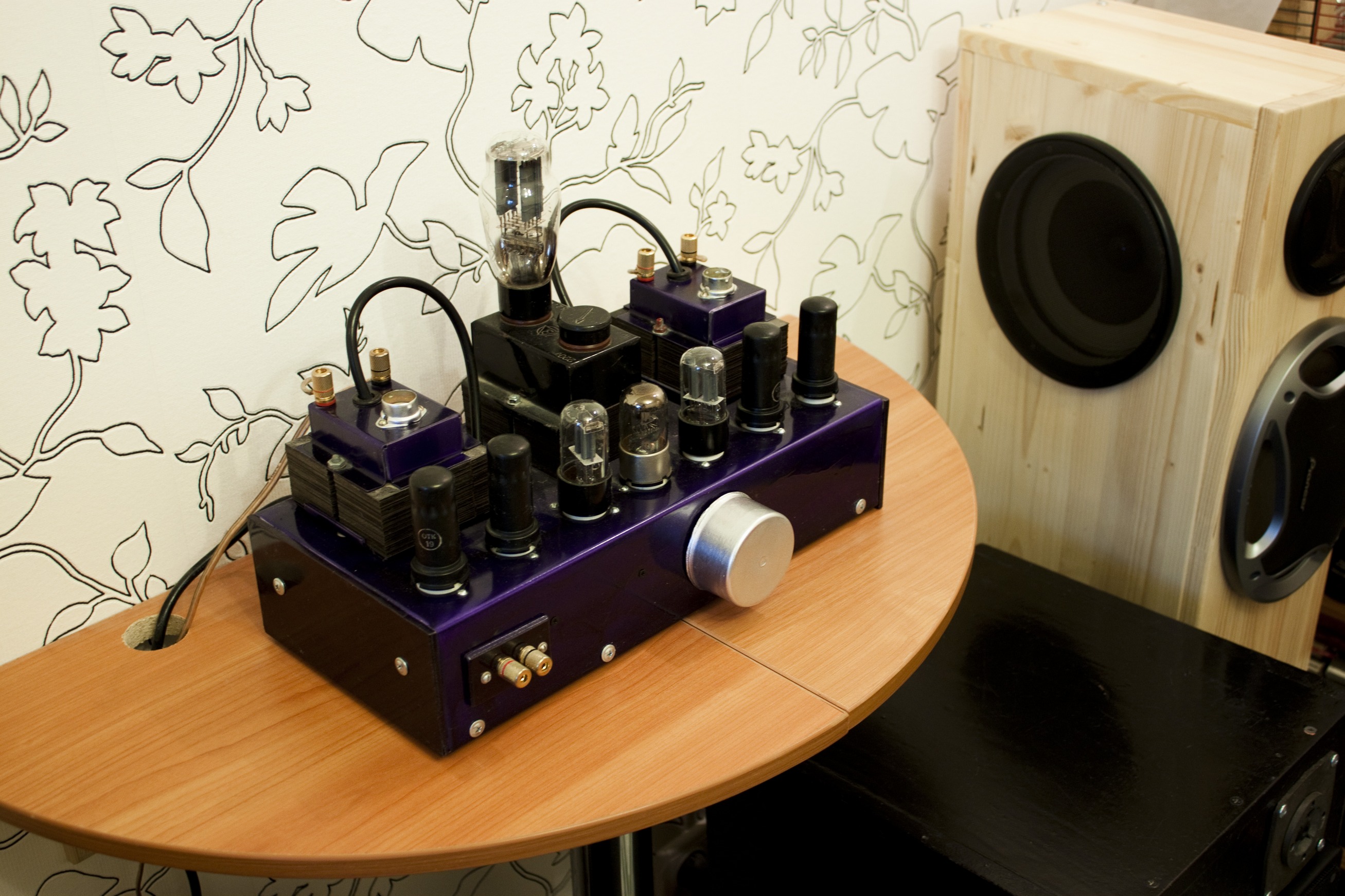

Hello all!
Here is my amp. Mixed schematic from several sources.
Output stage with Russian 6P9 (6AG7) two in parallel.
Screen stabs are STR 150/30.
Line stage – Russian 6N8S (6SN7).
Bias rectifier – Russian 6X6S (6H6).
Power rectifier – Russian 5Tz3S (5U4G).

Wow, rectifier tubes on top of power transformers. Saving space? Talking about space, by any chance do you like rockets?
Nice considerations. Charming. Well, the space is great but here it doesn't matter. I've got this unique vintage power trans with such a tube placement, manufactured in 1953 for some kind of a specific device for the Sovier Army. Great core iron.
I like rockets since my next of keen was a pilot of the TU-95 aircraft "Bear".
About trying anything ... any try is a chance for the advance and progress. Thanks for wishing the bless.

This arrangement used to be more common than it is today. I guess it makes sense, in many ways.
