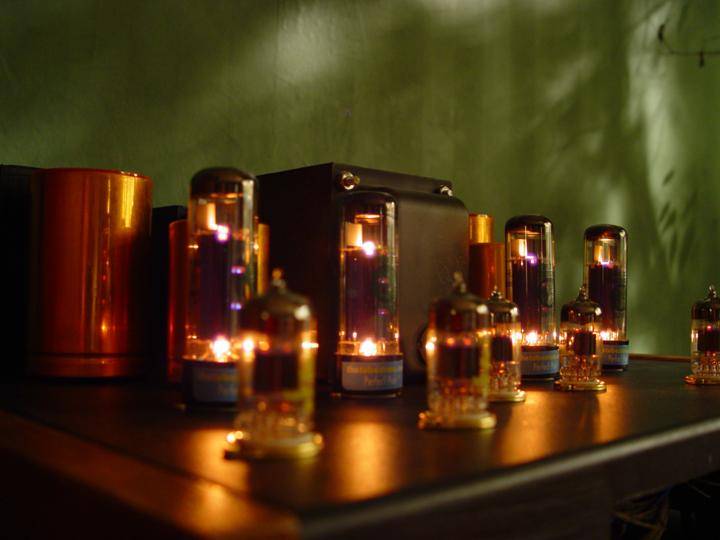

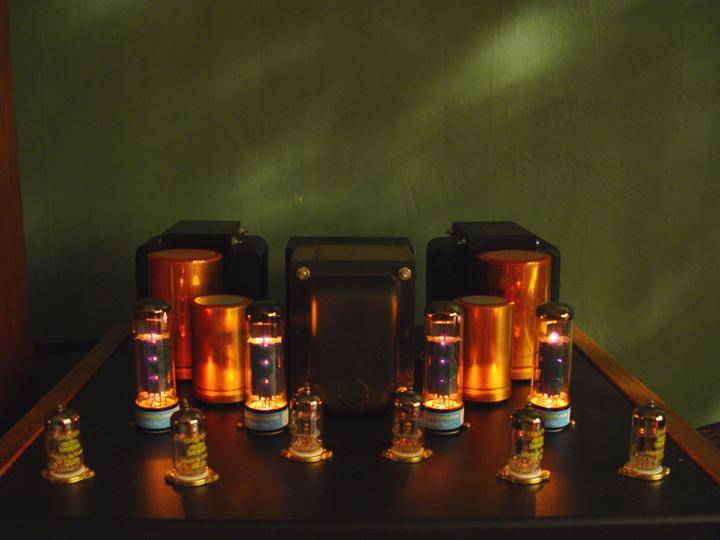

Hajdinjak Labs custom made Push Pull 300B monoblocks (not serial product - just a hobby).
Driver is on 500V anode voltage (like in Jubal from serial production), output stage is in auto bias connection, with solid state voltage regulators on the heat...
300B output stage is on 450 V. Thoroide transformers on output
About 30W of Power is enough for most speakers 90 dB/W/m or better efficiency..

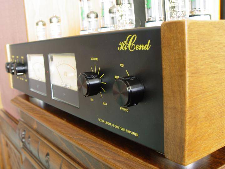

Our DIY amplifier
Yes, it is DIY! It was built by me and my ucle. It is Stereo Parallel SE UL EL34. I have done it's electronic circuit boards and uncle consentrated on cabinet and face plate. After cabinet completed he installed transformers, tubes, capasitors. He used screened high quality signal cables and DC filament supply to prevent hum. He is very happy with it's sound quality. Very warm, smooth and detailed.
Noyan
Noyan
