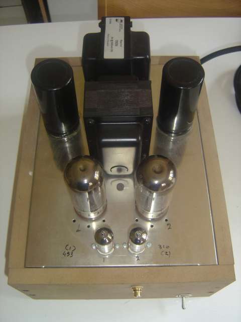

6550 UL
6550 UL

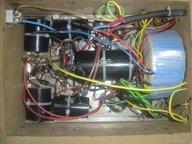

More than a year ago I built the OTL below based on A. Ciuffoli's v8.2 OCL here
I am so happy with it that I intend to live with it for many years. And this statement coming from an avid DIYer is itself a great compliment for the design ;)
After looking others people's excellent work here, I wish I had paid more attention to the looks though...

Yeah not bad at all you can take out each section and work on it independently :p
I'm a tad worried about those transformer windings coming too close to the cut vent holes at the 'front' of the amp, if a kid comes along and pulls on the wires it /could/ get cut :\
Other than that an excellent display of components above!

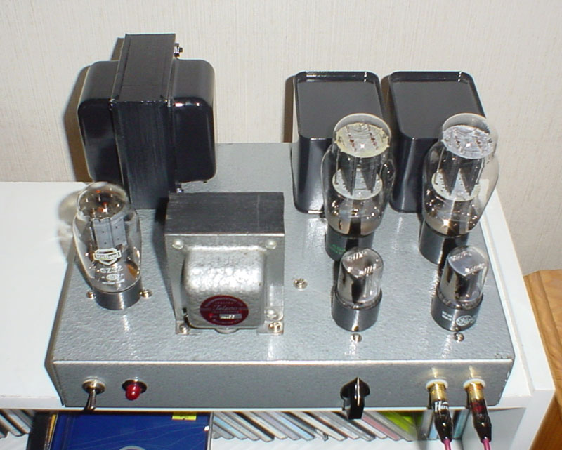

This is a 6B4G SET that I have been working on. 6SL7 drivers, cathode follower driving the output tubes. NOS Mullard GZ32 rectifier, NOS Sylvania 6B4G, and NOS GE 6SL7. Schottky diodes and a small toroid provide DC filaments.
Great sounding output transformers are from a pair of 1950s studio reel-to-reel decks. They are open frame, but covered up by painted Twinings tea tins! :smash:
Hehe, of course it was an old box that was being replaced... No-one at work wanted it, so I grabbed it!
As for the twining tea tins, they only just fitted the transformers, but they came up brilliantly and really look the part.
All up this amp has cost me all of $US150... :D

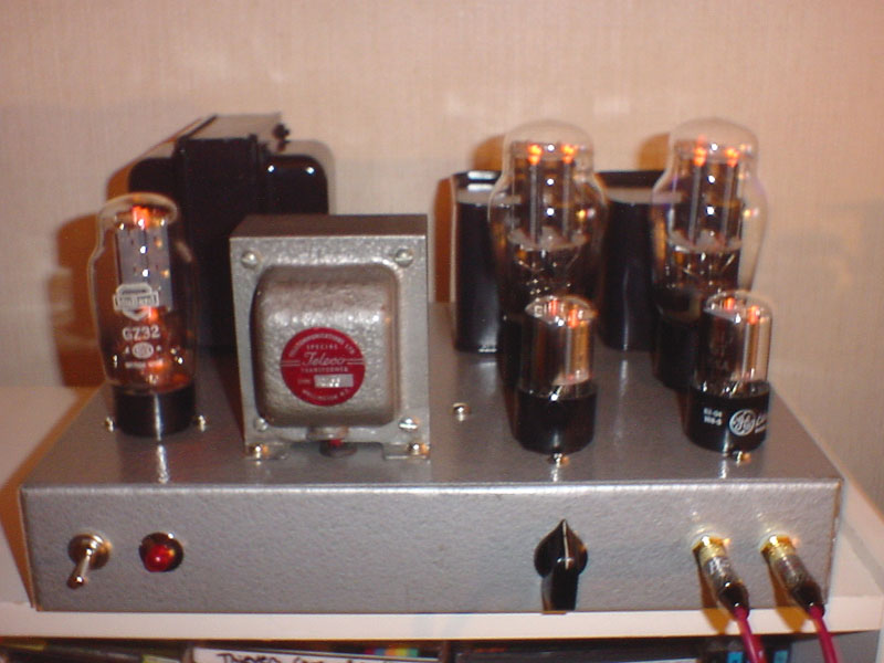

Originally posted by ShiFtY And the obligatory "all lit up" shot:
Yes I can't help but be torn apart between the black cans at the back and the tubes at the front, I think that sticker on the front transformer gives it a vintage feel, moving towards look-alike PA amps of the yester years with the original chassis paint :p along with the ol tubes, the rect tube fits in rockin :)
The black knob at the front is NOS 'guitar' style isn't it?
I could probably get it from that vintage restoration shop for ol guitar gear...
Everyone round here don't really use em as they don't fit in, but I'm in the middle of a diy amp that could really do with them...
