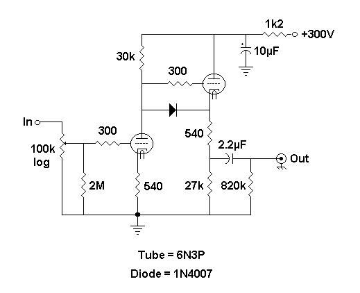

what kind of preamp is it? Grounded grid?
I have no Idea about Grounded grid or not, I just make it as this schema

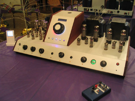

Hi John,
the tubes are ez81's and 6sn7. The preamp uses a half 6sn7 per channel.
The transformer and 2 chokes are indeed custom made by AE.
They are wonderful and the company is very nice to deal with.
Rest of the components: Riken Ohm, Elma attenuator & switch, auricaps, black gates, silver wire, JJ & Aerovox capacitors.
It's only my second tube amp and I got a lot of assistence from someone in Holland. Everything via email, I never even met the guy! Isn't the internet wonderful?
He told me I could change it to class A if I use the other half of the 6sn7. So I think that's next!
Matt.

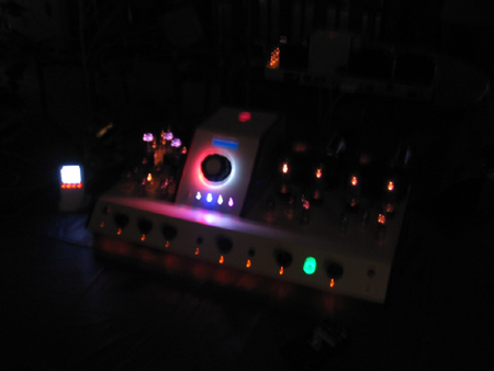

Finally, I've gotten around to milling and staining the wood panels for my integrated amp. I wish I could say it's done, but the software for the LCD still isn't complete. Maybe I'll get around to doing that if I can put the soldering iron down once in a while 🙂

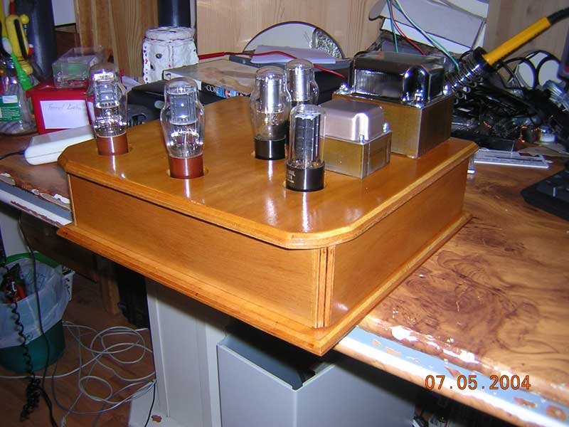

My 2A3 power amp, now in a new home 🙂
The wooden base is made from Philippine ebony hardwood.
Parts complements:
MagneQuest DS-025 output transformers, Hammond 372FX power transformer, Hammond choke, Hammond filament transformers, all Riken resistors, Dale wirewound cathode resistors, MIT RTX coupling capacitors, Black Gate bypass capacitors, Audience cable internal wiring, Solen/Nichicon Muse power supply capacitors.
How is hardwood to work with in frame bases of that thickness? and what notches does it use?
Btw the black wooden base really matches the transformers and black-base tubes, the red RCA 6SL7 sort of make a bold statement saying HEY I'm here! which is also backed up by the nicely-white steel.
Of course that's if you want to define it as art, which it is of course, great work!😀
I had it custom made, as i do not posess the skills. the aluminum top plate is what i made, cut from 2mm aluminum plate and i used Bradrad and a drill press to make them holes 🙂
thanks 😉
