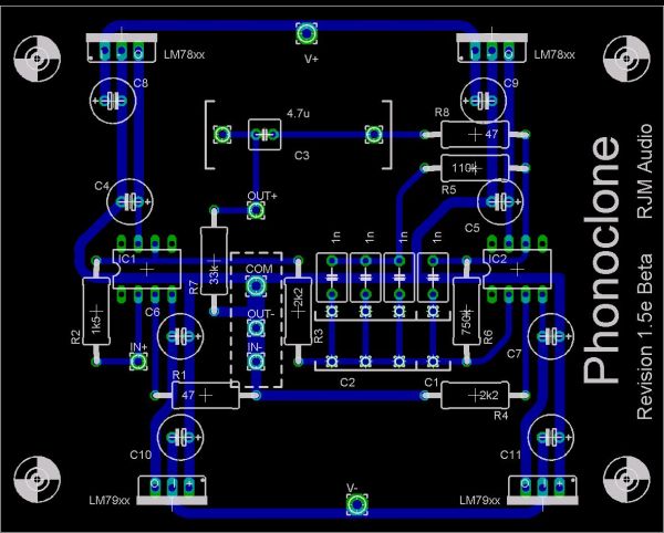

I worked on the layout a little to incorporate some of your suggestions.
1. Bigger resistors can be used. 12.5mm spacing, type 0309, which I take to be 1/2W. Of course smaller ones can be used in the space.
2. Optional use of a film output coupling cap. Model shows Wima MKP4 22.5mm lead spacing.
3. The RIAA caps shown are WIMA FKP2, Probably the MKP or MKS series are a better fit from a package dimension point of view, being thinner.
4. Bypass caps shown are Panasonic FC, 25V 100uF. Since I know many of you want to add more capacitance, I`ll see what can be done here. I was going to make the lead spacing 3.5mm on the input at least, but putting the metric component in my 0.1" grid was not pretty, so I left it for now.
5. While I dont think moving the regulators off the board is a good idea, it can easily be made an option, just by bridging the in and out voltage traces of the unused regulator socket holes.
6. After all that messing about, however, the board size is now 3 inches square. Choice doesn't come free...

A couple of people have emailed me asking if PCBs are available.
The answer depends on the date you read this. I am taking orders until Saturday, April 30th, 2005. I will only have as many boards made as there are orders, so please don't email me later asking if any are left over because there wont be.

I'll let the first batch run its course before giving a definite answer, but given the level of interest chances are we'll do it again. Also giving serious consideration to a dual mono VSPS on 1/4 eurocard for $15/pair, but I'm getting ahead of myself...

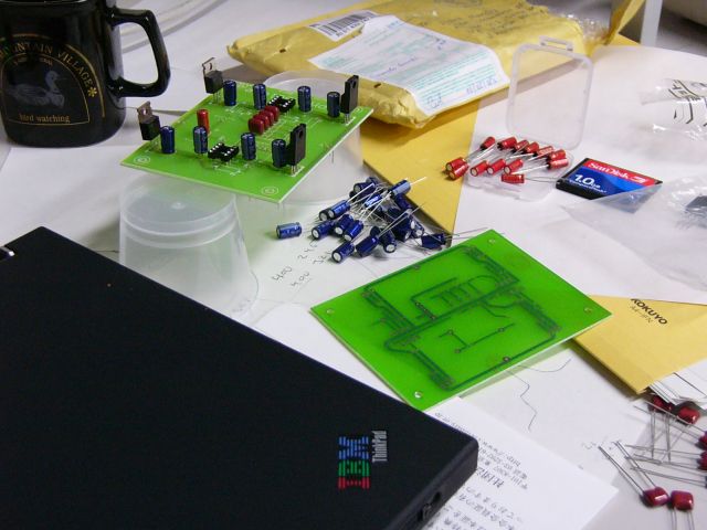

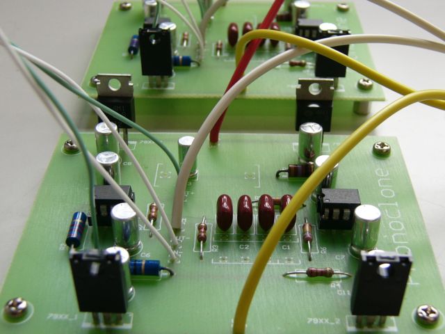

This project went from paper to prototype to PCB in the space of six months. I would like to thank everyone who posted here with suggestions and information, and also those who took a chance and bought the first batch of beta-boards.
