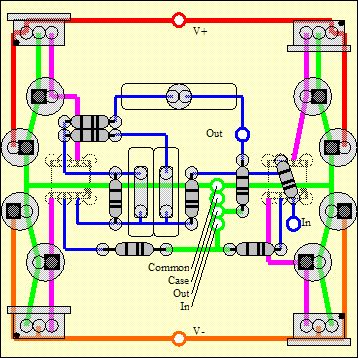

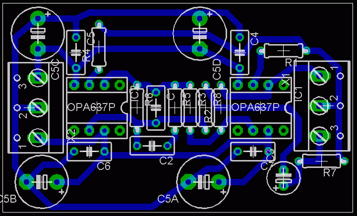

Correction for the original layout, after the opamps were switched to the underside of the board. When I mirrored the diagram I forgot to flip the regulators back to the top side.
The opamps are on the underside so that they can be mechanically fixed to the case, and the whole board can held down with just 2-3 screws.

In the process of trying to copy the PhonoCube, you have designed something different from it. That, I think, is a better outcome than redoing what has already been done.
As it continues to break in it keeps getting better and better.
On the homepage I decided to change some of the values. Increased R3 to 2k2 from 680R to make it a more reasonable load for the first stage to drive. R4 is 2k2 to balance, and the RIAA loop is recalculated to keep the gain of the second stage at 30dB.
I'm still using the original values of course.
Messing about with the simulation, I came across a set of values that are not too hard to accomplish - 750k, 110k, 1nF and 2.9nF - which happen to match the RIAA response exactly. I mean, within 0.01dB which is exact to all intents and purposes, aiming for within 0.1dB is already well into overkill territory.
2.9nF can be had by paralleling three slightly under-spec 1nF capacitors. This has the additional advatange that only one value is needed for the RIAA loop, rather than two.

Wanted, a few brave men.
This has been on my mind for some time. Its just not possible for me to properly beta-test this by myself, there are two many variables for one person to get around. The results are good enough (it is impressive) that I'd like some other people to play with it a little.
I wonder if there are enough people interested. I'd need about 10 I think for it to work.
I'm willing to put the effort into getting the PCBs made and shipping them to the beta-testers. I can also get the Black Gate caps and voltage regulators relatively cheaply. I can sell them to the beta testers at cost + shipping. The cost of the "kit" would depend on the numbers, but roughly $30-50 I expect.
Beta testers are responsible for supplying the rest of the passives and the op-amps, since I can't get those any more cheaply or easily than you can, as well as the power supply and the rest of the hardware.
Interested persons can email me at rjm003.geo@yahoo.com. I'll leave the subscription period open for 2-3 weeks. We can discuss what components people what to use, and I'll modify the layout to accept the top few choices.
I'd like someone to suggest an online place to get PCBs made up. I know a couple, but haven't tried any personally yet.
