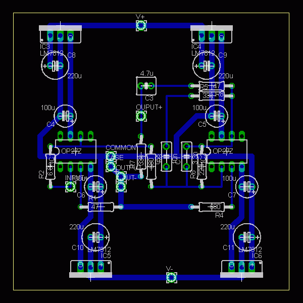

I have had a play in eagle.
I have not added holes for v+, GND etc yet, and I am not sure on the size of any of the caps lead spacing.
What do you think as far as component placement?
Im sure there is a better way to lay it out but I haven't worked it out yet

I dig it.
For the supply caps, figure 0.3" lead spacing, 0.4" dia. max. The 4.7uF black gate coupling cap is also axial electrolytic, 0.2" dia. and 0.1" lead spacing.
You need to add a little more room for the output coupling cap, and some more space too for the wire leads to attach.

Correction: the power supply caps should be 0.2" spacing, 0.3" dia max. I'm about half way through building the first prototype on veroboard. With luck I should be finished in a week...

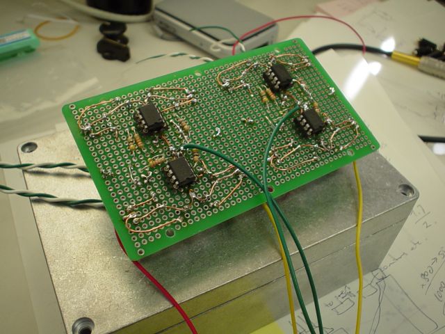

I'm pretty stoked to see how my prototype will sound. I'm using a VSPS with Tamura step up transformers right now, with an all-Denon front end: DP-2000 deck, DA-307 arm, and DL-103 cart, and I gotta say its one sweet combo. So it'll be a fair fight, so to speak.

Thinking on my prototype, 0.3" spacing you have for the resistors is a bit tight for standard 1/4w types. It can be done... but 0.4" leaves the leads in a more natural position.
Likewise the RIAA caps are PCM 7.5, or 0.3" ... it looks like you have them set at 0.2".
There's a orphan through-hole near C5A, center right.
Last, I was wondering what would happen if you turned all the regulators in on themselves, rotating the four blocks of capacitor-regulator-capacitor by 90 degrees. Seems to me the traces for the power supply parts could be shortened that way.
-rjm

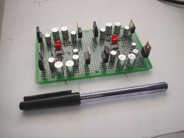

P.P.S. Attached is the phonoclone prototype as it looks now, unfinished. Missing still are the power supply caps and connections. The sockets and most of the resistors are on the flip side.

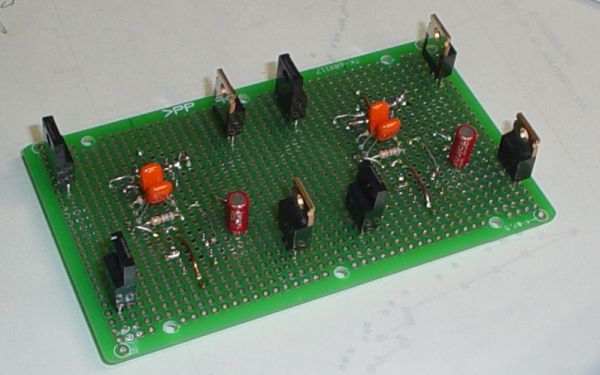

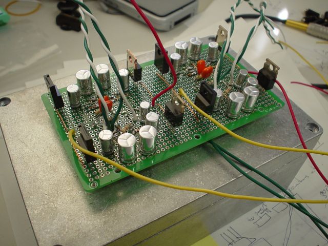

P.S. The prototype board is finished, complete with leads.

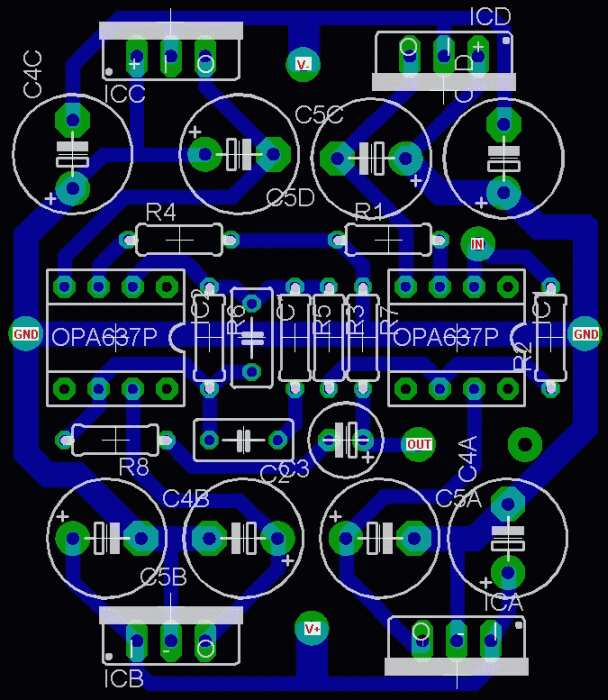

Still, as a starter, at least the schematic is all properly annotated and such. The layout is basically ok, though the voltage regs are still a bit of a mess, and I'd want to spread everything out over a larger area if only for the sake of my own sanity if I was actually going to physically get one made up.
And yeah, I though maxw's effort was better, too. 🙂
-R

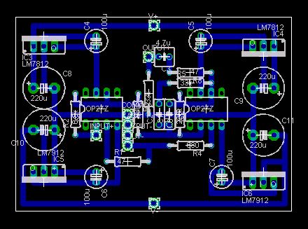

1. My "last word" on the eagle layout. See attached image, and attached files in the next post. I left enough space for larger capacitors to be substituted. Bypass capacitors are closer to the opamp power pins. The tradeoff is more signal trace length than before.
2. I had my prototype all hooked up and ready to go, but on applying power two of the LM7812's exploded. Flipping the layout once too many times I had managed to wire every regulator backwards and upside down. No really, I don't think even one pin was connected correctly. So I'll have to pull it apart and do some repairs. The layouts uploaded earlier have this error, so I'll put a corrected version here as well as on the homepage .. but do double-check all your regulators. I was so concentrated on getting all the capacitors wired properly I neglected a simple check of the Vregs...
