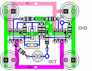

It was brought to my attention recently that the 47 Labs Phonocube uses an OP27G as the front end op-amp.
I'd always held out for the AD797, but although the OP27 is has about five times the voltage noise, its low bandwidth and slow slew rate would make it a much easier beast to implement.
It seems that every few months something comes up regarding this project that has me scribbling out layouts at all hours of the day. So it is that I've come up with a new layout for the phonoclone that has separate voltage regulation for the input and output op-amps. It has the requisite 25 parts per channel and I'm confident that its pretty close to the Phonocube design. The layout, however, still looks too complex to be a good match.
More info :
http://www.geocities.com/rjm003.geo/rjmaudio/diy_pho4.html

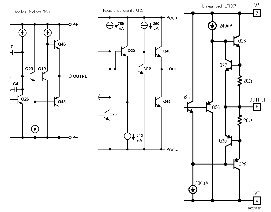

OP27 output stages
Shown in the attached image is the output sections for the Analog Devices OP27, the TI OP27 and the LT1007.
The LT1007 appears to be a different, but I'm curious about the two OP27s. The TI schematic shows two pnp transistors for the output Q45,46, while the AD schematic shows a complimentary pnp, npn set.
I'm quite ignorant of transistor circuits. Are the two OP27 schematics equivalent? Is one a typo? If the schematics are correct, given the choice is one arrangement preferable to the other?

Re: OP27 output stages
thanks
-rjm
Hi rjm,
Hey that's funny the TI OP27 is using all NPN transistors. (Not PNP as you wrote erroneously)
First time I see a second sourced part with a different simplified schematic.

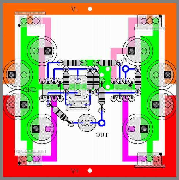

Another Layout
Here's another layout. Its the same circuit as above, but with a simpler arrangement. The power rails are now on the outside, with the regulator and bypass caps on the four corners. The signal grounds all connect to the central bulge of the ground tab.
-rjm

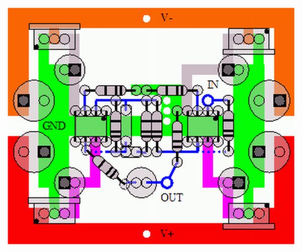

and lastly (for now)
- Expanded to square shape.
- Narrowed the center ground trace, so the signal runs under the IC. This removed the need to bridge over traces, everything is now a simple single sided layout.
- Added a little more room for larger capacitors.
-rjm

Just had a look at the layout and this design uses two single opamps per channel and you have 2 regs per opamp = 8 regs for one stereo phonoclone!
So maybe you should separate the psu section so we can only use 2 regs for all opamps? just a thought 😉
Re: Re: and lastly (for now)
One of the tricks to get the most out of opamps is to use lots & lots of regs.
dave

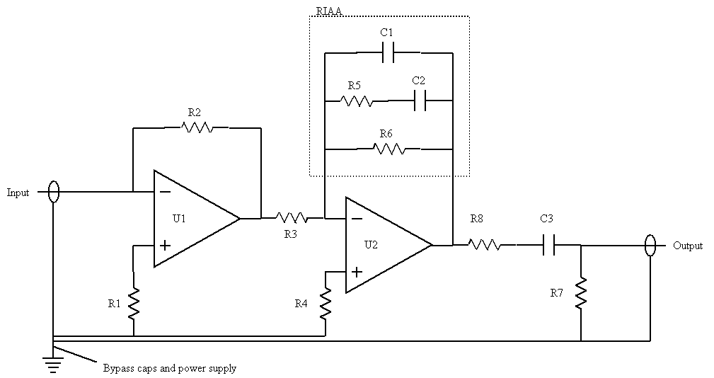

Phonoclone Circuit
It on the web page, but for easy reference I'll copy it to this thread.
Parts list for one channel:
R1 47R (Denon DL103, set equal to cartridge impedance)
R2 6k8 (Denon DL103, 75dB gain, calculate for desired cartridge/gain)
R3 680R
R4 680R
R5 33k *
R6 220k *
R7 33k
R8 47R
C1 3.3 nF (WIMA MKP) *
C2 10 nF (WIMA MKP) *
C3 4.7 µF (Black Gate non-polar)
U1 (OP27 for 75dB)
(OP37 for 90dB)
U2 OP27 ?
* RIAA values, match to 1%.
also needed, 2 each LM78xx and LM79xx regulators, and eight low-impedance filter capacitors, 47-220 µF .
and the appropriate power supply

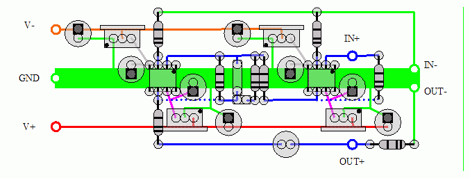

maxw:
People who've spent the money on a low-output moving coil cartridge to use with the Phonoclone probably won't get too worried at the prospect of 8 voltage regulators. In this instance I think they should be considered a necessary part of the amplifier circuit, rather than an optional part of the power supply.
However if you want to, for example, use a battery power supply, or just for the hell of it, attached is what it would look like sans regulators.
-rjm

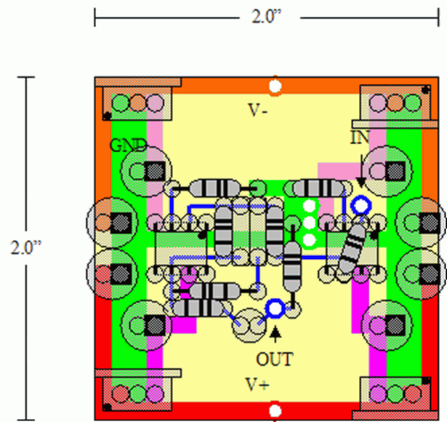

Prject Status
I've been sitting on this project for more than two years. What happened was I got 80% of the way there but then took a wrong turn trying to fit the AD797 into the 25 part scheme of things. Learning about the OP27 let me settle on the 4 regulators in place of the various bypass and decompensation caps needed for the AD797. Than, in turn, got me thinking about the layout again and finally I managed to come up with something that was small, simple and correct in terms of the grounding scheme.
The Phonoclone has been next on my "build list" since finishing the MC step up transformers six months ago. But... its going to be 2-3 more months before I'm likely to finish. Audio projects have a way of disappearing off the horizon for weeks at a time for various reasons. So I can't answer "how does it sound" questions. Reviews of the Phonocube can give you some idea of what we are aiming for. The VSPS was actually conceived as a proof-of-concept of the Phonoclone's RIAA circuit and power supply, and I built that, so the circuit has been partially tested at least.
Regarding the choice of op-amp. The input offset voltage of the OPA627AP is typically 300�@uV, roughly ten times that of the OP27. This limits the OPA627 to the low gain configuration, but it is otherwise suitable.
Since a dual opamp by definition shares the power supply you can't build a Phonoclone with dual opamps. You can build something similar, I suppose, with a reworked layout, but I'm not sure offhand what would be a suitable IC to use. Actually since the signal path is already only the length of the components, you wouldn't gain anything in that respect by moving to a dual IC.
Lastly for Eric, the short answer to your question "I wonder if the 47 ohm on the [non]inverting input is correct?" is "yes, I believe it is... since the cartridge coil is connected to the circuit ground the full output signal, and the full output impedance, is seen at the end of the coil that is connected to the amplifier's inverting terminal." You some potentially interesting points, but please edit your question replacing "inverted" with "non-inverted" and "+" with "-" in all the right places first.
-rjm
PS. the PCB is now down to 2 inches square! The feedback resistor of the first stage is, a la gainclone, soldered across the opamp terminals.
