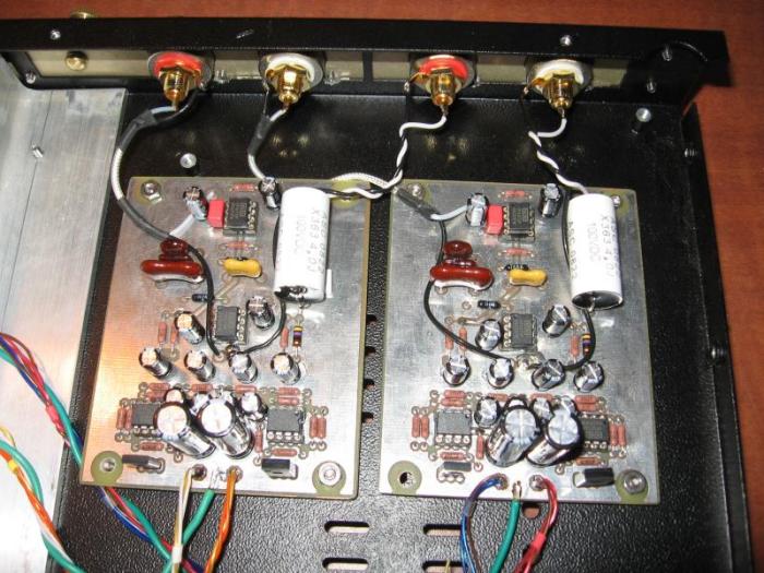

As you can see the x-reg is implanted in my phonoclone.
The operation was more complicated then expected but everything is running smoothly for a couple of days.
At first startup you hear the smooth mid and highs directly. Also it sounds like you hear every detail there is. The highs are sounding more clear and bright (highhats and triangles sound like new).
Even the soundstage is so clear you can hear the different acoustic recording spaces for the different instruments/singers.
The bass sounds better defined (pink floyd's dark side is really spectacular now), but here I feel there is something missing, like the rhytm and the foottapping. Maybe it is the different character I have to get used to or maybe the X-reg needs some time to break in?
Technically the spikes above 300 Hertz are gone, no noise, but still some 50 Hertz ( and 150/250). It is in the noisefloor of the record, but still it's annoying me. I tried everything I can think of, but the most influence is the inputcable. When I hold it up in the air the hum is almost gone.
I was thinking that maybe a true star-earth would help, now I connected the COM to the X-reg left and right and from their to left and right phonoclone. Maybe it is better to connect the com to the phonoclone and to the x-reg seperately and not between x-reg and phonoclone?
It would be nice if the board would give an option to have seperate lines for signal and for power ground so you could make a star outside the boards for left and right combined?
So all in all a big improvement but I am still experimenting for hum and bass.

Hi Fran,
I'm using a vdHull Frog. As far as I know it has 23 ohm's impedance.
So I'm using this for R1 and 360 ohm for R2.
At testing I also found out that I forgot the trafo is 2 times 15 Volts, which gives 21 to the X-reg, and 11 Volts to the Phonoclone. I don't know if this is a problem... Maybe I better lower it to 9 or 10V ?
Mine sounded better at lower voltage, say 9-9.5 or so.
My reason for asking is that a few people have reported this hum, and others don't have it at all. I was wondering if those with carts which have very low impedance (eg mine is 11R for the Benz L2 and 4R for the zyx R50) are more susceptible to the hum.
Fran
Fran
Can you describe in what way it sounds better?
Might be possible, even with a dummy input resistor there still is some 50 Hz left, although 20 - 30dB lower.
Other possibilities I was thinking off: The powercable picks up the 50 Hz but this should be filtered out by the X-reg.
Or the aluminium box does not shield enough?
Or the grounding is not OK...
