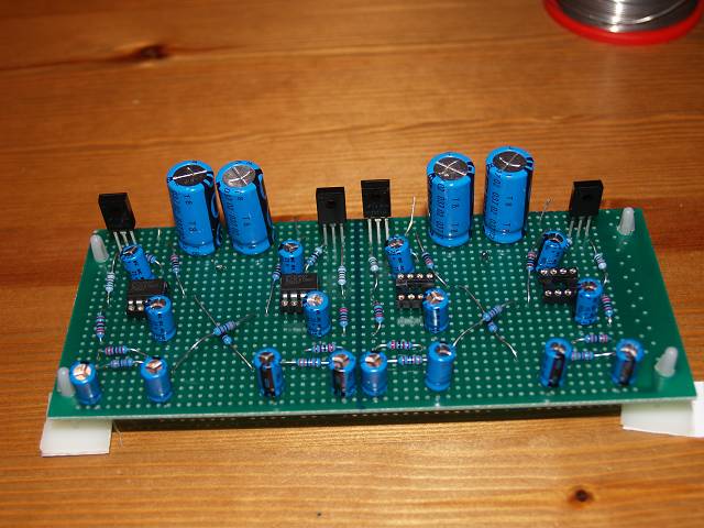

PS. @GerardA, nice work: that looks like the very first prototype phonoclone I built, which was also point-to-point. I wish I could say it brings back fond memories, but ... no. It was hell from start to finish. Circuit boards are well worth the modest investment, as they make construction faster, easier and less stressful - as well as being more professional looking.
The notion that PCBs sound worse than point-to-point is actually softof true: a 24 AWG wire used in point-to-point has much lower resistance than a similar length of PCB trace, so ground loops and other unpleasantness, if present, will be more noticeable on the circuit board, as I found. On the other hand things like ground planes and other low-noise / high speed circuit techniques can only be properly implemented from a PCB.

@rjm Thanks. It sure looks far less professional, but it is meant for me as a kind of proof of concept. It is built with cheap parts that I could find in the local store.
When it really sings I'm planning to repeat it with boards, double heavy trafo's and better parts. But then it will take weeks/months to find all the parts and listen to the alternatives.
In the meantime I can enjoy the music!
And maybe more people can share their experiences with different parts? Would be much appreciated!

GerardA said:When it really sings I'm planning to repeat it with boards, double heavy trafo's and better parts. But then it will take weeks/months to find all the parts and listen to the alternatives.
You certainly have a rigorous methodology. I was just surprised to see you using the original four vregs per channel version, the same one I started with back in early 2005.
All things considered it might be more efficient to take advantage of the considerable advances made since then and skip up to the most recent version. Grab a set of Phonoclone 3 boards and start your experimentation from there...

@ rjm
To late, I already finished the x-reg!
When I get the two missing OP27's I'll see if I can do the surgery and make everything to the last standards.

Gerard,
It looks like you've been busy! Once you remove the vregs and the vreg input caps from the original point-to-point board and hook up the Xreg you'll be all set!
I'm happy to see someone actually do that mod. Let us know how it works out.
