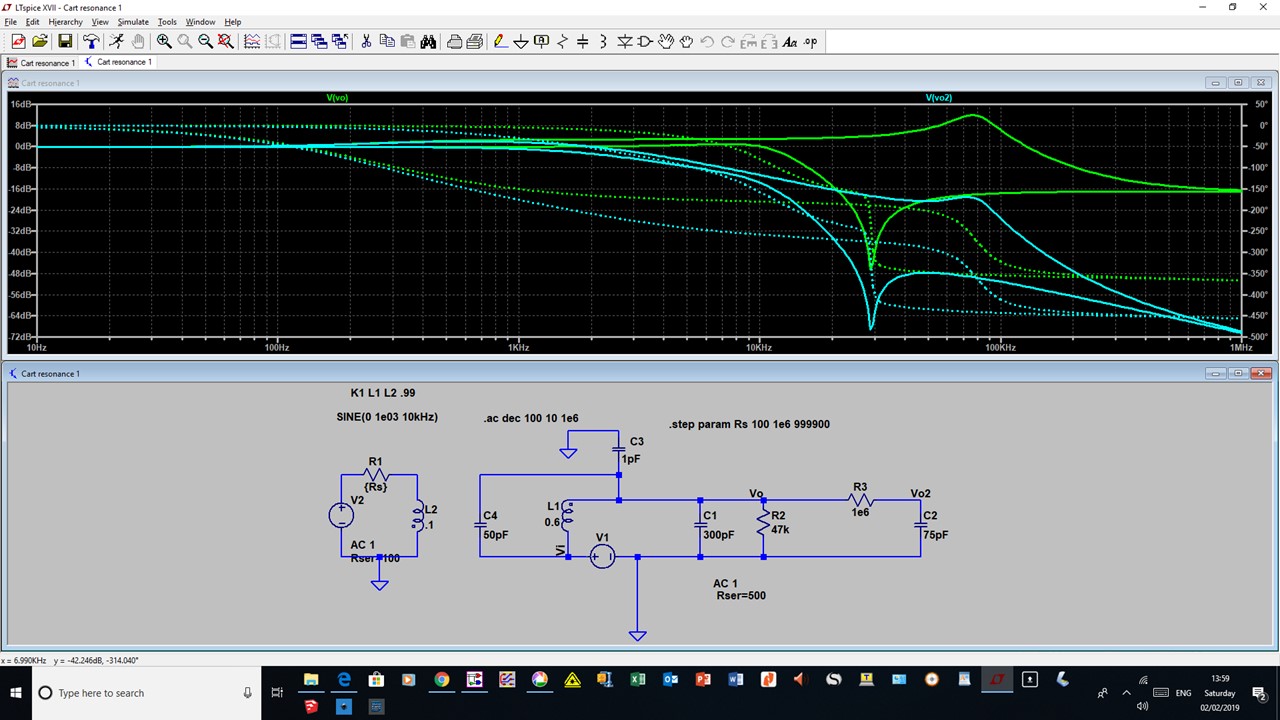

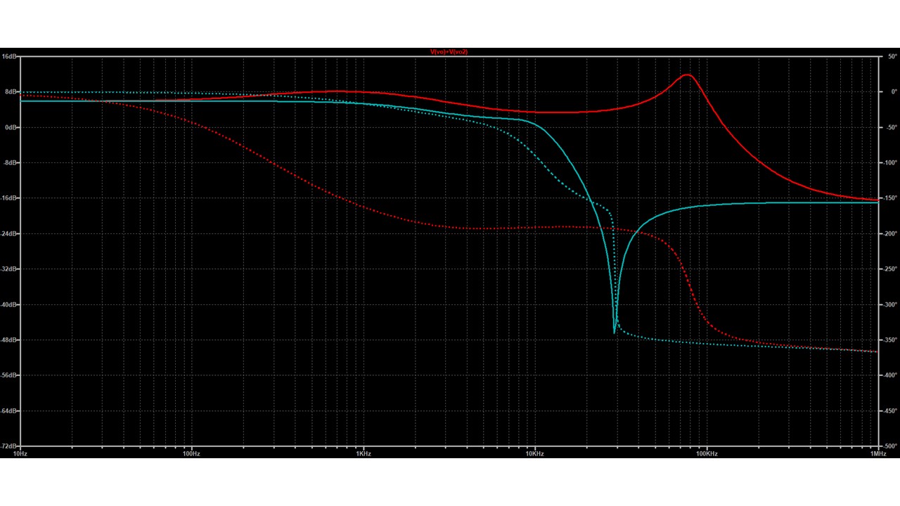

I've had another bash at this. I've 'modelled' the mechanical resonance with V2 which gives deep dip at 30 kHz - obviously this can be moved around within reason with the judicious adjustment of parasitic L and C.
I can only get a significant resonant peak at ~20 kHz if I increase the cart load from 47k to 100-200k which hardly representative of reality. More work needed.
R3 and C2 crudely model the RIAA corner f at 2120Hz.
I need to find a way to sum to two curves. Anyway, my 2 cents worth.

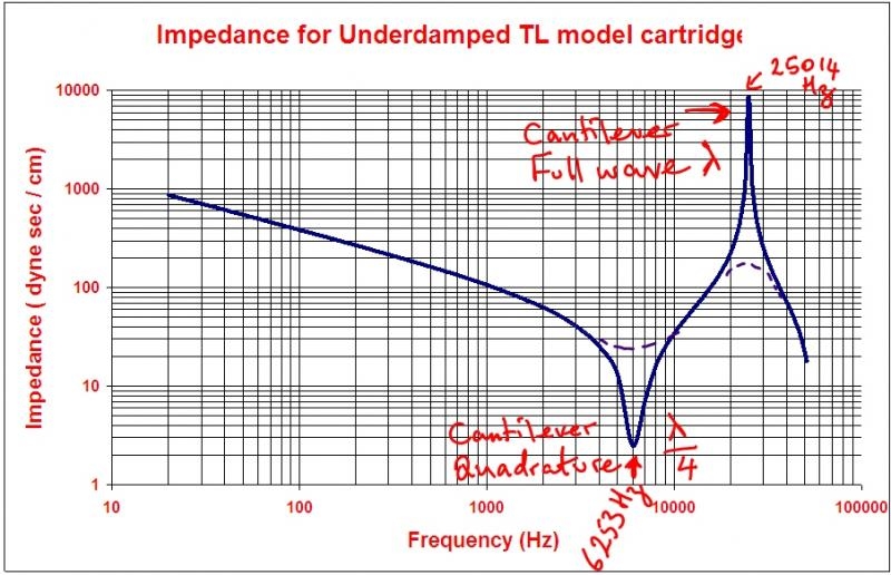

Bending mechanics and wave propagation theory yields equations in fractional powers in fourths.
Here's a plot from a while back on calculated cantilever impedance as seen from the pointy end which sort of has an interesting and familiar profile. Only certain modes of cantilever bending resonance are permissible without mistracking.
Cantilevers bend!
