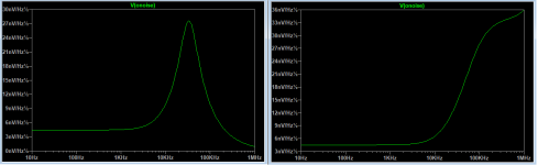

Below are two examples, I picked Rod Elliot's split L model just as an example. The first is loaded (100pF||47k) second is unloaded. Both of these are noise only. We can measure the series resistance and the basic low frequency inductance, the noise signature should reflect the loss and, if present, a resonance will give the internal parallel C.
With much difficulty I was able to measure the noise of the DA in a 50pF mica capacitor. Thermo-dynamically all electrical loss mechanisms have an associated noise.

Scott,Below are two examples, I picked Rod Elliot's split L model just as an example. The first is loaded (100pF||47k) second is unloaded. Both of these are noise only. We can measure the series resistance and the basic low frequency inductance, the noise signature should reflect the loss and, if present, a resonance will give the internal parallel C.
Thanks for the references, they show the possibility of non-minimum phase in these measurements (?).

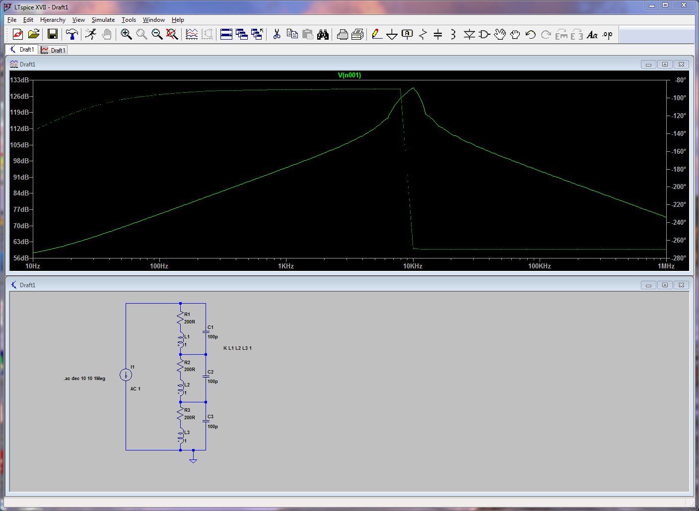

Could you show Rod Elliot's model that you used to create the noise image.
I have tried on the internet, but couldn't find this split L model.
Hans

I think in this article Rod has it backwards. He writes (2nd par below Fig.4)
“Cartridge manufacturers often use cantilever resonance to attempt to get a flat response up to the highest frequencies,”.
What I see happening is that the cantilever resonances is the cause of the anomaly in freq response which manufacturers try to compensate by trimming the electrical motor and it’s electrical loading.
He also measures and simulates with the 47kOhm resistor in series with the voltage generator and not in parallel to it.
I don’t get this.
It is a loading resistor.
George
