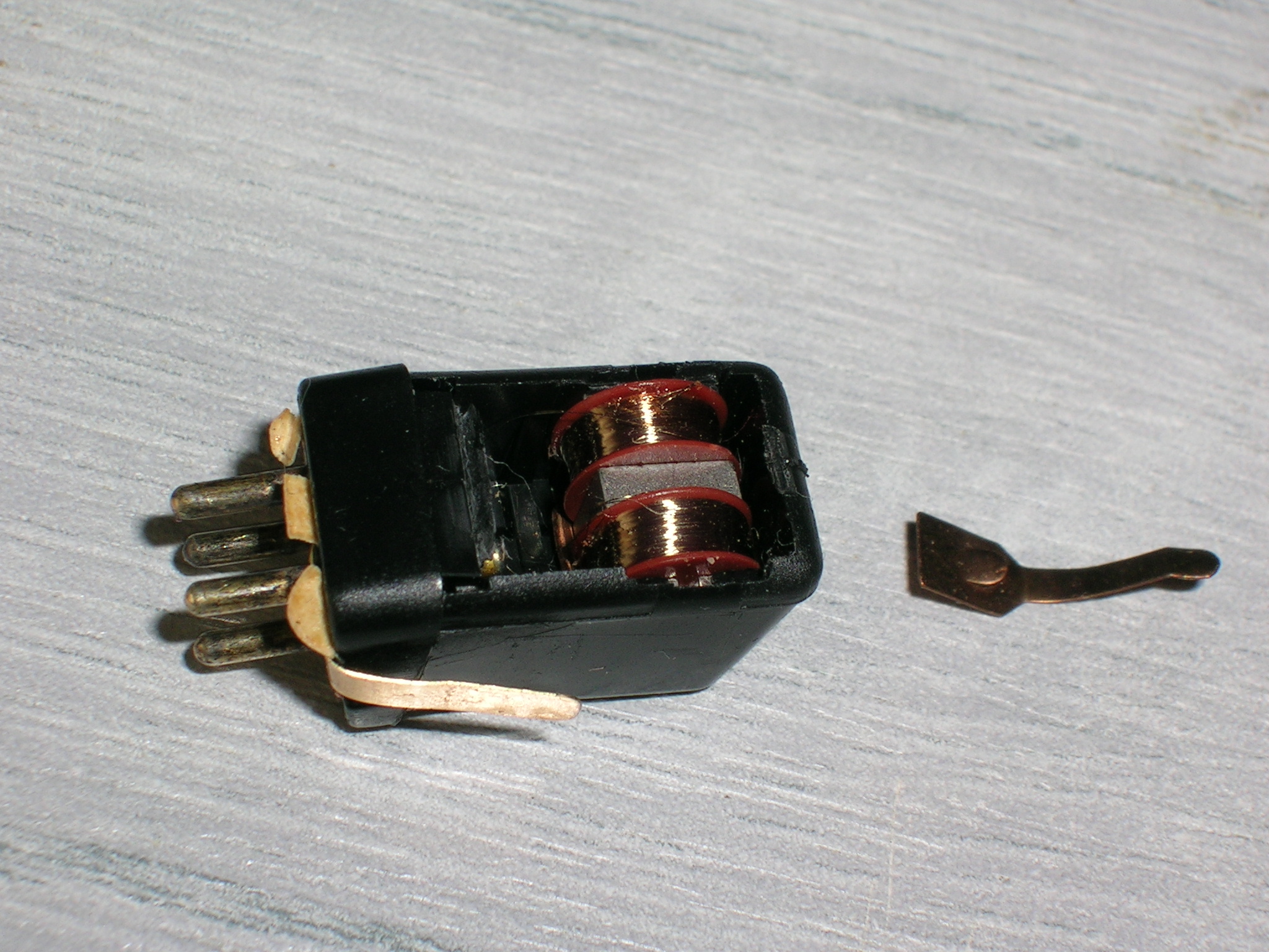

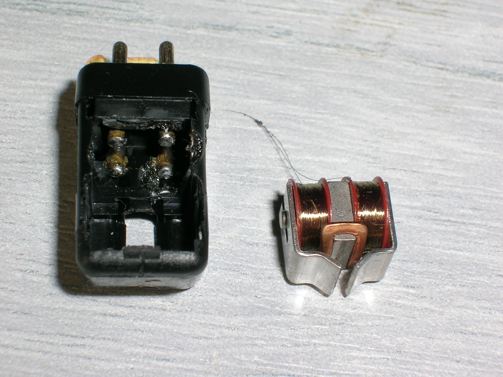

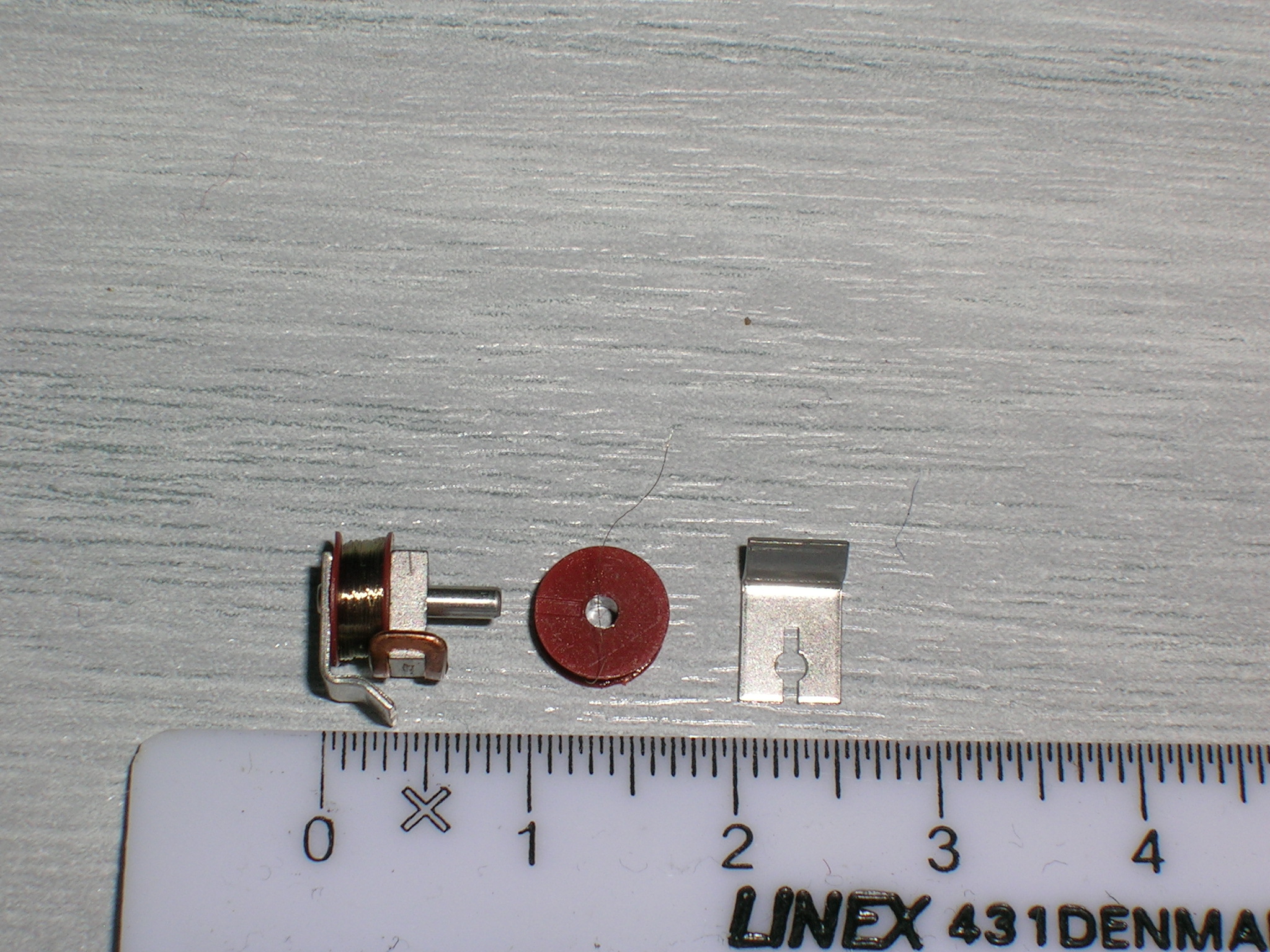

I have dissected 2-3 MM bodies.
From what I've seen, there is nothing special with the winding method.

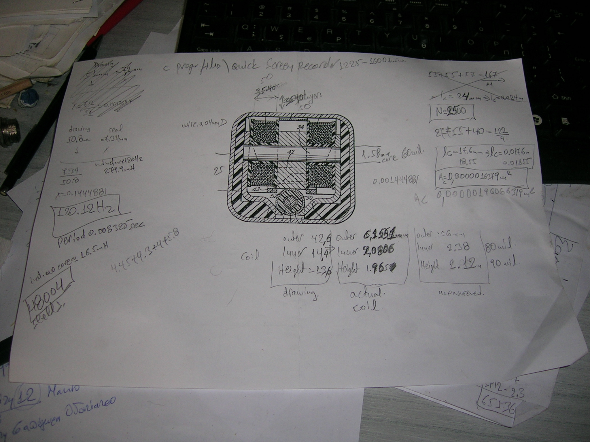

Plain solenoid -like continuous winding in a small size. In the latest victim’s case (Stanton MK V), each of the two coils had a copper- filled cross section 4.07mmx1.97mm consisting of approx 2500 turns of AWG 39 wire (50 layers, 50 turns per layer). No bank winding, no sectioning, just continuous winding

I originally though of building a distributed self resonance model via the L of one layer and the C to the next but that soon makes no sense since the C's are in series and as L grows the C goes down. I suspect the entire structure along with the mutual coupling is involved.
Scott, I think it’s not that straight.
There is capacitance between turns (Ct), capacitance between layers (Cl), stray capacitance (Cs).
Ct is in series to each other, Cl is in parallel to Ct and Cs depends on the surrounding structure
