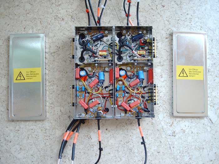

also, I ended up shielding the entire phono circuit from the power supply with a box I made of copper sheet... At highest volume there was some hum, but now it is really silent. Best would be to put the powersupply on its own chassis.
About the RIAA caps - I will buy those if I ever build another one or if I decide to build a better power supply for this one, new chassis, etc.
Yeah, same thing here, but now I have two outputs one normal and another attenuated via 12k and 5k1 voltage divider. The attenuated output cuts down the unwanted noise to almost imperceptible levels so it really isn't a problem.
I attach a pic of someone else's phono preamp which is probably the best way to do it but I wouldn't take the trouble to do that.
