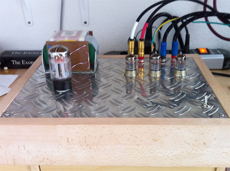

Hi All,
I just want to thank all the experienced posters here for sharing their kind advice in this forum.
I have build a few end stages, usually with small modifications to known schematics. This is the first time I built a phono stage, and it really sounds great.
Zero hum thanks to star grounding and a nicely regulated DC heater supply. I do have a little RF hash, but it is very minor and easily fixed with a few matched low value resistors on the grids.
I experimented with some cold cathode voltage regulators (OD3A's have a wonderful glow) but found it to be more dynamic and life-like without them. Maybe it was due to the different mains transformer. I tried Hammond iron with an expensive full wave rectifier and OD3A's, but this version uses Lundahl iron with a 6BY5GA in a hybrid bridge.
I still have to do a few small things, like build a cover for the (admittedly ugly) Lundahl transformer. Right now I am using budget China tubes but they will be probably be replaced with something matched of higher pedigree.
Again, I would just like to thank all experienced posters for their input and advice in this forum. I don't post much, but do read the forum frequently and have learned a lot over the years. Thank you.
Kind regards
Ian

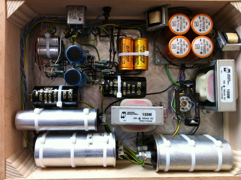

Looks very nice mate, well done 🙂

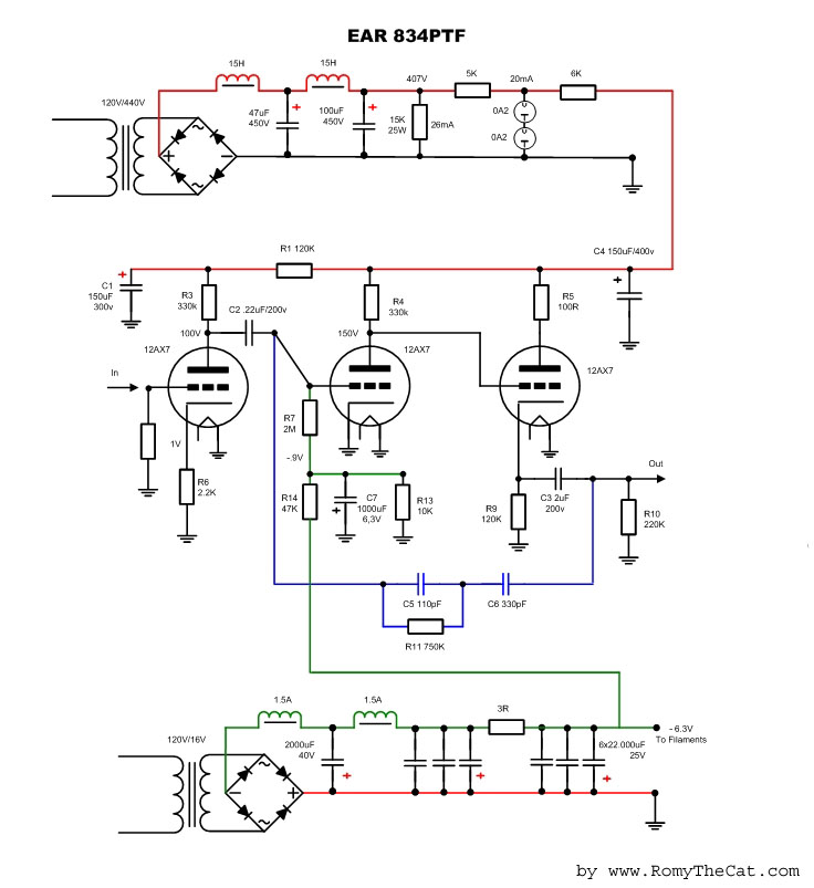

I need to do something similar, do you have a schematic for this build?
I used a modified schematic similar to that of the EAR834p... not so complex really.
If you look up this 'romy cat' circuit online you will find he uses air tuning caps in the RIAA correction. The sound is very good with these, but I am using Amtrans AMCH instead.

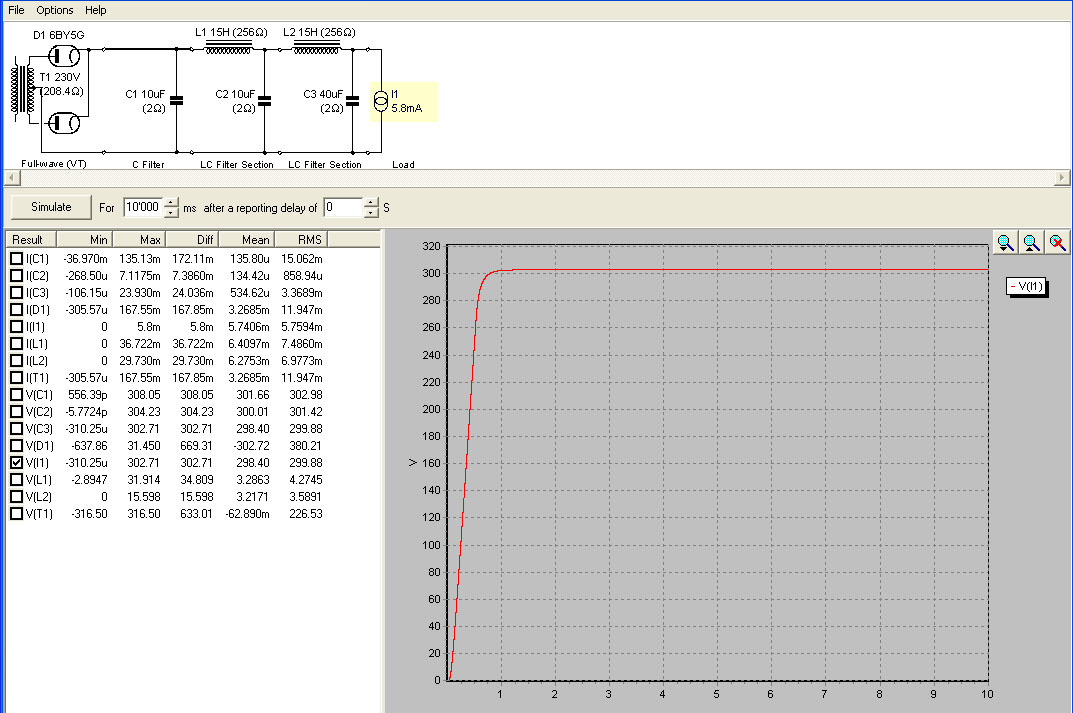

The power supply for mine is also slightly different, using a Lund LL1649 transformer I happened to have. I added 2x 100 ohm wirewound resistors in series to the HT secondaries to reduce current inrush to the rectifier. It is a hybrid FW rectifier circuit with a 'virtual' center tap made of a 6BY5GA and two CREE silicon diodes. The added serial resistance smooths the response curve nicely. The 15H chokes are Hammond 159M, and most capacitors are motor run type.
I have also made a separate circuite to de-charge the caps when it is in the off position.
I breadboarded a few different schematics before deciding to put this one into my chassis. One deciding factor is that I have a lot of ecc88 and ecc83 type (various brands). So schematics I experimented with utilized these valves. There are a lot of great designs out there. I am sometimes astonished at circuits that are branded 'new' that actually have been done ages ago...
Ian

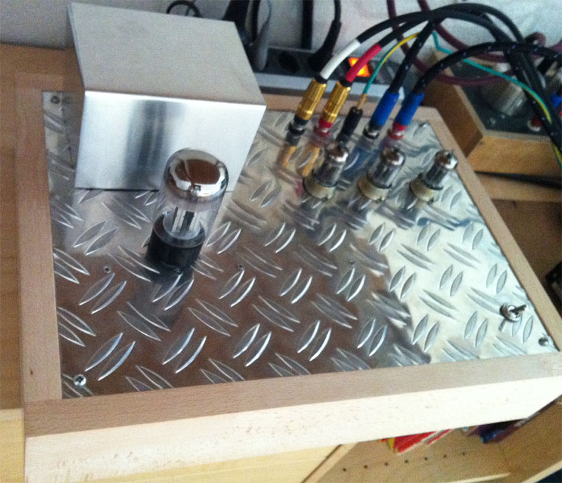

<snip> The Lundahls sound great, but building covers for them is a bit of a pain.
So's electrocution.. Seriously though you can probably get a suitable housing on line, or contact the vendor you bought the transformer from - they should be able to help out. You'll know exactly what I mean when you inadvertently brush against one of those pins.. 😱 I've done it too many times.. 😀
One of these might work to cover an exposed Xformer:
http:/www.goodcomponent.com
Click this link:
Shuguang,Shuguang treasure,Fullmusic,Guiguang tubes,amplifier chassis,tube sockets,capacitor,resistors,coil meters,toggle switches,tag boards,transformer covers,various parts for tube guitar amps diy <meta name="keywords" content="tube sockets,shugua
Scroll down to:
Transformer>>>Tranformer Protect Cover>>>Page 1>>>Page 2
GDTC-03 $10.50
Inner: 126*96*110 (H)
Outer: 130*100*116 (H)
“or”
GDTC-08 $14.61
Inner: 127*127*130 mm
Outer:134*134*136 mm (H)
Other sizes on offer as well. Silver or Black or Silver/Black. I’ve not bought any yet but they look good and are priced Hong Kong (Shenzhen City) cheap. There's other cool looking stuff as well.
Donald.
I know.
Do you know what they want for a Lundahl transformer cover? These Lundahls MUST always have a cover and they are not sized like any other transformer... something like 105 x 90 x 80 mm...
I can make my own with some folded aluminium and epoxy for a LOT less. I will paint it black soon.

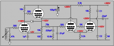

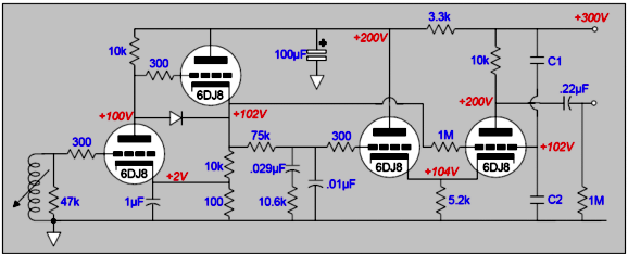

Also, there are other (VERY GOOD) phono circuits with lower gain... One I also really like is Broskie's Unicorn. For C1 and C2 I used 0.22uf ERO MKT1813's that were in my box. It is the phono stage I most like for listening to classical music late at night...
I keep thinking it must be something in your PS. Is it a 100Hz hum you have? If you can, please post a photo.
