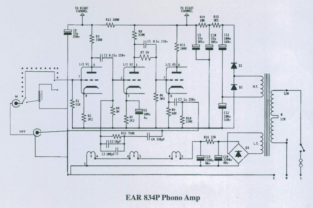

A few things here - do you still get hum with shorting plugs on the input in place of your Turn Table (TT) input? If all is quiet then you definitely have a ground loop problem.

It's not a bother. Many of us have gone through the same things. But, if you have no noise with no input device, and noise when input is plugged in, that suggests a ground loop of some sort. Triple checking doesn't always help. I've often overlooked an obvious problem multiple times. A fresh set of eyes might spot something. Have you read this?: Audio Component Grounding and Interconnection - diyAudio

Yes, I do. It disappears when I short the outputs and also when I short the grid of the second stage.

Since the noise floor is benign when no input is present, but it hums when you plug in something plus you are sure its the input tube, it could be it oscillates when introducing system wiring on input. One of the classic manifestations of oscillatory behavior beyond heat and microphony is harmonic noise. Does it have enough and direct to grid pin short legged grid stopper value?
I am not sure of anything other that it hums when I plug in the RCAs from another equipment. Shorting the inputs when the cables are connected does NOT stop the hum. Shorting subsequent stages kills the hum, the little RF hash noise, everything: total silence. Remove the inputs without shorting anything and there's only a little hash noise, no hum. But the time for this fix is up. Tomorrow will be the last day, I'm not wasting my time anymore on this. Much easier to do it all over again in a different chassis, different layout, maybe even different schematic.
Yeah.
If it turns too microphonic when you will knock on the input valve a bit when it hums, its very fishy it oscillates. If its only hum due to a loop or a field, it should stay as microphonic to a similar a knock as when not humming.
It's fixed! And it was never broken!! All this time the preamp has been in the 'lab', belly up and surrounded by other electrical equipment. This has never been a problem before but now it has. I installed the bottom cover, moved it to another room, used an AC plug which didn't have anything else connected to it and that was it. Hum's gone!!! It was picking hum either from the shared AC plug or from nearby equipment. It wasn't the TT because I had the same problem when any other gear was plugged in. I know I look silly now but there's always a first time! I hope someone learns something from this. Thanks for the help.

A pot at the output is still a possibility although I don't like the idea very much. Something like this:
PhonoI
What do you think of it? What would be the output impedance with a 100k pot? I have a blue Alps somewhere waiting to be used.
If you have 100k on the output then that's your output impedance. its really kind of simple after the output coupling cap...
That circuit you posted uses a lot of TL's original mods for Ear 834p. That one has an output impedance of 28.8K (68K paralleled with 50K). No idea why he by-passes the output coupling cap. That looks like hokus-pokus to me, but maybe I am missing something.

Can't find 2M dual log pots, it will have to be 1M. Why there's a 2M resistor there anyways? A better load for the first stage or it has something to do with something else? Anyone?
It forms a voltage divider with the grid resistor of the next stage (cathode follower), and sets the DC voltage for its grid. The capacitor in parallel, couples the AC voltage from the plate of the second stage to the follower grid.

Sorry, I didn't realize there were two 2M resistors in that schematic. I was talking about the grid leak resistor of the 2nd stage. I'm going to install a pot there and was wondering if it's OK a value of 1M.
Yes and no. Yes you can install a 1M pot there, but you will have to recalculate the RIAA compensation values, or your RIAA compensation curve will not be accurate.
If it's not going to be your main volume control, and you only need to attenuate up to half, then you can use the 1M pot in series with a 1M resistor.
Or, if you are not using the phono amp for volume control, but only want to adjust the gain to match your system, then you can use fixed resistors to divide down the output. The value of the divider string should be 2M if you want to keep the rest of the RIAA network as is.
