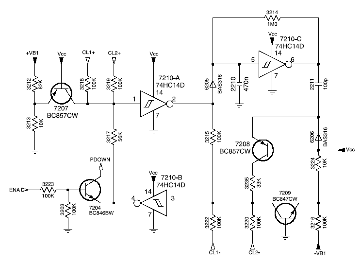

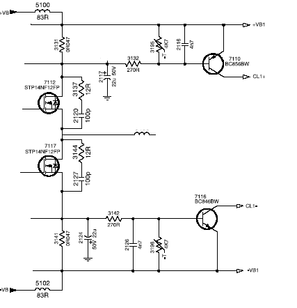

Last night I have found another one with UCD, but have not the schematic.
They call the amplifier module CUD-S400. It is what is marked on pcb.
The output transistors are 2SK3607-01MR
Turn off transistors 2SA1954
Drv BC857CW
Gate diodes BAS316.
Cascodes between comparator and driver 2SC2713
Input BC856BW
Suply regulated SMPS +44V -44V

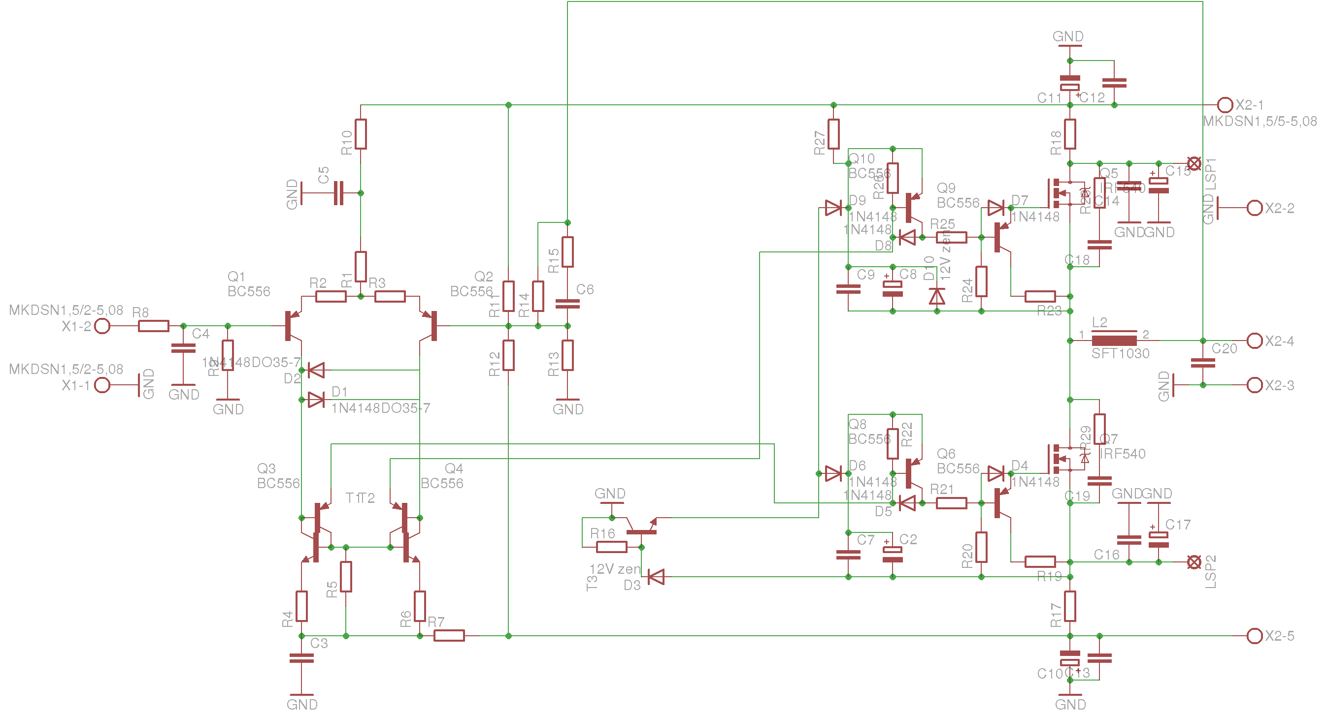

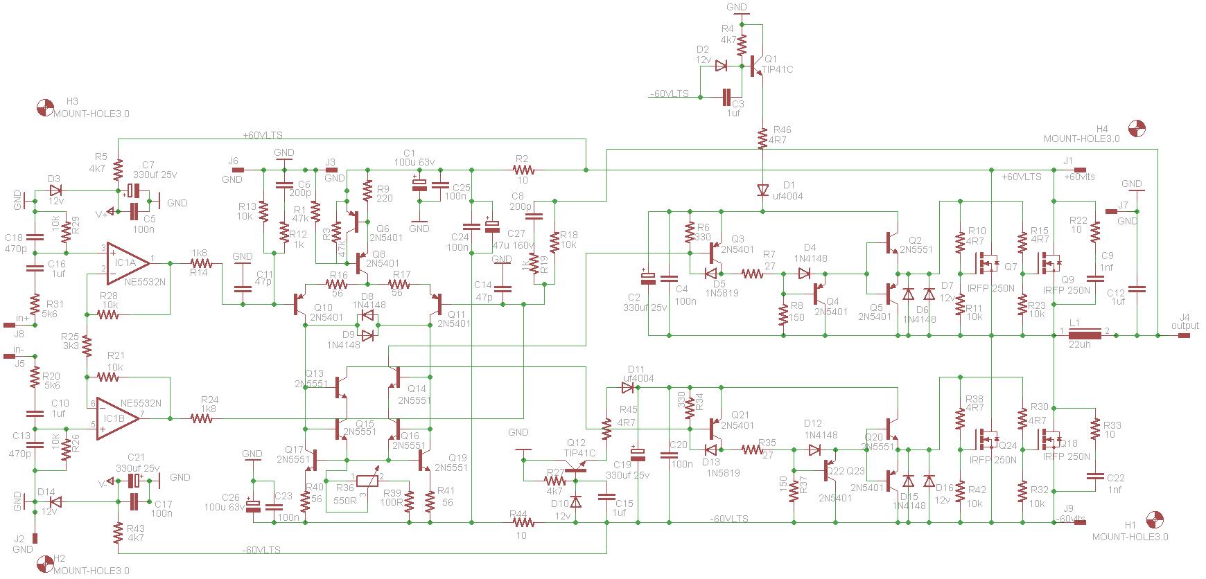

-------------------------------------------------------In this DIY UCD, in the input differential, there are capacitors C42-C44 valued 22pf connected to ground.
What is the function of these capacitors?
the function of these two capacitors is to suppress the Glish due to the junction of the diode (behavior with high frequency signals).
C40-C45 (22pF) also have the same function.
This interpretation has been looking at the schematic on this thread.🙂

Values of components are the same as on the orginal schematic (except transistors) but his names are diffrent.
Is it a good idea to use 2N5401 for driving mos-fet? (driver -Q6, Q9 on my schematic)
I cant buy orginal parts and I'd use other parts, or make amp on IRS2092, but i don't know which will be better and cheaper.
For Q6 and Q9 better choices would be BC369 or BC807.
2N5401 is fine for Q8 and Q10.
why are these bc369 better😕
Or a better low VCEsat (biss) transistor such as PBSS5140T or 5240T or similar transistors would be an option.why are these bc369 better😕

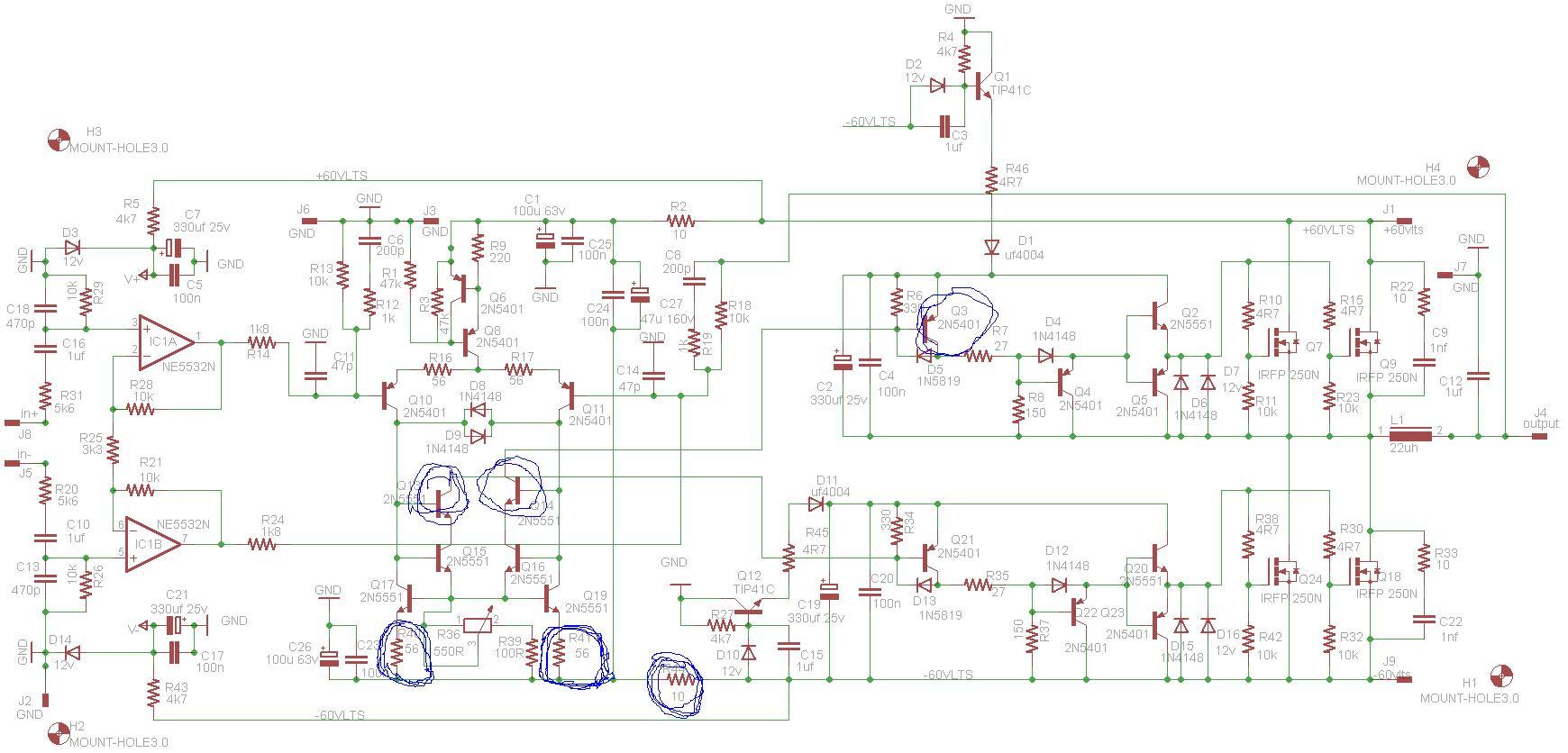

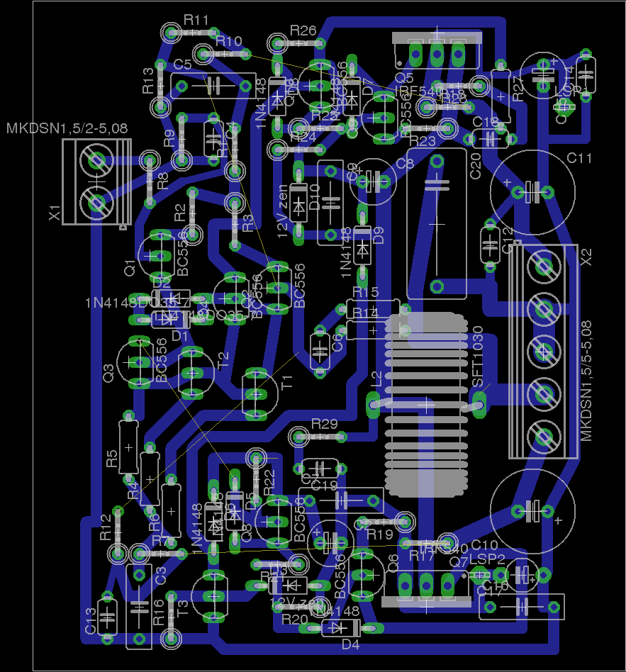

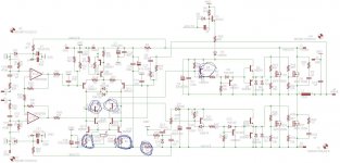

hi whortless i have made the below schema but q13,14,3 & 21 plus the aux +12v section fails vltg is ir2110 smps +/- 55vlts but my outputs fets are o.k . what is my error?
