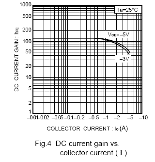

my UCD works well it makes 2 days, mosfet is iIRF530. Problems which heat has cured which change of R9 (yes this control deadtime, last pages of manual) to 390R. Later I found that conecting hetsink at earth stops completely which problems
BC640 turn-off and 1n4148 in all work great, it has some problem in this? 🙄
