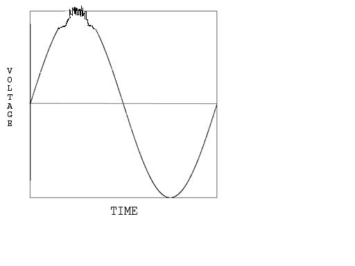

I´ve just finished my UcD using 70V rails (Philips application note and ne5532 differential at input-very similar to Classd from ru UcD2.5), and I have some interesting behaviour that I like to share.
I´m using IRF640, fosc is near 330kHz, rgate is 27ohms, and, at 8 ohms load, near 60v peak-to-peak there is some noise at the top of the wave (sinus) and a behaviour like it´s going to clipping, just at the positive side.
The efficiency is very good and, using 100ohms load the swing reaches, without problems, almost 140v peak-to-peak. Using 4ohms load the maximum peak is near 40v peak-to-peak till noise occurs.
I´m using an 18uH n. 2 Micrometals toroid core.
I think the problem is aty the upper gate or pcb layout at upper mosfet side.
Any thoughts?

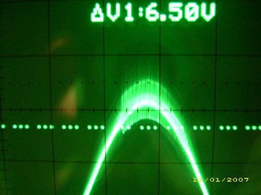

Hi everyone !
I got the same problem of noise at the top of the sinus wave with my proto
clock design @ 250kHz with IR2113 driver +2*IRFP4227
it occurs at 40Vpeak when driving 4 ohms
I'm using T106-2 core 47uH + 470nF MKP
rail voltage are +/- 80V
see pic...
could someone help ?

Hi
I think that fredos said that you have to use big upper capacitance and lower too, but most important is as he wrote
And there is something that you gave ground plane under inductor, wich will increase winding capacitance and eliminate ringing.
I hope that this is right
0.47uF is cap that is connecteb between +V and -V as close to fets as possible.good 0.47uF 250V MKT will cure all ringing you have on your squared wave! Some 0.1uF ceramic with 4.7 ohms resistor to ground help a lot too...

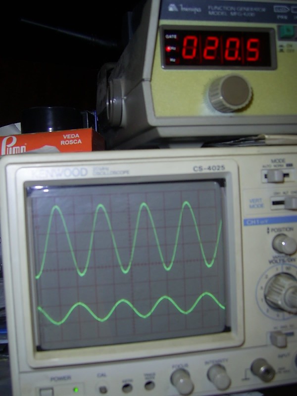

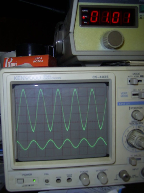

I took some shots of the waveform yesterday and, after some measurements, I notice that the problem has to do with the layout and absence of some decoupling caps, like Fredos said.
After some wiring mods the ringing was reduced and the amp easily swings more than 90vpp at 8ohms.
At this weekend I wil improve the wiring and will put some decoupling caps. after that I will try o achieve near full rail swing.
for an old analog audio guy its a very funny challenge to put this amp to work...
Tks all
Tks all
Hi
Looks good. What is your supply voltage? If you don't get good decoupling cap, buy one that has high voltage, ie. 630v. What happens if you go more than 90Vpp?
Luka,
The power supply voltage is 70V regulated in half bridge SMPS.
It´s able to put out more than 90vpp, but I prefer rewire and decouple the circuit before stress it.
by the way, actually I just forgot to glue the output coupled inductor of the power supply and the buzz of it when the current raises at 1kHz is awful. I will test more excursion after gluing that too...
best regards
Here is other picture of it working with 35vdc at 1kHz. No problems and a clean waveform.
best regards

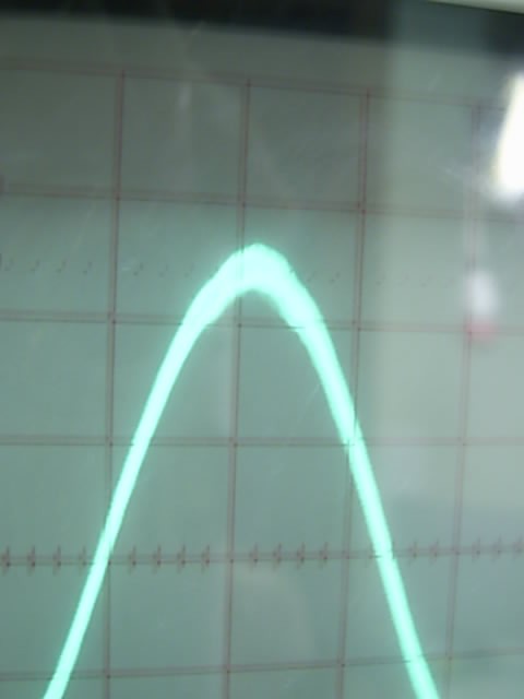

Below is the picture of the waveform at 20kHz 35vdc. 10v/division at output.
