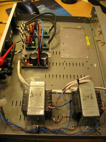

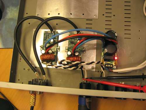

Time to try out my mini UcD in stereo on my main speaker setup.

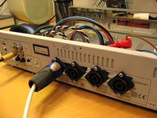

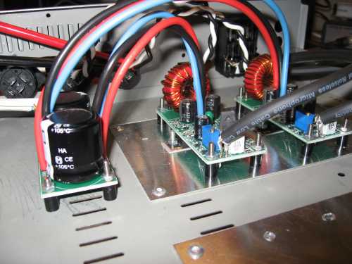

I fitted the smal amps into an old DVD player casing
..... thee will be room enough for two more amps (will try out the amp running hysteresis mode).
Well I guess it should have been obvious, that it wouldn't beat my main amp (LC Audio "The end" with ULC input circuit, dual mono 180W out, 2 x 800VA + 4 x 22.000 uF RIFA)
Anyway I was almost thinking that it being a UcD it could beat anything🙄
Well it plays quite well. The bass is not as "deep" and does not have the same weight as the LC. The mid and high is quite distinct but very clear. The feeling of space and room is good, but not as relaxed, and well defined as on the LC.
But there was a problem with a high pitched tone being present all the time.
Think I've heard this before, when trying to put two amps in one case. As I recall it should help moungint the two amps as close together as possible .... but that was what I thought I hade already done.
Would it help syncronising the amps??
And hould bould that be done as easy as possible??
IT also have some 100 Hz "noise" .... gues it comes directly from the PSU.

Baldin said:But there was a problem with a high pitched tone being present all the time.
Hi Baldin. Does the high pitched noise go away if you only have one module powered? If so, the two modules are definitely interacting. It may help to physically space them farther apart.
Reloacte the rectifier side of the power supply board as far away from the module wiring as possible. That should help reduce the 100Hz noise a bit. Also try twisting the power supply wiring together for each module if possible.
