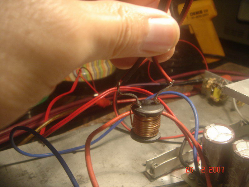

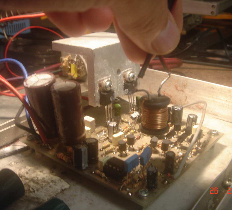

Hi, Baldin,
I put cables on inductor, and move around the PCB. It has effect. While hovering in the air, in certain places it changes the magnitude of Vp-p residual seen on scope. The position of inductor (vertical/horisontal) while hovering also have effect.
This is getting more and more confusing....
when the inductor is passing near supply rail cables (especially the +rail cable), the "chirping" bird sound becomes louder.
I guess this "bird" sound problem actually comes from layout/pcb problem.

lumanauw
Don't use your drum core
There is a huge difference in toroids and drums, a Toroid will contain the most of the field inside the core ("running around" in the core). A drum will radiate a lot of energy at both ends!!!
You have now seen how it affects the workings of the amp shifting the coil around. Start by changing to a toroid (e.g. Micrometals material #2 is really good for such application ..... dont just take whatever you can find)
It this doesen't help enough, you will have to do a new more compact PCB.
