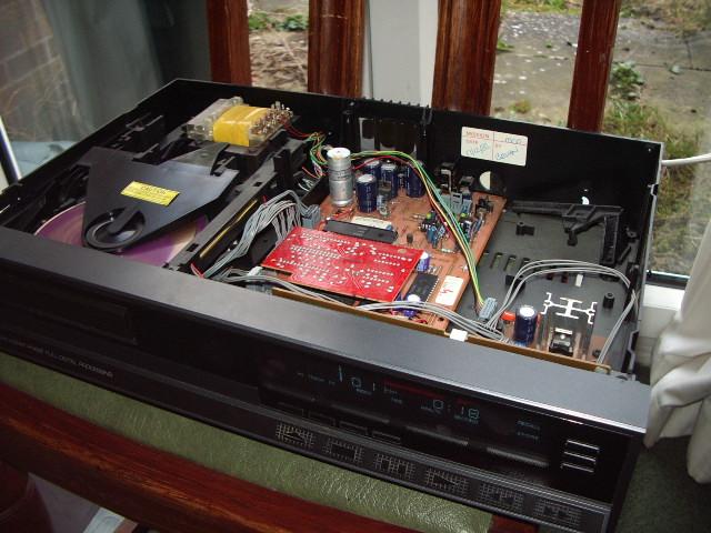

hello fellas - I've been lurking about for a day or so now while I awaited delivery of another super cheap ebay bargain - a Mission PCM4000 for a whole £11 🙂 - it is of course effectively a Philips CD650 in disguise - hence my interest in this fab thread!
Well it arrived this morning - and tbh I didn't really expect it work since it was packed in a box 3 times too big with no more than a single sheet of bubble wrap around it!😱 😱 - anyway work it did - and OMG - it sounded pretty damn fine too - all warm and cosy - top end wasn't exactly sparkling but nice all the same. Hmmmm - this is interesting.
back in the good ole 80's I went through a bucketload of Philips players but don't remember sounds like this!!
anyway - exactly 45mins & 1 album later, the top came off for a peek inside - you'll no doubt recognise the innards!
First things first - out with those 5532's and in with a couple of decent 8pin Sockets for a spot of opamp rollin - straight back downstairs with a brace of LM4562s fitted. Same album again - oh yes - a spot of clarity at the top end now - i am liking this a lot.
lunch and another couple of albums later I'm thinking it's time to address some power supply issues. On goes the iron again and a trio of OSCONs go in by the DAC in place of those little Nichicon 47u's. At this point of course it would have been sensible to stop and go have another listen .............................. but you know how it is - 😉 - the board is out and just begging for some more action . So on goes the iron again and the 5v supply for the 7220 is seperated from the other dozen things that use it and a basic 7805 is strapped in there to feed the 7220 alone.
back downstairs - and on goes album no 1 again - OMG ...... OMFG!!
- it must be that reg. on the 7220 - it's nowt special of course - but hell what a difference - dramatic - and I use that word deliberately! - real solidity to the music - and yet much improved space around instruments. ........ OH YEAH!! - this is gonna be fun alright.. 😀
I am just about resisting the temptation to just go balls out and do more in one go - psu diodes, non-os mod - rest of the lytics etc. - for now I'm gonna get used to this - at least 'til the weekend! 😀
anyway - ta for the great info on the thread guys - haven't managed to get hold of a schematic yet - are there any working links about still? - all the ones I tried are dead.
I shall read on with great interest - cheers again fellas.

LMAO - that looks familiar, well it would've done about 4 months ago
I couldn't find a service manual for the CD650, but I do have one for the CD640 and CD660, as well as TDA1541A, TDA5708, TDA5709, SAA7210, SAA7220, L272 - all easy enough to find, and free.
I can e-mail you these if you like, save you hunting them down.
I'm not surprised by your reaction to isolating the SAA7220. The same level of wow (more or less) will happen when you do the SAA7210 (big chip with small RAM IC next to it). I think you would be shocked to hear mine now. It's unbelievably removed from the standard sound.

Yes, isolating that 7220 is very important thing to do.

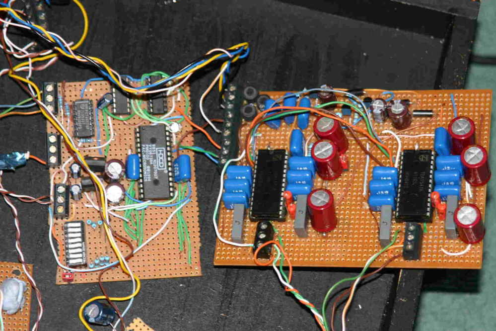

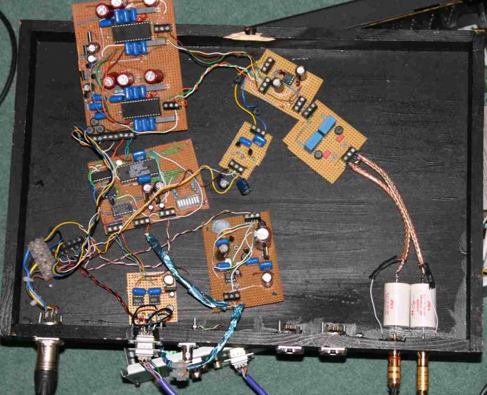

I'll see if I can get some pictures of my DAC up - I can assure you it won't look familiar 🙂 - Might also prepare Martin for the shock of what he has to plug into his system next week😉 - although he's seen it before.
