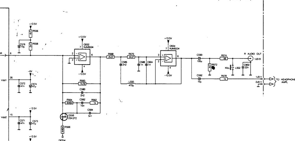

De Emphasis!
Just removed the Deem parts of the circuit!
I seem to have lifted again! Loads more treble detail and the whole sound seems much more punchy!
Def recommended if you've got similar DEEM circuts on the I/V stage.
Removed
C580-585
R562-565
Q556&557
Diagram attached again for ease.
Ian

I think, just removing the FET would've had the same effect.
But, I thought very few recordings would trigger deemphasis to be on anyway, so this circuit wouldn't be switched on.
Re: De Emphasis!
Phil.
Correct.
It is the difference in the frequency response between having the FET "ON" or "OFF" which gives the deemphasis.
Ian.
The C's and R's are required to give the desired overall filter response along with the components between the opamps.
It will give better treble but in fact you may now have a peak or at least a rising response.
Ideally, you should model the filter response without these components to see what you've got.
Andy

philpoole said:I think, just removing the FET would've had the same effect.
Phil.
Correct.
Ian.
Andy
Re: Re: De Emphasis!
I guess I need to scope the output if the I/V stage and look for clipping?
I certainly dont seem to hear any
Ian
Ian
Re: Re: Re: De Emphasis!
I wouldn't think clipping would be a problem.
The output is supposed to be 2v rms so with 15-0-15v rails, there should be plenty of headroom.
The filter response is supposed to be level to 20khz and then roll off sharply.
most of that will be the bessel (or whatever) filter between the opamps.
the components you removed would probably give a falling response with a couple of knees. Now the first opamp is linear.
Ian
As I said, ideally it needs modelling.
Interestingly, other TDA1541A DACs on the forum do seem to dispense with the filter altogether e.g.. i/v resistor and tube buffer.
Maybe Thorsten's designs may help?
Andy
I've still got the filter on the input of the 2nd opamp (which is now the dos). The only components removed were on the 1st opamp.
There is a filter on the DOS as well.
Like you say, I need better equipment than I have here to see what its up to.
All I can say is it sounds very good!
OK to go against the above, I've just removed all the filters other than whats on the DOS.
My I/V is just an op amp and resistor across 2&6. this is feeding directly into the DOS. The differential input of the DOS is now at ground.
What a difference as in "night" and "day".
The detail is absolutley awesome. This morning the 63 was in front for detail now its miles behind.
I've not detected any adverse effects what soever but I'm now hearing details Ive not heard before.
The 10th note of stairway to heaven is distorted. Its only just detectable on the 63, its clear as can be on the 960!
now i'm really smiling, I've almost considered post a pic of my smile!!😀
Def worth investigating guys
Ian
Ian

I think I need the 1st op amp to do the I/V conversion?
I'll get the player on my pals kit he uses to measure THD and the like to see if I've buggered anything but I'm def hearing a dramatic inprovement.
I think Lee's 94 is in a pretty similar condition so far as the O/P stage goes from the I/V directly into the DOS.
Ian
Ian
Thomo said:Hi Andy,
I tried both of those ideas, and got massive distortion both times.
Cheers, Lee.
What? Massive distortion just using the first opamp and no DOS ?
Using the DOS for I/V would require a suitable low ohm resistor at the DAC output to replace the "virtual ground" of the opamp input.
Andy
