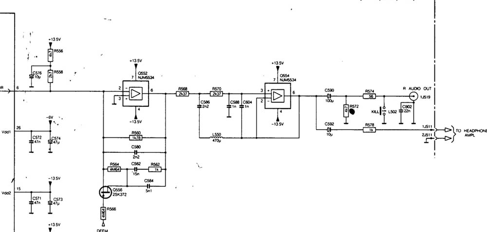

DOS output stage
Guys
I want to move my DOS (based on Ray's design on the cd63/67 thread) into my CD960.
The 63 has a voltage output DAC and the DOS attaches straight to it.
I believe I need more gain from the I/V stage (1st opamp) in order to drive directly into the DOS.
Can anybody see what I need to do to get a little bit more from the 1st stage?
I'd really appreciate any help. I don't need specific values, just know which ones to change! 😕
Cheers Ian

If I remember... Note the CD63 is dual output, Ray's DOS uses a long tail pair to use the difference between the two signals, so I think one of the inputs needs grounding.
I would have thought the output of the first opamp circuit would be sufficient. If not, increase the resistance R560. Vout = -(Rf x Iin).
However, that would mess up your deemphasis circuit - if you're bothered. I wouldn't be. I don't think deemphasis in CDs is very common.

philpoole said:If I remember... Note the CD63 is dual output, Ray's DOS uses a long tail pair to use the difference between the two signals, so I think one of the inputs needs grounding.
Yep I'll need to ground one of the inputs (should have put that in the question). 😉
philpoole said:I would have thought the output of the first opamp circuit would be sufficient. If not, increase the resistance R560. Vout = -(Rf x Iin).
I thought about R560 but worked on it the wrong way round, lowering the value not raising it. Basic ohms law! I should have known better!
philpoole said:However, that would mess up your deemphasis circuit - if you're bothered. I wouldn't be. I don't think deemphasis in CDs is very common.
I'm sure i've also read that its not so important on CD players. What are the side effects of changing it? 😕

Deemphasis. Well it looks like a treble boost - ish. It won't boost the treble as much as before essentially (the main feedback loop will provide a larger output, so the relative increase of the deemphasis circuit will be less).
Let me know if it makes a difference - good or bad. I'd ideally prefer to do 680pF rather than this (possibly too much), but it hasn't harmed anything from what I've heard.

Wrong way round, Phil.
Early CDs had treble emphasis (like tapes) and it was necessary to apply de-emphasis - treble cut - in playback. Modern CDs do not generally have treble emphasis. The FET Q556 can be removed with no real bad effects.

The second opamp Q554 is a unity gain differential stage. I would try the inputs to the DOS where the opamp +- are. They might need swapping.
This would retain the filter although the frequencies may change a bit.

Poynton, you're right.
That teaches me to talk about a circuit I saw an hour before that was not in front of me at the time. To correct what I was thinking: the caps in the feedback loop alow higher frequencies to pass, but (the bit I was dumb and forgot about) of course this is subtracted from the signal - 'cos its negative feedback, hence a treble cut.

Just spotted that second op amp (I have the document open this time 🙂 ). A fourth order filter on one opamp. Would you not have better performance if you had two second order filters, e.g 2 sallen-key or linkwitz-riley filters? I suppose it depends on what kind of filter characteristic you want, and there's one less opamp in the signal path (which has added appeal to the accountant).

AND, what is C802 for? Its a 22nF cap from the ground pin of the socket, to ground (in parallel to the ground wire from that pin).
Is it assuming some inductance in the ground trace or something?
I could understand a small cap from the signal to ground.
Maybe they had some budget spare from saving an opamp in the filtering stage? 😀

I've seen a capacitor like this before at the input ground.
Someone also raised it before on another thread - that was a Philips cdp, IIRC.
Safety earth? without forming a loop.
The I/V and filter setup is the same on most early Philips Marantz eg Marantz CD50, Philips cd350, and REVOX B226S
