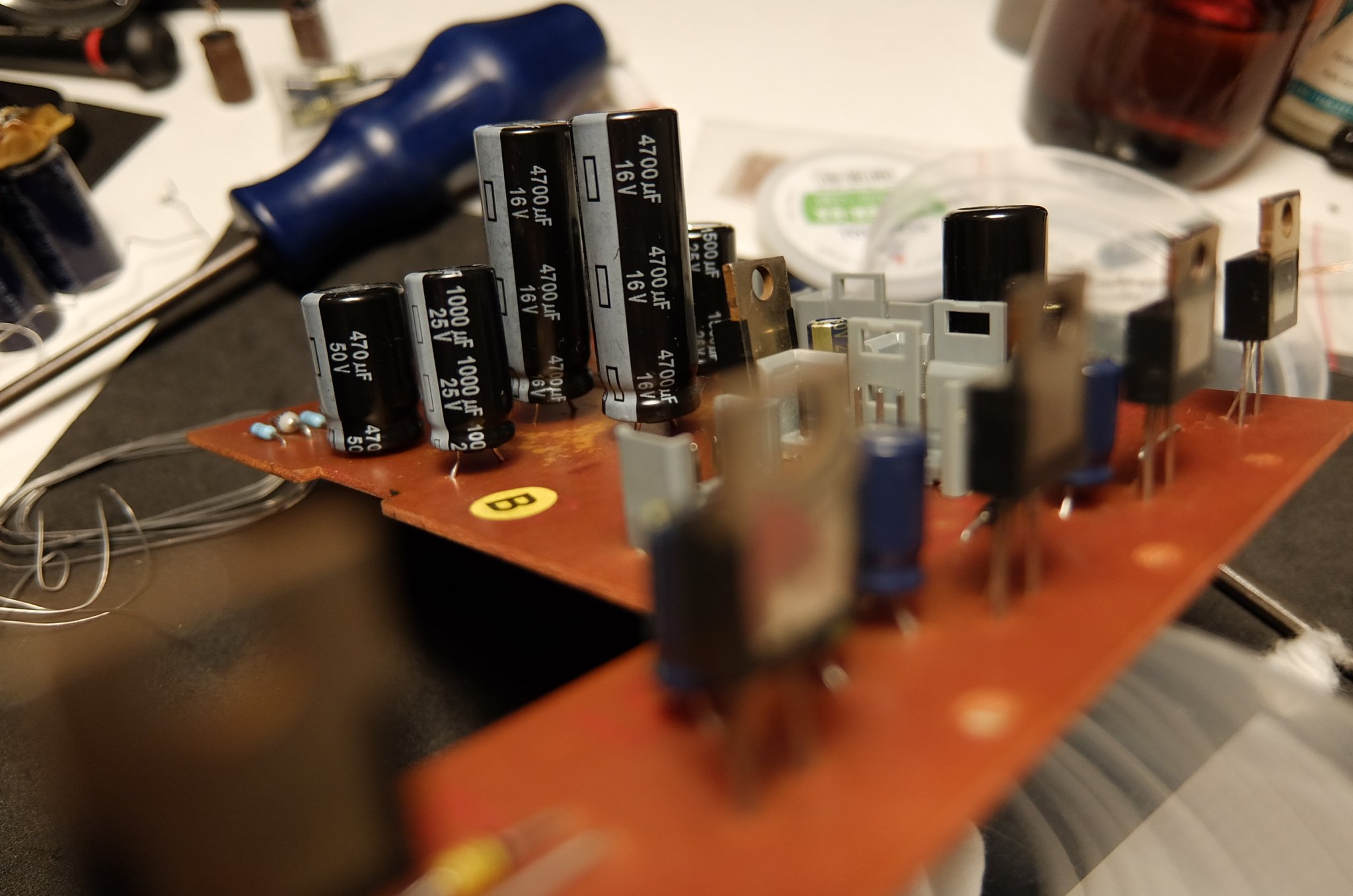

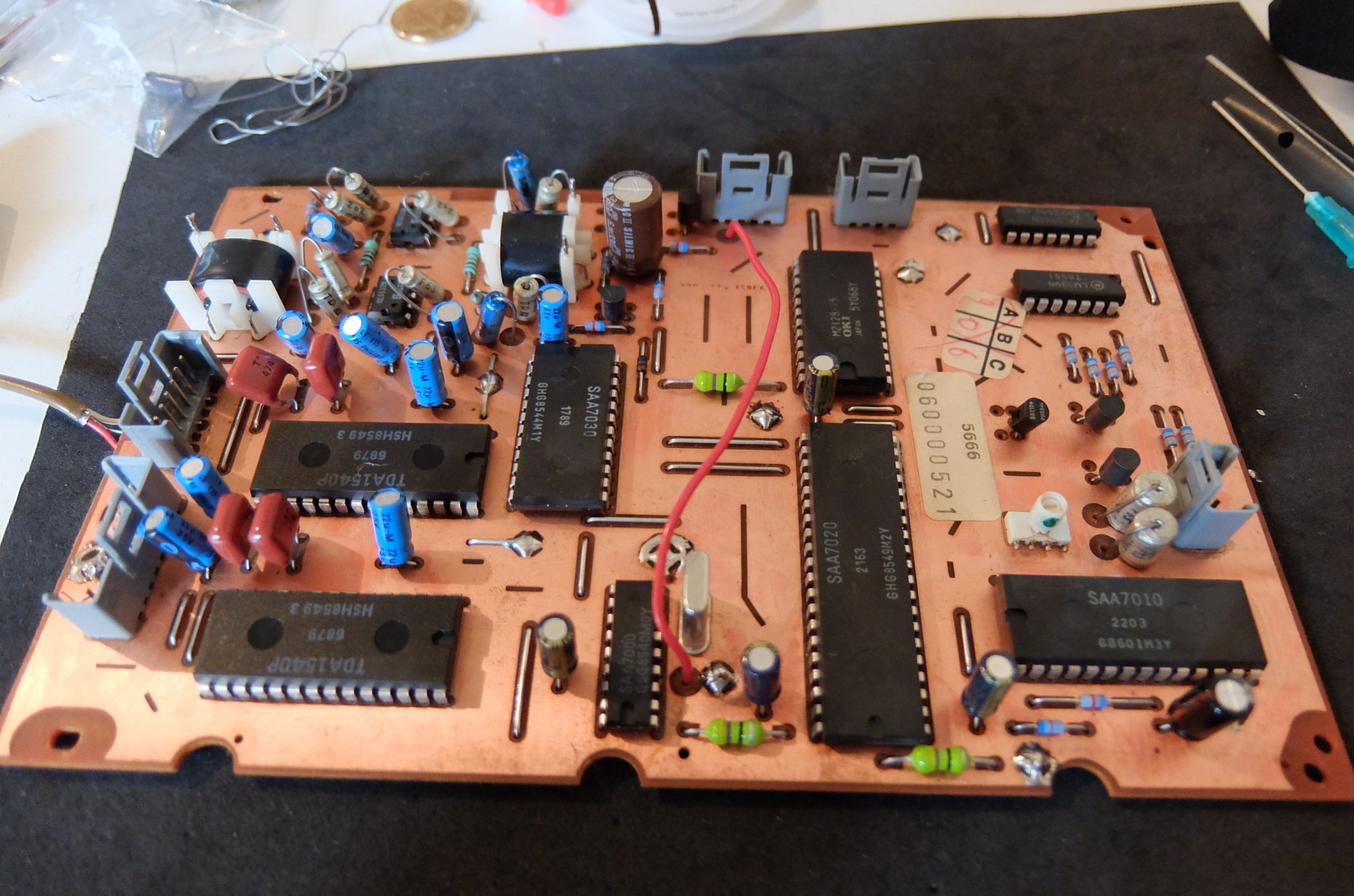

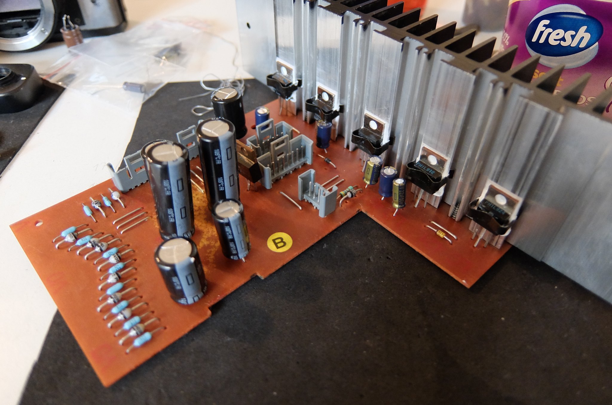

I've recapped the power supply board, replaced the 56nF in the feedback loop with 100nF wima mkt, checked the HF cable from the CD board to the Decoder board. replaced 4.7 mf bipolar on decoder board with 10mf , replaced all the logic caps on analog board. Resoldered some of the transistors and connectors...
still nothing, In fact I thnk I've made it worse, it powers up and the display sometimes lights all up and sometimes nothing at all, the laser arm sometimes moves out and sometimes in, and the motor sometimes spins fast and sometimes not at all. if I press play, sometimes, the focusing arm will move as it should and try to focus, but then the disc error appears...
I'm guessing there are some bad IC's or transistors, but I don't know how to narrow down the problem, since it's all over the place...

I'm currently working on a 304 silver that drives me crazy, everything works for like ~60min, power supply gets hot like hell, then the 7924 dies, and originally would take the 7918 with it. I've done that game now 2 times... luckily I was able to borrow a FLIR this weekend hoping to find the cause (most likely on the display board)...
