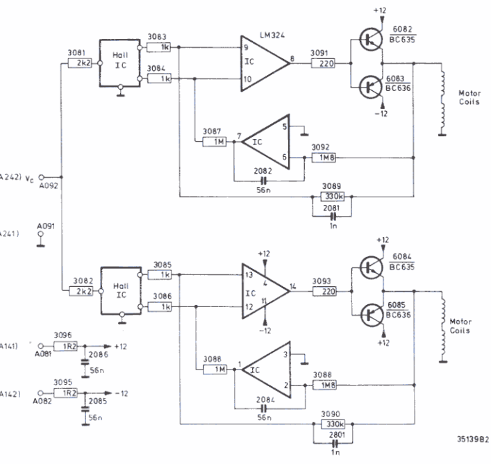

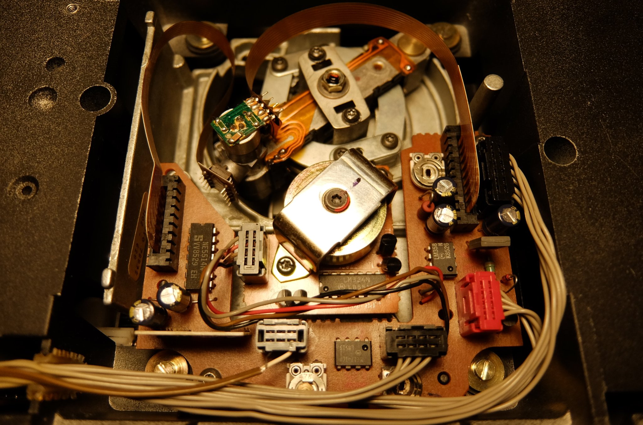

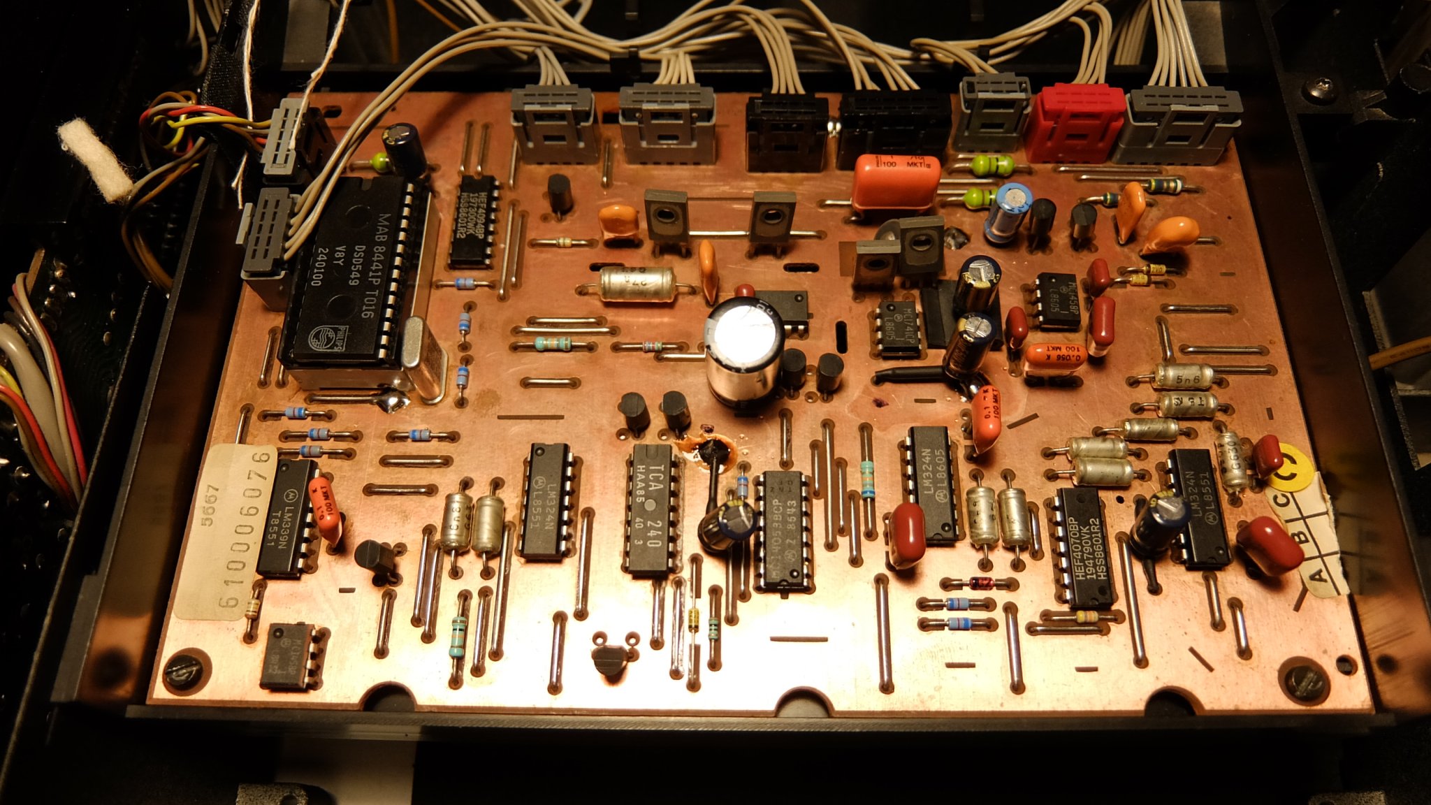

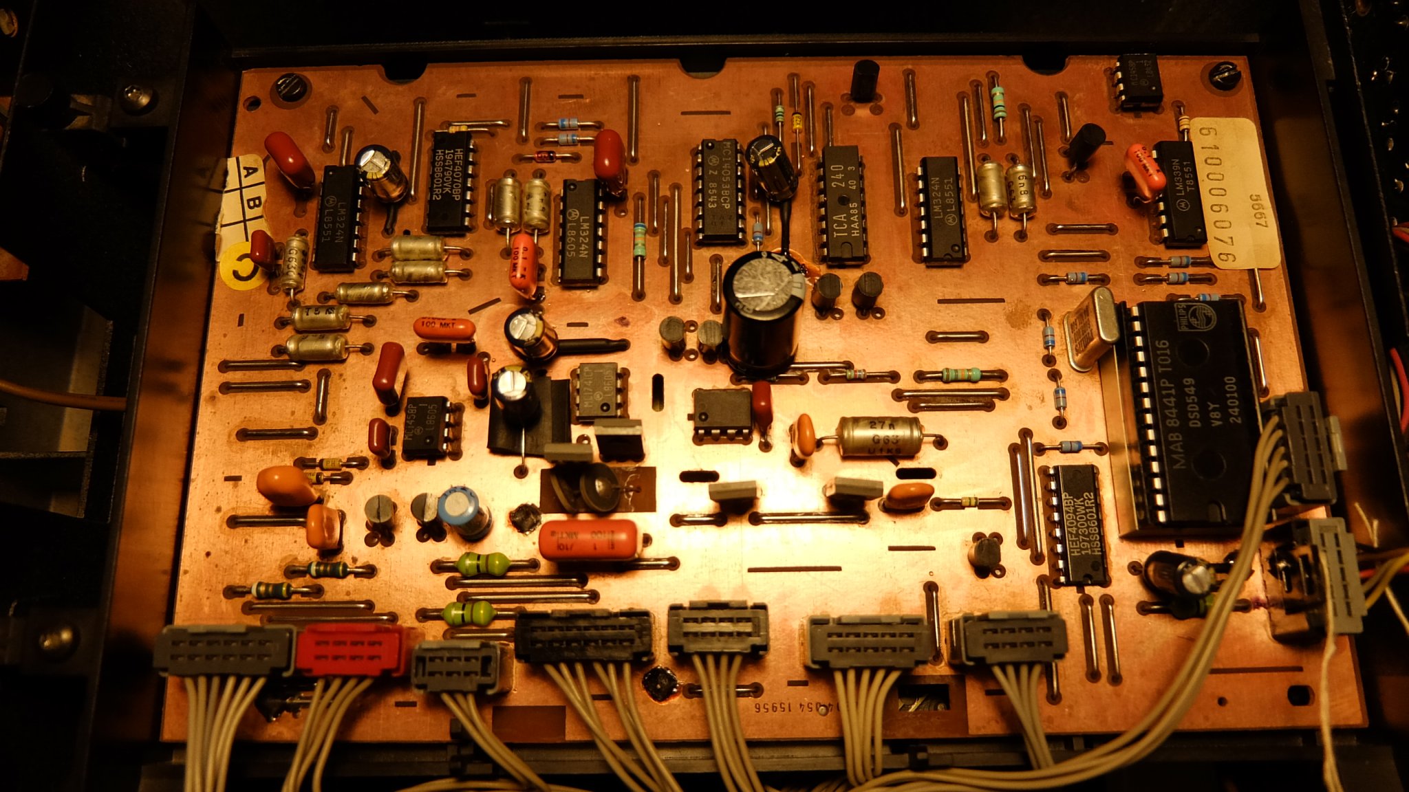

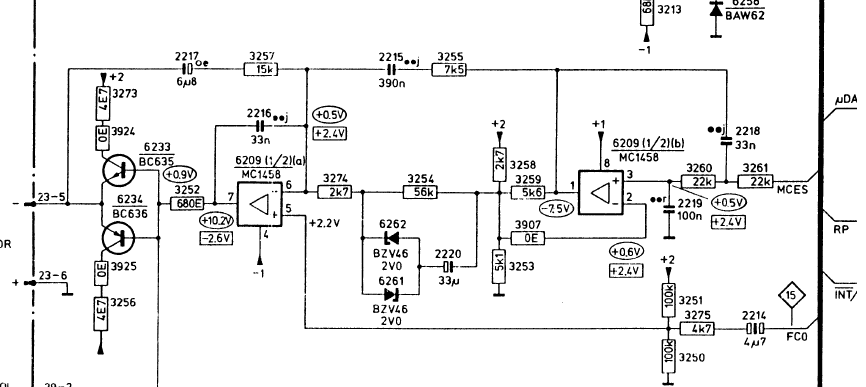

I've recapped the power supply board, replaced the 56nF in the feedback loop with 100nF wima mkt, checked the HF cable from the CD board to the Decoder board. replaced 4.7 mf bipolar on decoder board with 10mf , replaced all the logic caps on analog board. Resoldered some of the transistors and connectors...
still nothing, In fact I thnk I've made it worse, it powers up and the display sometimes lights all up and sometimes nothing at all, the laser arm sometimes moves out and sometimes in, and the motor sometimes spins fast and sometimes not at all. if I press play, sometimes, the focusing arm will move as it should and try to focus, but then the disc error appears...
I'm guessing there are some bad IC's or transistors, but I don't know how to narrow down the problem, since it's all over the place...

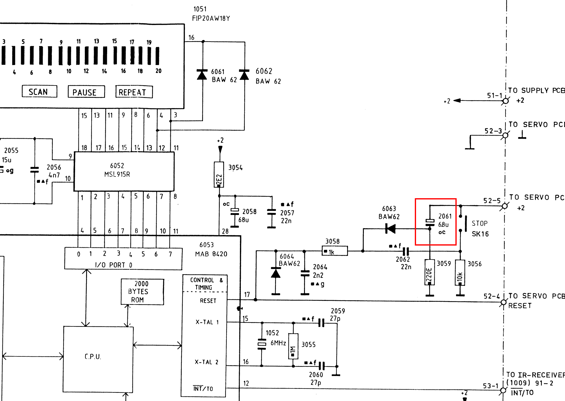

I'm currently working on a 304 silver that drives me crazy, everything works for like ~60min, power supply gets hot like hell, then the 7924 dies, and originally would take the 7918 with it. I've done that game now 2 times... luckily I was able to borrow a FLIR this weekend hoping to find the cause (most likely on the display board)...
I've gone more or less the same route like you, fixing all the obvious stuff didn't help at first, because there are so many parts that can go wrong in these units. But nevertheless, don't give up, once they are playing stable, they are wonderful CD players that have some very unique features. Never would I trade them for anything from a Japanese company (Sony, TEAC, etc.)
I have one perfectly working 304 (transplanted CDM0, originally CDM1), the mentioned silver 304 (CDM1) and a CD204 (CDM0), a very weird combination of CD104, CD304 and unique servo and decoder board layout (no SMD), that also is waiting to be fixed.
The later CDM4 players I have are rock solid compared to CDM0, CDM1 and CDM2.
I can fully recommend the CD602, CD6x4, CD6x8, CD620, CD624, CD630, CD634, CD820, CD830 and the CD850 family, they have the greatest VFDs of all CD players I know and run super stable once you fixed the CD clamp rotor unit.
You think display board is causing power supply problems? Hm, I didn't replace caps on my display board...
