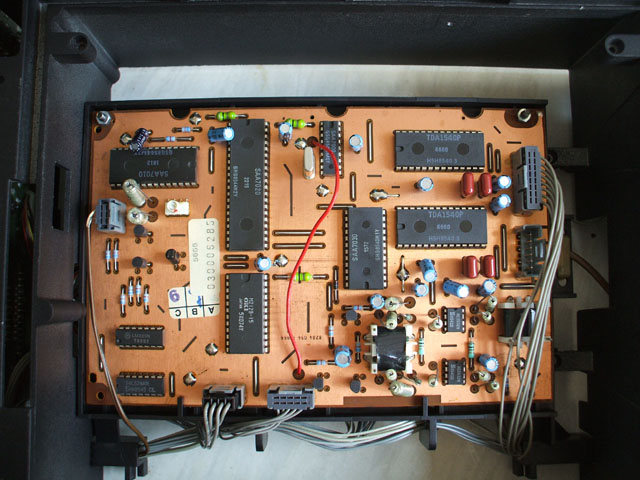

The CD7550 Decoder Board:

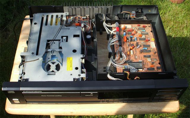

Top View of the CD7550 showing the servo/decoder board pair suspended in their plastic tray in the die cast chamber on the right hand side with the output phono assembly to the rear:
OK so as I see it there are 2 differences between the 7550 and the CD104 or CD304 MK1 :
1) Signal ground is decoupled from chassis ground by 2.2nf cap
2) From IAN01's excellent pictures I can see that the unit is more spread out. I guess the 7550 is 'standard width' whereas the 104 is Peter Walker 'standard width' 🙂 So the decoder and servo boards have a good air gap between them and the transport.
So mythbusters , does that account for the better sound of the Grundig ?
I would pretty much agree with your summing up jives11 but possibly add a third which is not so obvious from photographs but strikes you when actually looking at a CD7550 and a CD104 along side each other.
3) The CD7500's decoder and servo boards are actually completely contained within a die cast chamber which extends from the bottom to the top of the unit. So when the top and bottom panels are in place these boards are effectively completely shielded. There are just two cable entry slots carefully placed at the front and rear of the chamber.
This contrasts with the 104 which has the servo board pretty much exposed on the top and no rear section to the chamber leaving the back end of both boards exposed to the power supply pcb
Otherwise, the only other difference I can see is the power supply pcb itself, which is certainly different to the one fitted to the 104, but then as this is generally accepted to be based on the 304 Mk1 it may well be the same as that. I've never seen a 304 Mk 1 apart! The CD7550 has 5 regulators as opposed to the CD104's 4 regs.
Onnosr - I hope you don't mind the exploration of what might make the CD7550 different from the parent Philips machines. These are regarded by many as being sonically superior to their Philips counterparts as as such many CD104 owners have expressed an interest in exactly what the differences are and if those differences can be applied to the 104. I promised this thread some time back that the next time I took it apart I would take some detailed photographs and post them here.
I think it is generally accepted that the onboard electronics is identical, I believe that Philips actually owned Grundig during this period so it would be highly surprising if this was otherwise. Most people believe that the differences are more subtle, being down to layout and earthing arrangements. Mythology or fact ... we are simply trying to find out!
