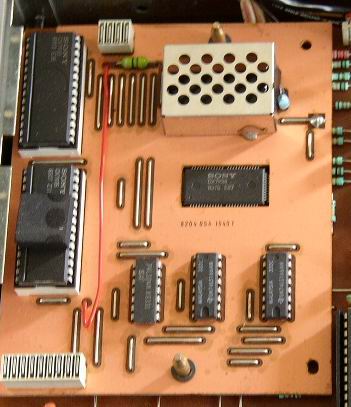

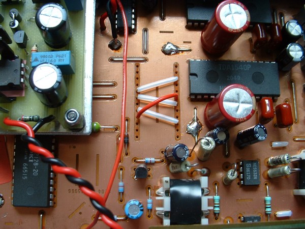

petronius said:Please help I have Philips CD 304 it similar like 104 and I am put in non os follow this picture now I have very distort sound did I miss something or what please help
Thanks😕![]()
Did you put the SAA 7000 in the 14 bit output mode by
putting pin 16 high ?
original in the 104 ( 304) the saa 7000 outputs in 16 bit mode.
You have to put the SAA7000 in 14 bit mode by disconnect pin 16 from ground and connect it to + 5 volt through a resistor of 1k
(FI to pin 18 = +5v)
The removed SAA 7020 takes 16 bit but outputs 14 bit and the TDA 1540p takes only 14 bit !!
Succes
Onno
I am rush when I was working for that and I am forgot to disconnect pin 16 to ground. Works fine now Thanks😎
