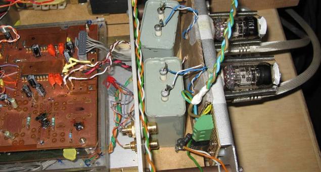

Hi All,
This thread has been lying dormant for a while and in a bid to resurrect some interest here is a pic of my recently completed valve output for a CD 304, note the opamp out removed and a SRPP 6N2P (see lampizator.eu) circuit added on an attached base, with nos dubilier 2.2uf capacitors.
As for the sound, to my ears it is more refined than a AD826 or OPA2134, this together with the NOS mod seems to have removed that HF grain.
I'm still playing with the I/V resistor, at the moment it's 20 Ohms.
I curious to hear what people are using as an output stage for the beloved TDA1540
Richard
Hi All,
Richard
