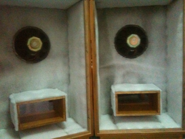

well the opening seem to just a opening (see pic.)
If i just build it this large and the bass is some what lacking? can i just plug the hole than? (the math thing on building is not my thing)
Thanks for this internal shot! If you can find out or approximate the duct's dimensions, it will then be easy to calculate or simulate what tuning frequency will result and if it is to your taste. If you want a lower tuning, reducing the vent cross-section area will do this. Still, I'm inclined to think that Philips knew what they were doing. I once built the recommended reflex for the 9710 and it was alright, but I'm pretty sure a big TQWT or Voigt is better.

Looks like the vent geometry will tune a ~83L box around 65Hz. Simulating with the above T/S parameters does not look good. Maybe the parameters are not right somewhere in that list? I know Philips built-in small midbass humps at times, but this is outright a peak, a large peak. A tuning aroud 30-35Hz produces a transfer function more similar to what I'm used to with Philips designs.

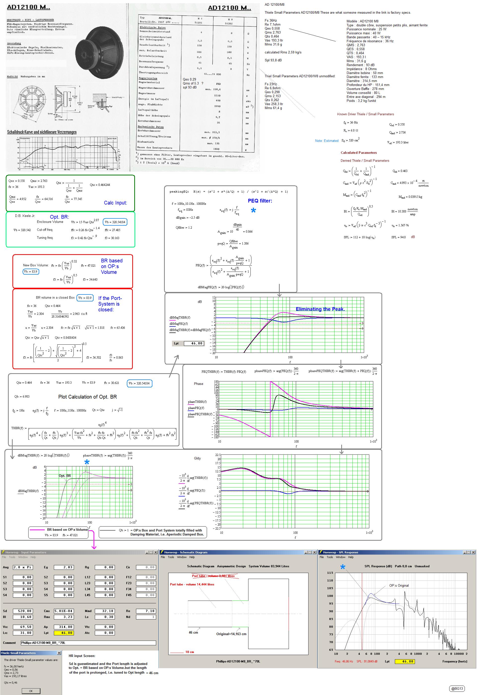

Hi Xerxes,
You may already seen that the optimal volume for those Drivers are around 320L in a ported Box with maximally flat FR and low extension (~30 Hz).
But when starting using your Volume of ~ 84 L: An improvement would be to increase the Port length to ~46 cm where the maximal BW is reached... but still with an existing peak.
You can EQ this Peak as shown: Then a flat FR would reach down to f-3dB, about ~50 Hz. Comparing this performance with: If you close the Port instead: You would end up with an f-3dB about ~56.5Hz and a Qtc of ~0.8 so maybe this is a better option.
If you fill the center of the volume with damping Material ~200g and fill the open Port too, the Box changes into an Aperiodic System with an f-3dB=~80 Hz but this method is not as good as making a closed Box or increasing the Port length +EQ.
I think it would be much better to design a new pair of Boxes outlined like single folded TL's.
A TL would probably would use a few more liters and could easily have an smoother FR extension surpassing the before mentioned BR designs with a great SQ. In the early seventies I built quite a few using the AD12100-M4 driver that also sounded very good.

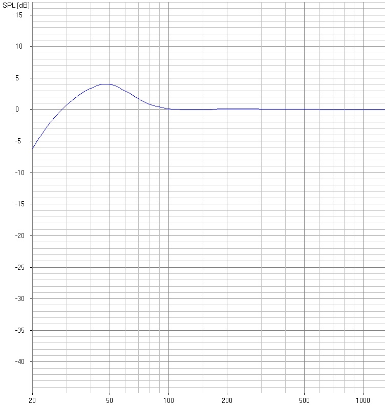

If you want to run the AD12100/m8 alone and want the most bass out of it (and you don't want an extreme big cabinet) you would have to put it in a 80 liter ported cabinet tuned to 37hz. Then, in addition we add a 12db/oct highpass to the AD12100/M8. The high-pass will be C= 1000uf and L=22mh (approx 1,5ohm). The highpass wil give a broad bump between 45-65hz (see image for the electric response of the circuit).
This is the solution I might want to use for my AD12100/M8's
The best solution though would be to use a seperate 12" woofer like the AD12100/W8 or the successor the AD12200/W8.
