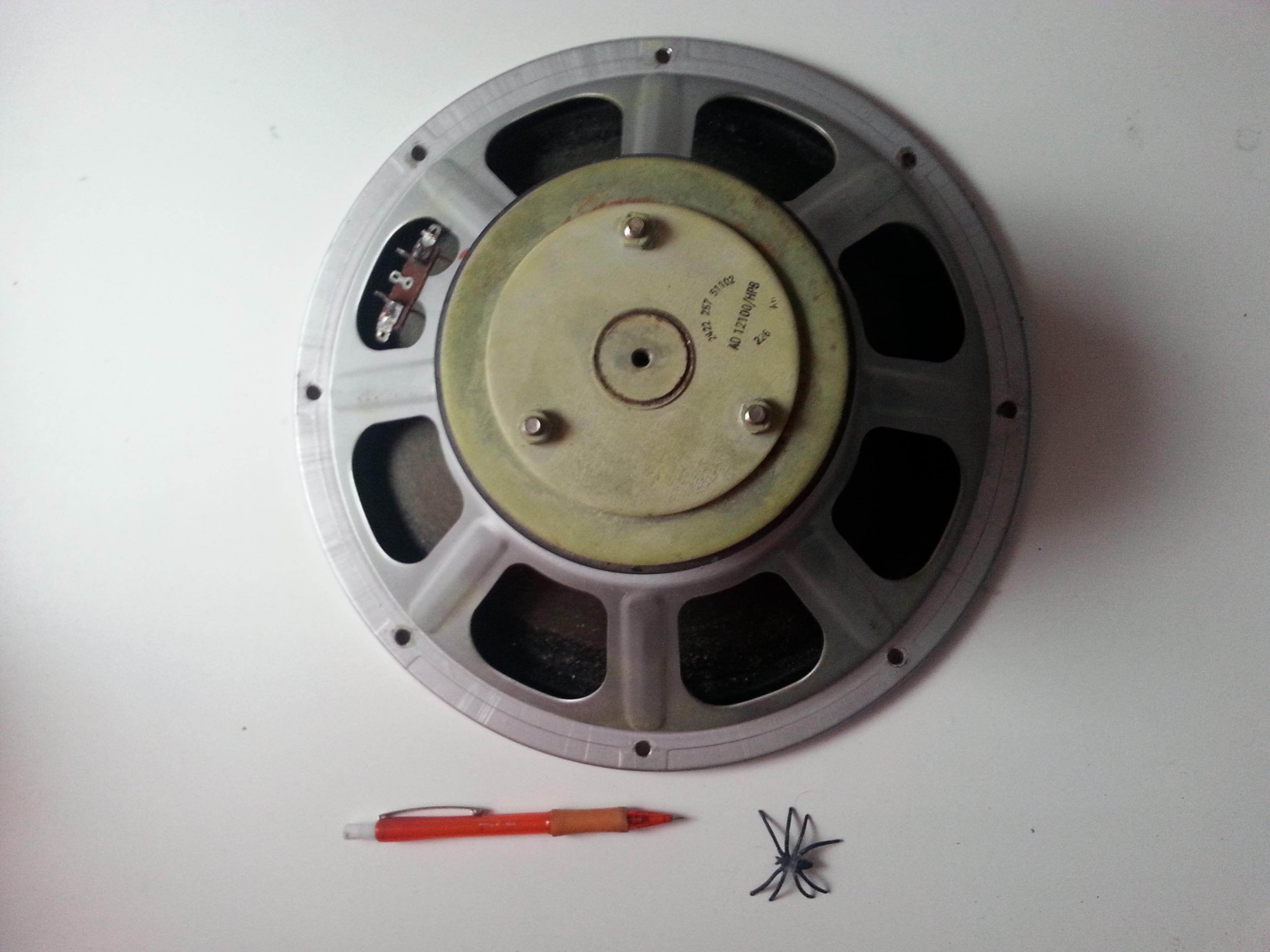

Guys, so where is the real resonance frequency - like Philips says at 45Hz or 36Hz? I have AD 12100 M4 version and I'm trying to make a case for them, but I'm confused with the lack of realistic T-S parameters anywhere.

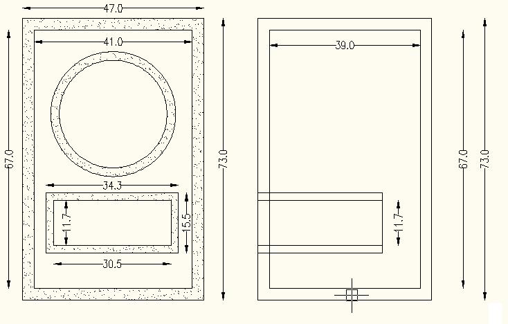

I tried few test cases, one 120 liter BR, one 60 liter BR, one 60 liter closed and still have no clue what to make finally. Any advices?

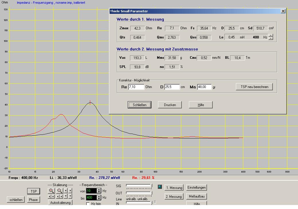

Well, Philips says it's 45hz but I measure 36hz. The driver is allready more then 20 years old.....this will soften the suspension.
The measured TSP's are realistic and you can use them to calculate enclosures.
The m4 version will only have a different impedance (4ohms)

btw: I found another plan on which is a bit different from Xerxes75
If it's not the Monitor 12 what other designs are there?

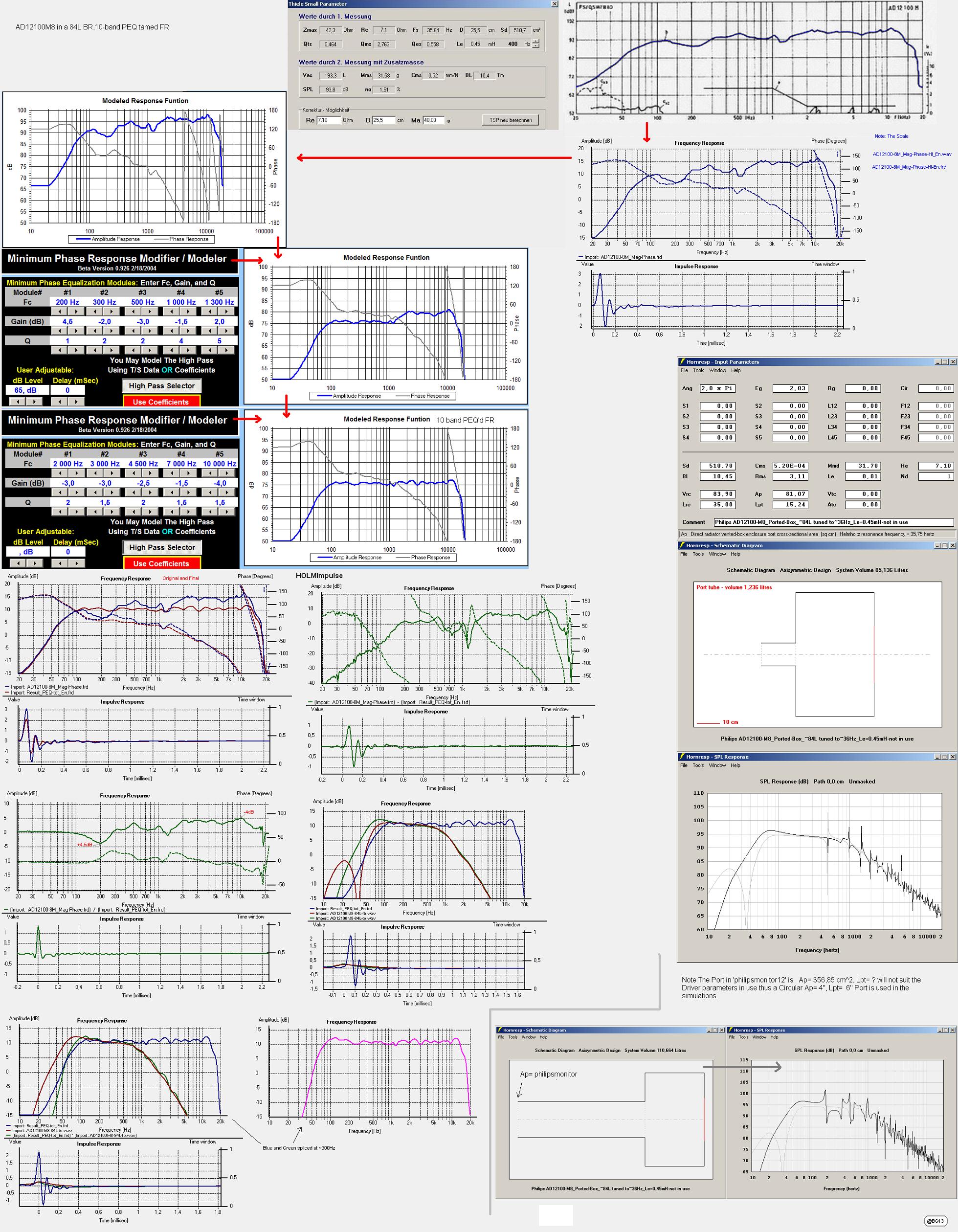

Thanks for all the graphs.
I will assume my set works like that as well instead of measuring it(as I'm not clued up on all that), just to start playing around.
Just to see if I understand these M8 measurements correctly....
If you were to use yours(ad12100 m8 as per the freq response graphs in this thread) in a simple OB and cross over the AD12100 M8 at some point in the higher frequencies to a suitable tweeter, say HE super tweeter...
What would you do/ where would you cross ? (10K ?) and if so, how would you do that ? a single cap or ?
The reason why I ask, is cause I'm really happy with my M8 as a single driver in JELABS ob ,,,,really just to get rid of the sharp / harsh high frequencies at higher volume(which is my experience with the M8 on a JE LABS OB )....

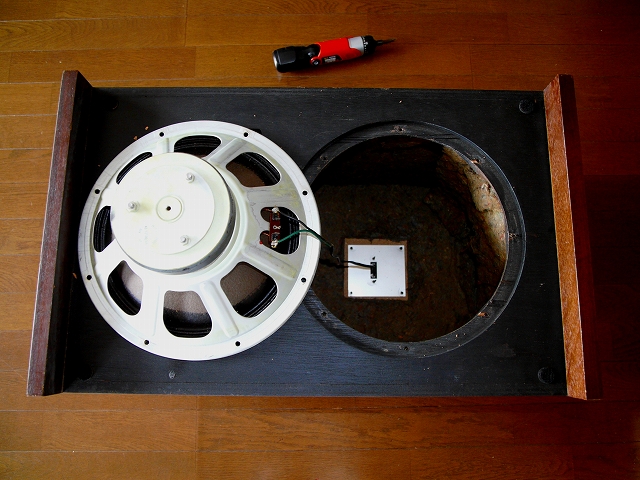

Is not the bass very loose in such a large cabinet? When I listen to my 12100/HP I think it is more of a midbass speaker suitable for a similar enclosure as a JBL 2202H. I will make a 47L and switch between JBL 2202H and the Philips. They will enforce the midbass section in my compression driver horn system.

Wow Norelco, your cabinet looks a lot larger than the original.

I have philips 12100/m8 drivers, but 320l cab is to big,so i need something smoler like studio 12.Is someone build this cab,what is the SQ, and hoe low it goes.I saw dimensions of the cab,but there is no port lenght.
