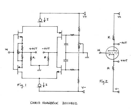

Glancing over Burkhard's analysis, I still must return to my point about this circuit, that if indeed it is a good unbalanced to balanced converter as is asserted, it should serve as a good balanced line driver. It does not, because there is a strong transmission term from the cathode to the anode, and a small one from anode to cathode. Folks, this is not something that should be conflated with the measurement of impedances.
In order to treat this circuit in a truly rigorous fashion one needs to really understand the theory of n-ports. To recall, in such analysis we don't even identify ports as inputs or outputs but treat them as ports that are loaded or not, driven or not. And when you add even just one port the amount of complexity goes up significantly. We have here a three-port, and our work is cut out for us. If I have the time I will work this out, but it is a job.
Now, the tendency for those of us who are familiar with simple circuits is to say Oh well it's obvious that this is the input, and that there will hardly be any effect if we stimulate this other terminals, and this terminal is clearly an output.... But there is some effect in each case.
Again I must remind: balanced does not mean equal and opposite voltages. It means equal impedances to common. In that sense a balanced line circuit is really a three-wire one. Driven separately as an external excitation, the Cathodyne has widely different impedances at plate and cathode. Jones misapplies feedback theory in the 3rd edition, and as pointed out by Paul, essentially contradicts himself within the space of a few pages. Stuart claims that drive with two identical polarity current sources is unequal loading (I haven't yet read the details, although I have the issue).
This all should not be that difficult. And all camps agree on the equal output voltage magnitudes under equal loading. The circuit behavior is not the issue under those conditions.

The "unbalanced" output impedance may not be a useful measure in this application but it certainly isn't meaningless. Moreover, it is what it is regardless of how the circuit is used.
Conceptually though, it's quite simple isn't it? Conceptually, and working in the small-signal domain, zero the input source(s) and connect a small-signal test current source to both outputs of the phase splitter. Label the one connected to the plate node Itp and the other Itk.
Then, the (phasor) voltage at the plate node is:
Vp = Zp * Itp + Zkp * Itk
where Zp is the impedance looking into the plate node and Zkp is the transfer impedance from cathode to plate.
Likewise, the voltage at the cathode node is:
Vk = Zk * Itk + Zpk * Itp
where Zk is the impedance looking into the cathode node and Zpk is the transfer impedance from plate to cathode.
Clearly, to directly measure Zp, Itk must be set to zero and to directly measure Zk, Itp must be set to zero.
In the special case that Itp = -Itk, the impedance seen at the plate node is:
Vp / Itp = Zp - Zkp
And, at the cathode node:
Vk / Itp = Zpk - Zk
These values may very well be equal, i.e., Zp - Zkp = Zpk - Zk but that doesn't imply that Zp and Zk are equal.
Besides, off the top of my head, I suspect that Zp and Zk are in fact useful measures in that they are related to the sensitivity of each node to unbalanced loads.
Demonstrating the sensitivity of the asymmetry of the cathodyne's outputs to measurement technique. I think we're *really really* ready for your earlier suggestion that we discuss common mode and differential mode impedances.
