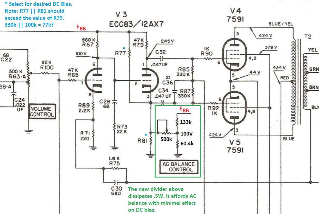

The 330k resistor does give us a more usable range of operation given the existence of the R83 pot. But it's like putting a band aide on a deep wound.
Let's forget the question of supply noise cancellation addressed in Post 1094 and address the need for AC balance. The right solution is to put the R83 pot in series with a large capacitor and a fixed limiting resistor. Tie the bottom of R81 to ground and select an appropriate value for it. Get rid of the 330K resistor. Now you have optimal bias, completely unaffected by the AC balance setting.
Having the AC balance affect the DC bias is a bad design practice.

They should not need a pot to get good AC balance and correct DC bias; a calculator would do the job more cheaply. The extra (330k) resistor may be unavoidable given a low supply rail voltage. What they should have done is have the 330k feeding the cathode resistor (as they have) but then put 330k in parallel with the anode resistor (equal in value to the cathode resistor). Then both cathode and anode see 330K in parallel with the load resistor, so AC balance is guaranteed with nothing to adjust. Scrap the pot.

The purpose for the pot is not to ensure a balanced output on the cathodyne, it is to make it possible to purposely introduce imbalance to compensate for gain imbalances in the output tubes. Proper adjustment procedure (according to the service manual) is to connect the amplifier to a distortion analyzer and adjust the AC balance pot for minimum distortion. It is a system-level design choice, but definitely not a user-friendly design choice.

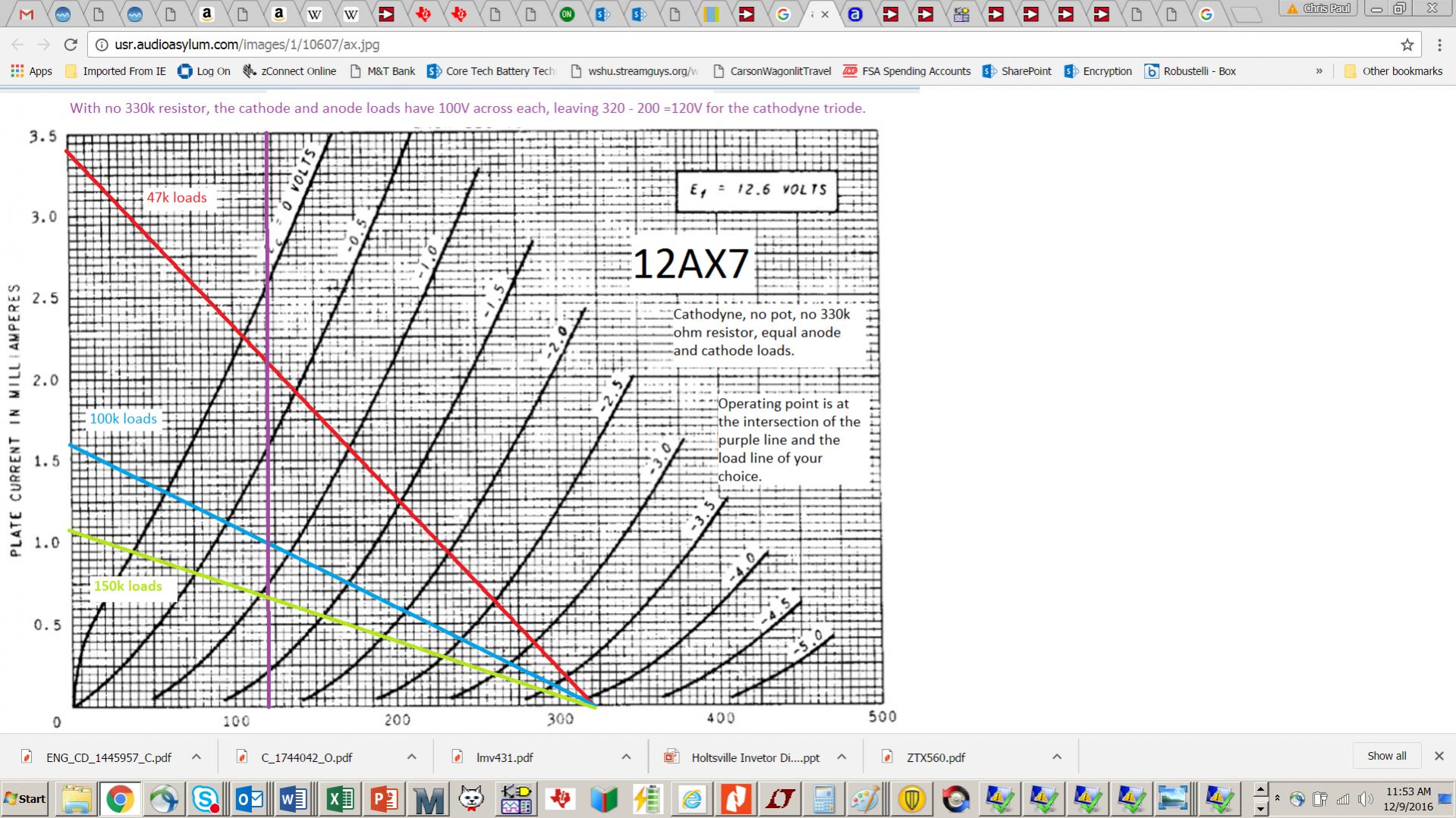

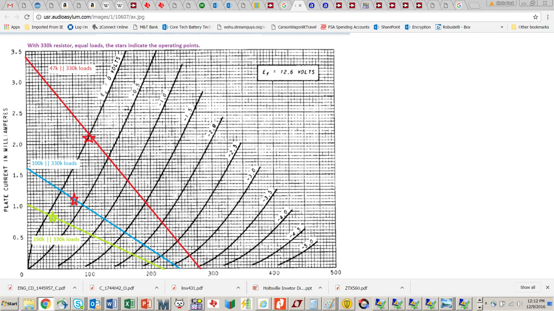

And DF96 & SpreadSpectrum, check out the two sets of operating points, one with and one without the 330k resistor, both with identical plate and cathode loads.
DF96's proposal with matched plate and cathode loads: Leaving the 330k resistor makes matters worse!

Here's what I get for the load lines with and without the 330K resistor and the operating points at the extreme settings of R83. Unless I miscalculated, a good portion of the pot range will lead to grid current being drawn. And in comparison to the pot settings, the effects of the 330k resistor seem small.

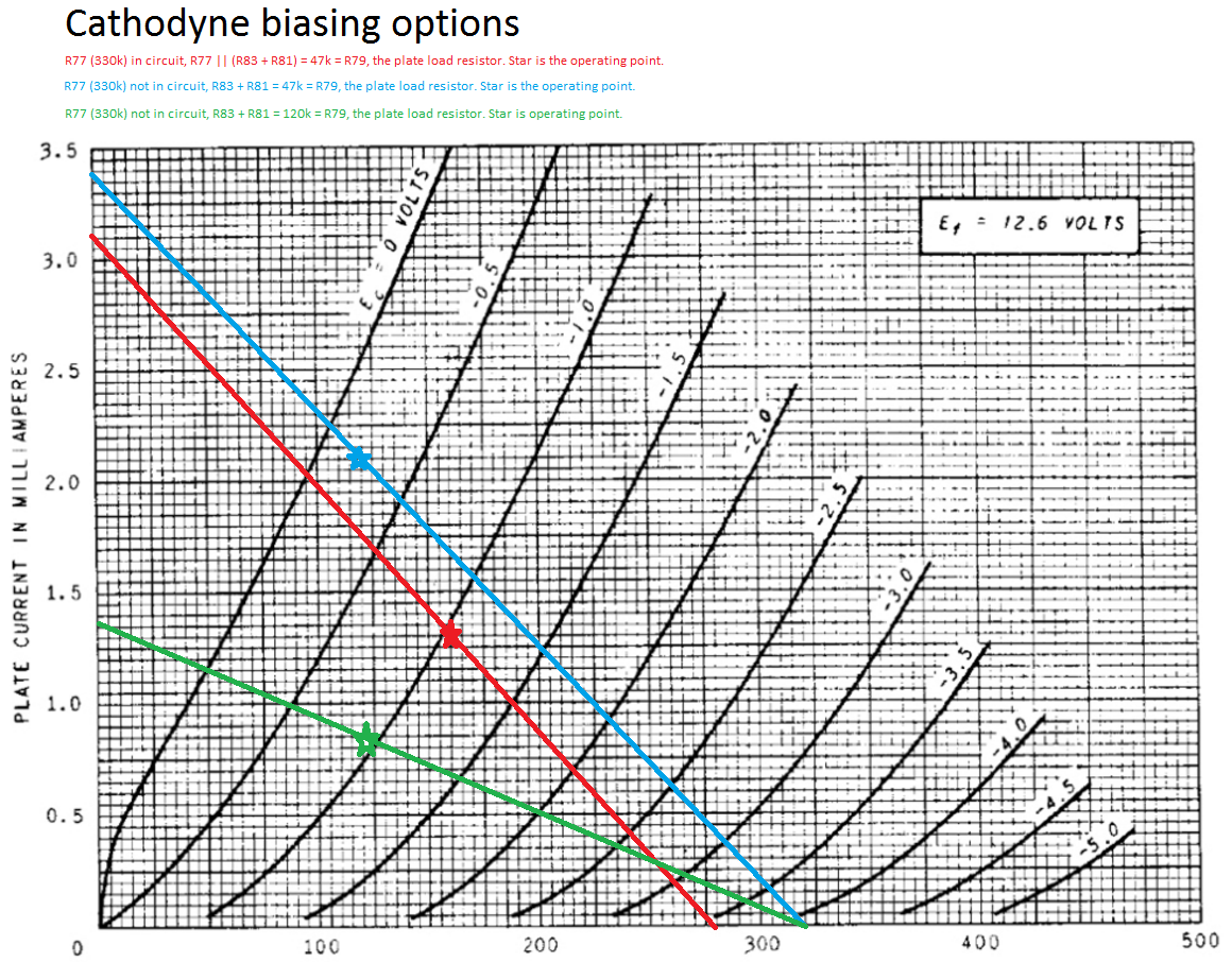

CPaul's graphic in post #1174 seems to show graphically that adding the 330k resistor shifts the idle conditions to a more negative range as well.

Curiously, I removed the 330k resistor in my amp and got rid of the AC balance pot and just put two 47k resistors on the cathodyne and it really doesn't sound bad (sounds quite nice, actually). However, I think it is probable that my +320V rail is running higher than nominal, so that may be why I don't have problems (or maybe I do have problems and I just don't turn it up enough to find out). The 7591 output tubes really don't require much swing to drive to clipping.

They say it takes a big man to admit he made a mistake. Well, I'm feeling pretty large right now. Please ignore post 1186.
Let me try again.
The setting of R83 has a big effect on the circuit. So when we analyze the Cathodyne, what shall we set it to? Well, to its average value. So what is that?
On average, the output stage is balanced - its weaker and stronger sides could be driven by either the Cathodyne's plate or cathode. So, let's always adjust R83 for equal and opposite cathodyne outputs - that is, ensure that the parallel combination of R77 (the 330k resistor) and the R83 pot + R81, is always equal to R79, the plate load resistor.
Looking the graph, the 330k resistor does indeed improve and make the grid bias more negative (red line and star operating point) than if the 330k were absent (blue line and star.)
However, the same grid voltage bias could be arrived at without the 330k R77 if the plate resistor R79 and (R83 + R81) were set to 120k.
