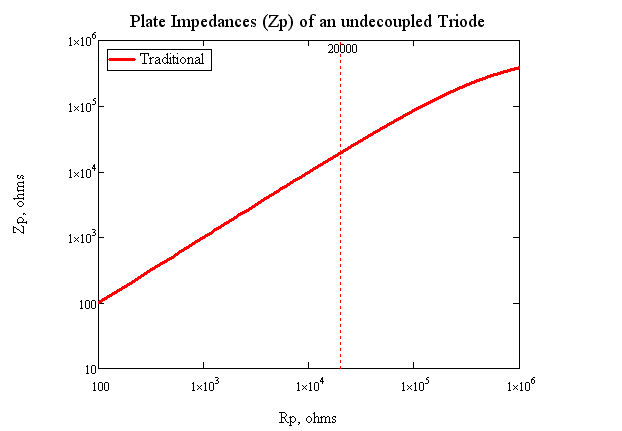

If you peruse articles or books from over the past 80 years on the topic of triodes, over and over again you’re going find the same expression for the impedance looking into the plate of an un(cathode-)bypassed triode: zp = rp + (1+µ)·Rk. This expression, which does not include the plate load, is in the Radiotron Designer’s Handbook, the Preisman paper on Cathodynes from 1960 (equation (1)), and even in books by that great Cathodyne Equal_Z’er, Morgan Jones. Note that where this equation appears, there is never any inference that it does not hold over the range of operation occupied by Cathodyne, where the plate load Rp is close or equal to that of the cathode, Rk. And yet…
It’s worthwhile to look at a graph of Zp = zp || Rp. We can call Zp the “Traditional” plate impedance. Let’s consider a circuit where rp = 3K, µ = 30 and Rk = 20K. We’ll vary the plate load resistor from well below to well above Rk. Note that nothing special happens when Rp = Rk = 20K.

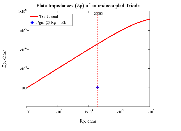

But the Equal_Z’ers will have none of this “nothing special happens” stuff. They claim that when Rp = Rk, the plate impedance is approximately 1/gm = rp/µ (100ohms in this case.) So I’ve shown this point on the graph below.

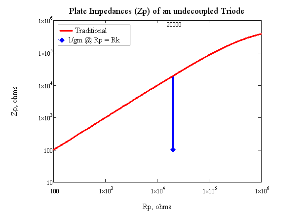

Here we see a sudden change by a factor of more than 100 from the Traditional value. Of course, this sudden and large change raises the question of the path the impedance followed to depart from and return to the Traditional curve. I can think of a few possibilities. Perhaps that value is held only when Rp precisely equals Rk:

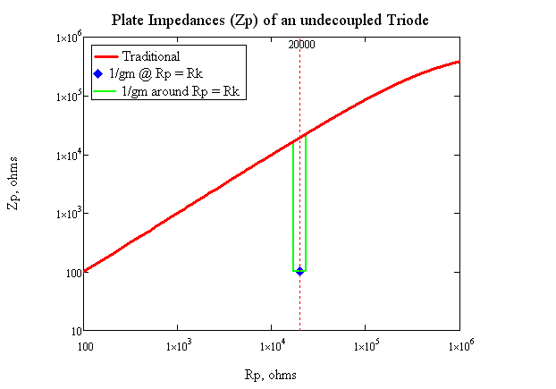

If so, to exhibit a 1/gm plate impedance, all real world Cdynes would have to have a perfect match between Rp and Rk. That is simply impossible. Maybe instead there is a region of finite width where the impedance 1/gm reigns:
But if so, how wide is this region?

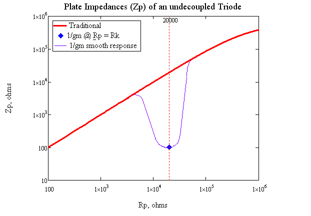

Or maybe the transitions shown above are too sharp, and they should be more gradual, something like the following:
Whichever of these is the case, or even if something different obtains, Equal_Z’ers should be asking themselves not, “What are the boundary conditions?” but rather, “Where are the boundaries?” so they can avoid them like the plague. Anywhere impedance changes by a factor of almost 200, there are bound to be gross non-linearities and distortions galore. I wouldn’t want any of my circuits operating anywhere near these changes. But to avoid them, I’d have to know where they are.
Any of you Equal_Z’ers want to tell the rest of us where the boundaries are?
