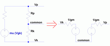

Most likely, he was misled by the Cathodyne model containing a pair of ground referenced, differential voltage sources in series with 1/gm (see Model 1 in subsequent sims). In accordance with that model, each LCR module, to meet its spec, requires its source to be padded so as to be driven from a total impedance of 6Kohms. But this requires the voltage-balanced (and not impedance-balanced) Cathodyne that we all know and love to be redesigned (see italics below). You don’t get something for nothing, and a consequence of the redesign was to unbalance the overall gains in the plate and cathode paths and lose, worst case, 1.7dB of RIAA accuracy at 20Hz in the plate path. Was that demand necessary or even desirable?
No. On both counts.
Remove the ground between the voltage sources in Model 1 to get Model 2 (see the sims again.). The combination of two LCR inputs in series is quite happy to be driven from this 12K impedance source. Can the traditional Cathodyne be looked at in this manner? It sure can! Take a look at sims of the Cathodyne and the two models shown below. You’ll see that the responses of the plate and cathode in all three circuits are identical.
But now we face a conundrum. We know that both models perfectly and identically predict the Cathodyne output responses. But one states that the plate and cathode to ground impedances are about 1/gm, and the other that they are about Z/2 (where Z is the load seen looking out of the plate or the cathode.) So which is the correct model? We can’t tell from the available evidence. Our only option is to perform more tests.
Let’s measure the ground-referenced plate and cathode impedances in the Cathodyne and the two models. What better way is there to do that than by zeroing the ac grid voltage, connecting a ground-referenced ac current source to the plate, dividing the ac plate voltage by the current source’s current to get the plate impedance, and then repeating the process at the cathode? (This is not a rhetorical question. If you think you have a better way, let us in on it and justify your claim.) The results can be seen in the two sims below.
Clearly, neither of the models’ responses matches those of the Cathodyne. Nor do they match each other’s. If the only choice in predicting these impedances were one of the two models, we’d have no justification for preferring one over the other. But there is another possibility: both models are wrong! And that’s the conclusion fits the data.
So we now see the practical, real world consequence of accepting a bad model of the Cathodyne, even when we’re only dealing with the balanced situation to which it is supposedly perfectly suited. An unnecessary requirement is added to the design, resulting in a product that performed so badly that nobody wanted it!
We’d all do well to understand from these sims how the Cathodyne really works. Get these models out of your head! If you don’t, they could bite you when you least expect it. Just ask Dave and his company.
And yes, the Cathodyne sim reveals, of course, that its plate and cathode impedances are indeed different.
To go from a balanced voltage Cathodyne to a balanced impedance Cathodyne, change R41 to 682ohms and R29 to 6190ohms in all three sims. In the first sim, it is easiest to see the slightly imperfect RIAA match if you plot V(cath_out_+)*.709 and V(cath_out_-)*1.019. In the last two sims, to see identical 6K source impedances driving the 6.3K (above 300Hz) LCR module input impedance, move the Cathodyne current source outputs to the junctions of R41 and L5 and of R29 and L7. If you instead leave R41 and R29 with the original matched values, you’ll see different impedances at these nodes.

In two recent posts (730 and 825), we have seen how sometimes even matched loads can contradict that popular model of the Cathodyne shown below.
And there are other problems with that model. It is claimed that in simultaneously grounding the (P)late and (K)athode (see the first sim below), the resulting short circuit currents can be used to determine the ground-referenced P and K impedances. Is this so? Well, to measure any impedance, current must flow through it so that the voltage arising across it can be divided by that current. If no current flows, the impedance can’t be measured. Is there any current flowing through ground that is available to either the P or K impedances? Let’s take a look at the following sims and see.
In the first sim, 1 milliohm resistor has been inserted between the ground and the shorted plate and cathode capacitors so that the current into and out of ground can be measured. And although the P and K currents are substantial, equal and opposite, the ground current is exactly zero. In fact, the second sim shows that the ground can be completely disconnected from the shorted plate and cathode with absolutely no change in the currents in the circuit!
There is no ground current. So there is no current available to test the P and K-to-ground impedances. This circuit has no business making any claims about them.
In light of this, how would those of you who say that a balanced Cathodyne must be kept balanced (to measure any of its characteristics) measure its ground-referenced P & K resistances?

So answer the question – how would you do that?by ensuring it was measured in a way to not introduce currents through the ground node?
Perhaps you would be kind enough to point out a flaw in the following logic:
To measure an impedance, current must flow through the impedor so that the ratio of the voltage across to the current through it can be determined.
P and K-to-ground impedances are connected to ground.
If they are to be measured, current must flow through ground.
No current flows through ground in the previous circuit. Therefore it cannot be used to determine the impedances in question.
“suggests?” Because you are of the opinion that I am wrong, I must be wrong?every way that has been presented to prove unequal plate and cathode impedances has introduced current through the ground node which suggests to me you are not measuring the right thing.
You have to do better than that, Dave. Prove me wrong. Pinpoint where I am wrong. If I really am, you should have no problem doing so. But if you can’t...
