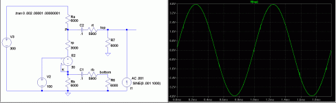

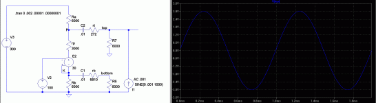

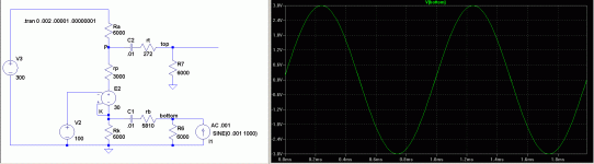

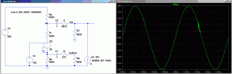

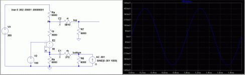

Dave, I put together your requirements from posts 748 and 759:
However, as you can see in the simulations, to accomplish this, the values of rt and rb (your ?1 and ?2) are very different. Now, if the plate and cathode impedances were the same, you’d think rt and rb would be the same. And yet they are not. Well, maybe we just have to swap the places of rt and rb in the circuit to get the same results. Let’s try it:
Nowhere near your requirements. Well, what if we assumed that the triode/Rp/Rk part of the circuit presented a 2/gm impedance and we just had to “build out” rt = rb = 6000 – 1/gm? Let’s try that:
The cathode driven load is close, but the plate driven one is not.
I don’t see how we can escape the conclusion that the Cathodyne P and K to ground impedances are quite different.
“It is also required that the 6K LCR be driven from exactly a 6K source.”
“I also want to mention that the ideal 6K LCR is a constant impedance "T" network that provides a 6K load to the source independent of what happens behind it.”
I’m testing the circuit which meets your requirements by setting the AC grid voltage to zero and inserting a 1mA 1KHz AC current source between ground and the plate to test the total plate to ground impedance, and subsequently between the cathode and ground to test the total cathode to ground impedance. Since the LCR presents a 6Kohm constant impedance to the circuit, the resulting voltages across the current sources had better be the parallel combination of the 6K driving impedance and the 6K load, which must be 3K, and both are:
