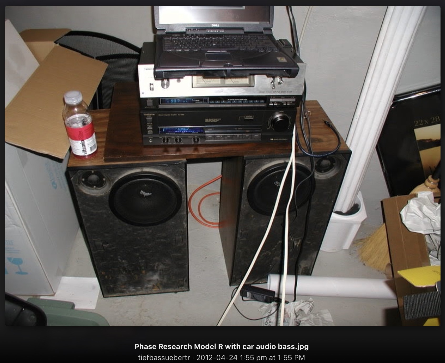

Blast from the past! Those were my Phase Research Model Rs with the auto sound woofers. What a funny surprise. 😀
My uncle purchased them in the late 70s and gave them to me much later. He put those woofers in them. I used them in my college dorm rooms in the 90s, moved them to FL and back in the early 2000s, and discarded them over 10 years ago. I think that picture was from my basement in a previous house around 2007. I recall the tweeters were something special and the bass was surprising. Those Rockford fosgate woofers were not very good in the mids. Built-in smiley face response! 😀
Phil Clements and Phase Research had nothing to do with Bob Carver or Phase Linear, if I recall correctly. Just similar buzzwords.

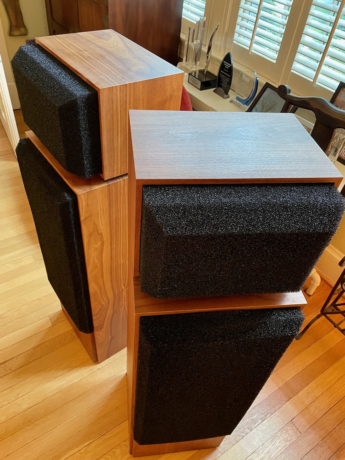

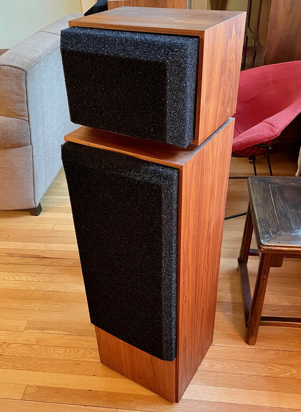

this company is the right contact address therefore - unfortunately his website is dead since approximately two years, but on webarchive still available:I am looking for a pair new dust cover (foam covering) for this loudspeaker.
There are a wide range of such materials available, but how can I find out, what is the best suited for this application?
Maybe this?
MyCaseBuilder - How to Choose the Right Custom Foam
Also I'm looking for material for sound insulation on the baffle, which also consists of a kind of foam.

an image as example I have upload here (first both attachments) - found under
https://www.hometheaterforum.com/co...speaker-company-called-phase-research.168036/
