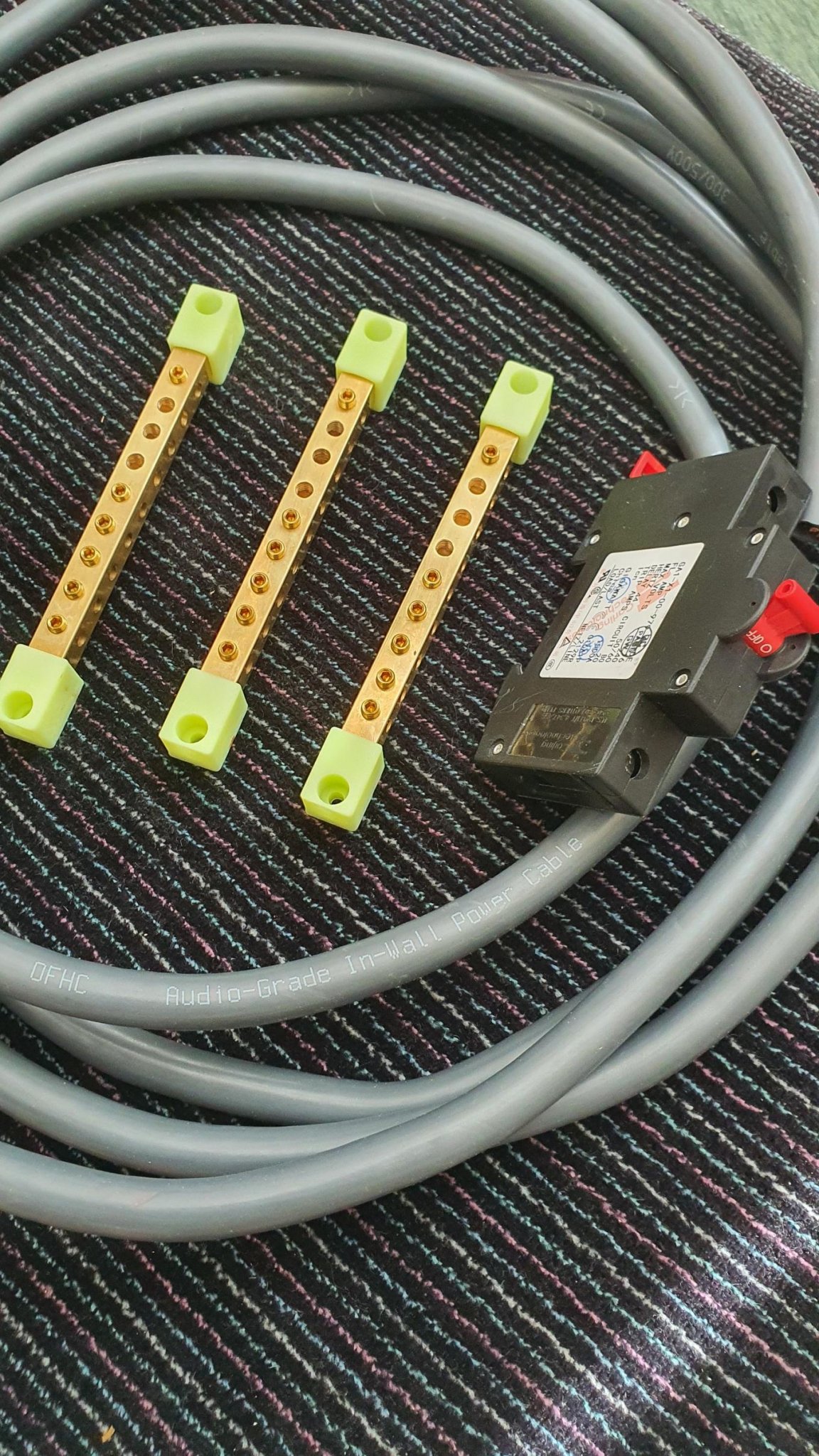

A lot of the grounding issues in power network is solved by star grounding and wiring in general. I had my electrician recently install me a dedicated line for audio in listening room, and i made 4n copper bus bars, which was copper, silver then gold plated for star wiring. Works wonders.

Sorry Brijac but using bus bars and precious metals is not the solution for ground loops. It is IN the devices where things occur.
I would beg to differ. For example, sftp ethernet cable can introduce grounding issues, and that is not a device, but a wire with a connection to ground. There are multitude of grounding issues, and not all are IN the devices. You do seam to speak of absolutes most of the time, and sorry i don't find such posts relevant.
We are in a thread by the OP about his situation where the issue is obviously IN the devices. You may find my posts irrelevant but so is the use of silver and gold in mains busbars 🙂 You also spoke of "power network" which now of a sudden is "LAN network".
We are in a thread by the OP about his situation. You may find my posts irrelevant but so is the use of silver and gold in mains busbars.
If i read the title correctly, it is starting with HOUSE wiring and avoiding ground loops there. You're a moderator, and yet you try to prove some point on a side note of my main post which is star wiring. Try to relax, drink some tea, and be more down to earth.
And yes, using precious metals is great for that due to copper oxidizing issues, and bus bars are usually placed somewhere where you can't access them easy and often.
Very down to earth here and I choose not to continue this useless discussion. I think I helped the OP solve his issues with adequate information and don't need anyone else's expertise on this as I simply solve issues like this myself.
