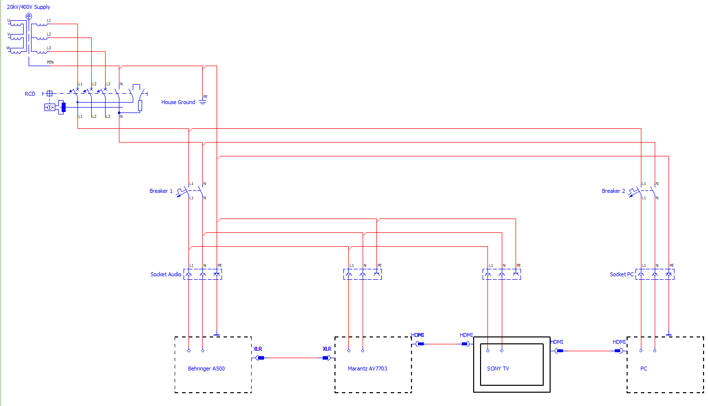

Impossible the PC is about 12m away from the audio equitment.Plug all your hi-fi equipment into the same power strip might help.
Rewiring your house might not.
Yes, the PC and the Amps have a grounded case.Rewiring the house is a solution like selling the car because you don't like the rims. Rewiring will not solve issues either.
You probably have more than 1 device with direct connection to PE. That is often the ground loop issue. The computer should have a direct connection to PE so this makes matters more difficult than with a dedicated audio player of sorts. From what you write the amplifier seemingly also has a direct connection to PE. Please investigate if what I write is true. When a cable tuner is used you have 3 PE connections one way or another. As direct connection of Audio GND to PE is internally done in devices ground loops are a consequence.
All my grounds are connected together in the breaker box.All components with AC power Protective Earth/Safety Ground wires should be connected together.
I have 60V Potential between the HDMI cable comming from the TV ground and the PC case.Problem is that devices often have Audio GND connected straight to PE. That is the issue. PE should be connected to metal casings etc. but the point is that Audio GND is also very often connected directly to PE. If this is the case with a few devices the direct connection between Audio GND and PE should be "lifted" like with a 10 Ohm 2W resistor except for 1 device which generally is the power amplifier. Metal casings always directly to PE, never change anything there!
Using a pc for audio poses a challenge as these must have a 3 pin IEC cable going to a 3 pin PE wall socket. OP will likely have no hum when disconnecting the pc's IEC cable as well.
Of course a simple test with just 1 source device that has a wall wart PSU and the amplifier is a good test to prove a ground loop is the reason for the hum. Making the setup smaller = understanding.
The Amps have a transformer and rectifier diodes, no SMPS.If your amplifier also has an SMPS we have a new challenge.

Which side would you recommend to lift the ground?Ground loop noise is a big problem in pro audio where I work. Yes, even with XLR.
Pin 1 lift is the first thing to try. If the shield is connected at only one end there is no current flow and no loop.
It’s easy and worth a try. Kinda surprised at ground loop noise in a balanced home system, though.
Good drawing! That 60V potential difference gives it away. I would not hot plug any HDMI connector in such a case. I see this often (even sparking connectors when plugging in/out) and it also can be solved quite simple but not now as I have to do other stuff.
I've had IEC filters cause ground currents, when we lost a bonding jumper the entire chassis floated up because of the hot to ground capacitor. Typically 1 or 2 milliamps through the ground, not enough to set off a GFCI.
Seems one of the two two prong devices may have capacitance to chassis and floats the chassis, including the HDMI.

There probably is the issue. The capacitance lifts GND.Seems one of the two two prong devices may have capacitance to chassis

The current definitly comes from the Amplifiers.Seems one of the two two prong devices may have capacitance to chassis and floats the chassis, including the HDMI.

But back to my problem, I would like to lift the chassis ground of my Amplifiers properly, like all the marantz stuff is Isolatet, I don't really get how they do that, since the chassis is copper plated metal, but there must be a way.
The thing is, if I get rid of the ground loop on the PC side, I still got the bad potential on the HDMI cable which is sometimes also a problem for the picturte, since it's HDMI 2.1, it's very sensitive.
