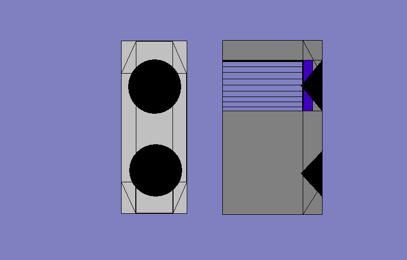

Scott:
Another concept featuring something along the line of what you mentioned:
I've decided I'd like to restrict it to a max driver size of 12". I prefer the slim-line look and a 15" doesn't meet the requirement, I could taper the cabinet intoward the MTM section but after drawing it up, I didn't like the look at al - looked like an hour glass or figure of 8 when view from the front.
The Supravox's are interesting drivers, I remember I very nearly went for the 215 GMF instead of the ATC bass driver. I'd go with 165-2000(alnico) over the 165 GMF, despite losing a small amount of efficiency. The 165-2000 has a field strength comparable to the ATC - 20,000 Gauss and the mms is super low at 4.9g. Whilst it looks to be able to reach down to 250hz comfortably in an MTM and with a steep highpass, actually may even be good to 200hz.
My whole idea originally was to keep the XO as far out of the upper ranges as possible, hence my choice of the Raven 3.2MMX and an XO around 600-800hz. Keeping this in mind and looking at the performance
One thing that concerns me about the Supravox's is that their extremely light moving mass has lessened damping ability and this really shows in the CSD plots(I also feel supravox has been a little 'creative' with the gating as the chop off virtually all the data below 1.5Khz which is what I'm most interested in!). Compare these to the ATC's that I measured:
They also neglect to show distortion plots, which always makes me wonder when there's virtually every other measurement included. FYI here's the ATC super:
The conditions for both these measurements were: 90dB/2m(average dB measured at mic using whitenoise), measurements taken outside with driver mounted in a Perceive Satallite placed ~0.8m from floor and no crossover in place. CSD was generated using swept sine method and the Distortion plot was created using steeped sine.
Equipment: Behringer ECM8000 mic(with correction), EMU 1820m sound interface and a calibrated copy of ARTA(64bit precision version)
The pricing of the 165-2000 is slightly less than the ATC supers - so that's a bonus.
I've never built a dipole before and to me it looks like a black art, I know where I am with sealed and ported - the results are predictable.
Can you elaborate on the mid loading and the U frame woofers for the 12's.?

G1 ribbon isn't that good, what about Stageaccompany planars. Very low distortion with high sensitivity. I use the predecesor Philips RSQ8P, Philips sold the design to sa.
http://www.stageaccompany.com/en/
I remember looking into those. The SA8535 are not cheap though. I think they are around $600 each.
Here's some more info on them: http://member.newsguy.com/~stigerik/html/philips_rsq8p.html
and: http://www.stageaccompany.com/en/products/ribboncd.php
I like this: "For evaluation purposes we can offer you 2 x SA8535 Ribbon Compact Drivers for Euro 469,- per piece.
All prices are ex VAT and ex works."
Oh, that changes everything then! 😀

re: SA planars
This is the best kept secret in DIY audio... shhhhhhhhhhhhh... 😎
Shin knows about this, we just don't talk about in public
because it's unique and we don't want everyone building
system with it right? We want our DIY projects to be special :wink:
I've been collecting those drivers for years now, I have 21 pieces
for my line array project in the future. Prices went up as the euro
is stronger than the dollar. I used to pay $600 US, the price now
is probably in the $700 range. I got lucky, my last bulk purchase
[very long story], the company gave me a heathly discount, I
won't mention pricing in public only in private discussion.
Regarding this driver. It has mechanical quirks that may bother
some people. The electrical terminals are on the front, not back
of the driver. I modded my driver so the electrical wires are on
the back. There is no through holes to allow easy installation
of the driver, you need to machine the front baffle to 'drop in'
the driver, then make clamps to hold it in place. Then, ideally,
make a nice faceplate to finish off the install.
Look at Griffin Loudspeaker;
http://www.griffinaudiousa.com/
They use said driver with custom machined front plate.
So far, this is the only 'home audio' vendor that I've found
that uses this driver.
I went one step further and desgned an aluminum enclosure
http://home.pacbell.net/lordpk/sa/4.jpg
but it's expensive to have the parts machined. It can cost an
additional $300 - $500 per box based on the labor rates in my
area - not cheap. This issue alone has stalled my progress.
Prototype enclosure with said driver inside.
http://home.pacbell.net/lordpk/sa/5.jpg
If you committed to this driver and want to do mods, then
I can save you grief. I have pics of the mods and you need

OK (obviously there are numerous errors here with scale and such, however..), here is the front and side profile of the bottom (or top) third of the enclosures.
The side profile shows the cones in black, the grey is the cabinet.
The dark blue is actually an open slot on each side of the cabinet's baffles.
The light blue shows a cut-away view of the cylinder that houses the dipole woofer and is open to the rear (and the sides via the "dark blue" slots). The "tubing" in the cut-away cylinder is optional and is designed to reduce any mid freq. resonant build-up.
