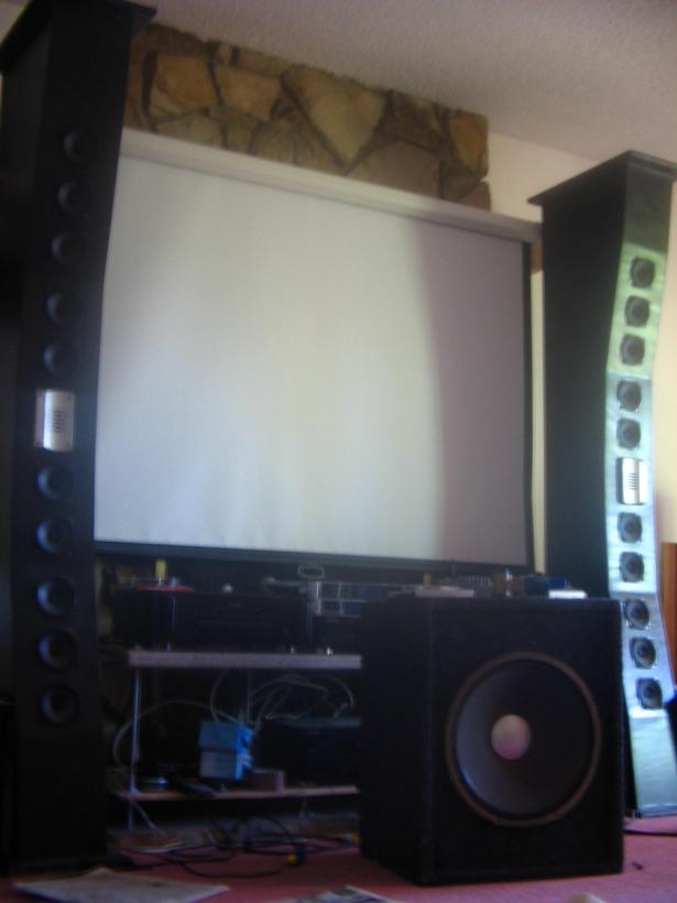

Don't mind the messy living room.
69cents wonders + Heil ribbons in concaved and tapered, ported cabs tuned @ 80hz or so.

How can Shin enjoy a nice line array when the commercial market
barely has anything worthy to be called a line array? ROFL
What about DIY line arrays? I've only seen a handful of line
arrays that qualify as line arrays, of which, they all made
a crucial sacrifice to performance.
SPL is a variable, it's called a volume knob :clown:
You are preaching to the hot rod builder why he wants
a muscle car with a 500 horse engine. LOL ...
If you want holographic sound, get some $20 headphones
and call it a day. There is no reason not to have different
types of audio systems. I have headphones, I have computer
speakers, I have the budget array, I have test boxes for the uber array, I have tons of audio experiments {not finished projects}
that gave me tons of satisfaction, I had car audio systems, etc.
Why do people think that we are limited to just one design?
Shin has experienced a quality 3 way design, let him experience
a different class of loudspeaker design. Especially when there is
potential to make a great one for a reasonable cost. 😎
I pretty sure if I made a TMW like Pv2.0, making something in the
same league would be a boring venture. There is no reason
that he can't build a horn system later in his life either. His choice. :devilr:

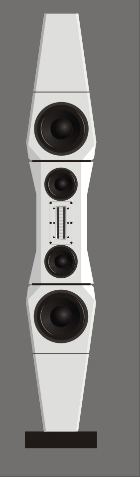

Shin, I really liked the modular line array a la Dali Megaline (the one on the right) in your most recent rendering. I would stick with something like that. Also, less drivers (for instance a 2-way line) would be much simpler and provide a much different experience than the Perceives' offer.
Nate
jleaman said:
I like this one that you did.
This looks neat but going to be complicated totally.. Lots of crossover but looks like drooling material.
I am not a fan of line array's..
I like the looks of this one too, but the low end would be limited due to driver size and box volume. Really don't know whether Shin want 140db SPL at the low end in a room though.

ShinOBIWAN said:
I've expanded on the design:
I really like how this one turned out.
