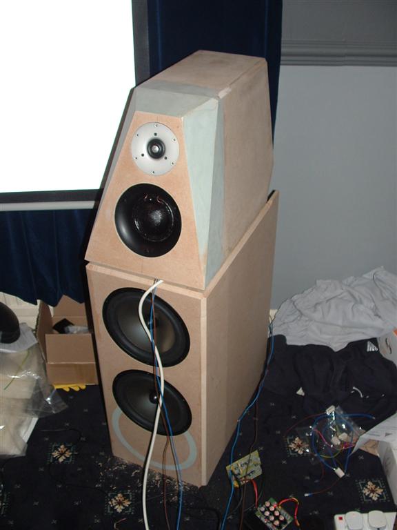

Really making some headway now, one cabinet around 80% done(not including finishing):
Also note the filler at the bottom of the bass cabinet, I wasn't paying attention and ended up cutting the driver recess at the wrong end! To top that its was also too big, clearly a case of cut once measure 5 times 😉 The automotive filler has done me proud though and rubbing you hand over it reveals a seamless plane, will look fine once its sprayed.
I'm biased of course but I think these look fantastic, better than I could have imagined. Really solid too, knocking on the side reveals negligible vibrations and resonances, the double layer of dedshete panels really did its job here.

ShinOBIWAN said:Also note the filler at the bottom of the bass cabinet, I wasn't paying attention and ended up cutting the driver recess at the wrong end!
LOL! Now it's a lucky horse-shoe. 😉
I must say I've never made THAT mistake before, but plenty came close. Just last night I almost made a woofer cut-out that was 18cm too low, simply by adding 20cm rather than 20mm in Excel. It wasn't until I got the compasses out that I thought something looked wrong!

Couldn't resist connecting everything up into the virtually complete cabinet and having a go.
I wish I hadn't, somewhat disappointing performance for the outlay. I'm very picky and not easily impressed but here's my gripes:
Bass is poor, ill-defined and slow. Integration between the mid and bass is terrible, these sound like some £1000 Mission's in this regard, just not upto the task of hi-fidelity reproduction.
I suspect the reason for the frankly rubbish bass performance is the poor mid-bass integration.
All I've done is a basic level match of the drivers, no phase correction, no baffle step and no EQ/notch filters.
On the plus side the midrange and treble performance is out of this world. I'd highly doubt you could significantly better it for less than silly money.

I'm kinda hesitant to post this here as I'll probably get laughed off the board 😱 but the reason for the poor bass integration could have been the fact that when I did the wiring on the bass drivers, I'd inadvertantly wired them both out of phase with regards to the mid and treble. 🙄 😉
Sounds much, nay, infinitely better. Now very tight, well defined and the mid/bass integration is seemless.
I now ask myself, if I can't do a simple job such as wiring the drivers in phase, how on earth did the electronics I built work first time?!? Doesn't exactly instill confidence 😀
Much reviewing and tweaking ahead methinks. I'm a little too excited to post subjectively about the sound at the moment, so I'll restrain myself and say they sound good for now.
