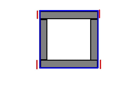

I don't know whether its just me or what but I have to be quite meticulous with the MDF to ensure that I don't get the joints poping back through after sometime. Stange thing is that I've found 25mm MDF to be better in this regard than the 18mm, go figure but I've definitely noticed a difference. Veneering lets you get away with more than spraying, especially if the finish is gloss and I think its the worst thing to have joints showing, I'd sooner have **** sound than that 😉 😀
View the pic attached.
Grey surrounded by black is MDF, blue represents veneer. Grey may be green I am colour blind and cant tell the difference unless the green is bright.
Are you meaning that where the red lines are become visible and you can see where the MDF join is? I get this and would really like to know how to get rid of it. I know its the MDF swelling a little, but I thought it was because of the glue I put on the joint when veneering and not moisture problems.
Edit post - oops no picture![]()
Yep you've captured what I mean perfectly in your picture.
You can eliminate it with judicious use of filler, building up a thin layer say 0.2-0.5mm thick but I've had some success with PVA/water mix of 60/40, doing 2 coats with sanding in between on everything including the internals. Personally I do both on things like translams, such as the front baffle, other area's I tend to design around the problem and seal with the PVA mixture; If you take a look at the 3rd or 4th pic down a couple of post above you'll see I've skinned the over the joints of the cabinet with an extra layer of 9mm MDF and then routed the edges at 45 degrees to meet flush with the MDF carcass. Looks nice and prevents this creep that you tend to get on the 'raw' edges.
I've also found that the some paints and finishes are layed down thicker and are generally of a higher quality. This also helps minimise the joints creeping.
Combine all these techniques and you'll get a cabinet that looks great for a long time, like I said though it a laborious process but well worth it for the sake of sanity, especially when your going for a piano black finish like I'm doing here.
Okedoke I shall try filling the next pair I make and see if it makes a difference. The creep that I get when veneering seems to be instant and is there as soon as the cabinet is sanded. Time (im talking a couple of months here) doesnt seem to make any difference whatsoever. Also raw MDF boxes I have made dont have any drift either so im thinking it is the glue from veneering that makes this happen. Its quite running and would soak into MDF "endgrain" well but not so much into the parts. I will try filling with glue first, letting it swell then sanding it flat. I have made a translam and veneered that with glue that is not absorbed at all and this has remained stable.
Anyway thanks for the tip.
