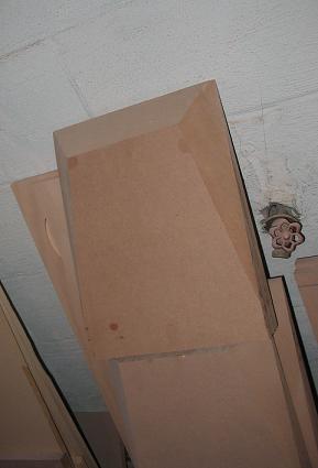

Seriously though I based my speakers on the Von Schweikert VR-4SR:
I'm not keen on the veneer so I'll probably get the cabinets into a spray shop for a real nice gloss black finish
pinkmouse said:
That's quite a steep slope on the mid-hi box. Have you checked the dispersion on the tweeter, ( I know the ATC will be fine 😉 )?
You might also have some crossover lobing issues if you are not careful...
Hi Pinkmouse,
The baffle angle from vertical is 16 degrees, so yes it is steep but that was the amount required to bring the drivers into time align.
Off-axis response on the Scan is average from my open baffle tests so far, though you wouldn't think it looking at the plots.
Hmm, what if I were to bring the top section of the sloping baffle back in to vertical just for the tweeter?
You might be ok, build a test baffle first, and then do some measuring. I just don't want you to spend all that time and effort to get something that doesn't perform to the standard you should get from the quality components you bought .
